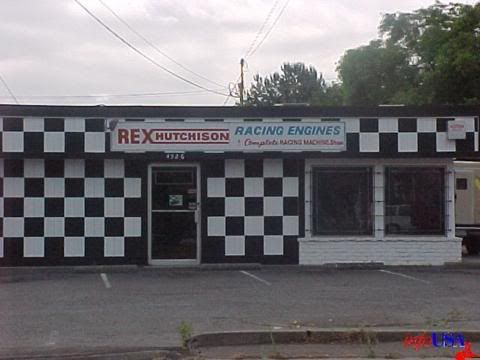

I'm sure some of you locals have heard of Rex Hutchison Racing in Sacramento, CA. They have built a solid reputation over the years, firmly rooted in local level and national level racing. We have known the owner personally for 14 years, and treats us like we buy an engine every month. I still remember him from back in 1995 (I was 12), when my dad had a 454 built for our Eliminator. The shop tour they gave us was incredible, and probably the first time I understood the addiction to horsepower.
However, when it came to building my engine, I started out a bit skeptical of my dad's recommendation to call Rex. I didn't like the idea of an engine build by a shop that I considered "old school." Aluminum heads, solid roller cam, high revs, pro touring...I didn't see my ideas meshing well with a shop that's been around since the stone ages. Long story short, my misconceptions were smushed when I spoke with Dan, who is arranging the details of my build as we speak. Not to mention Rex, who makes you feel like his grandkid within about 10 minutes. We got a shop tour again...the fully-ported LSX 454 with a sheetmetal intake quelled any fears I had about the shop stuck in the stone ages.

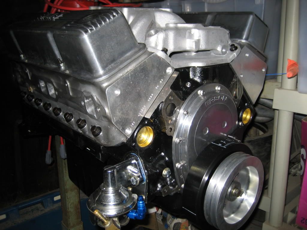

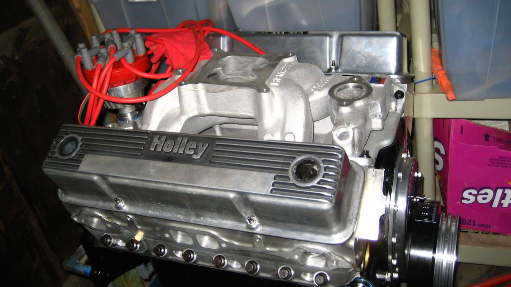

Today was the big day, when I picked up my newly built engine from Rex Hutchison.
Final Specs:
355ci, 9.8:1 compression, balanced & blueprinted
200cc Pro Topline Aluminum heads, performance valve job, bowl blend, polished chambers
Comp cams solid roller, XR274R 236int 242exh 0.564"int 0.570"exh
Edelbrock 7501 air gap intake, port matched
1 3/4" Dougs headers
To be purchased this month:
Custom built Pro Systems carb
The engine should be a beast, and will produce way more power than I am comfortable with. I'm sure this thing will scare me for a long time. I will install it once I piece together my transmission parts, so I can slide everything in at once. Probably mid April.

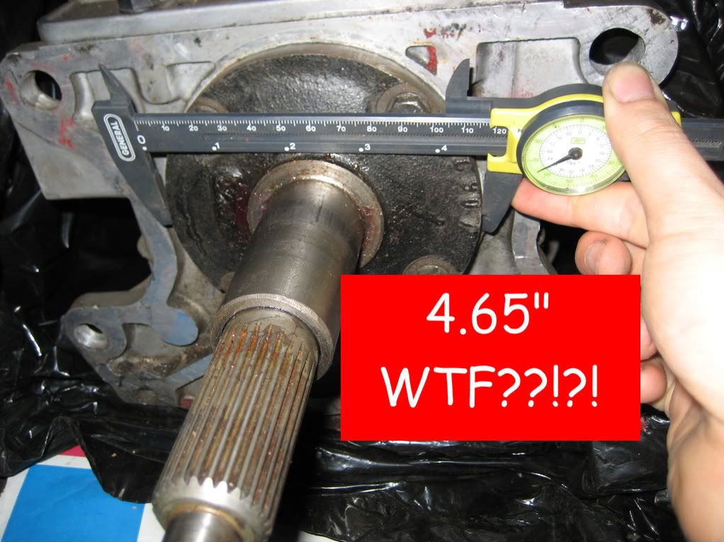

Speaking of transmissions, here's what I discovered today when I was taking measurements of my craigslist-purchased TKO:
It's supposed to be 4.85". When he sold it to me, the jackass failed to mention that he lathed 0.2" from the diameter to accomodate his bellhousing. Thus, I need to replace that piece, so I am trying to source it now. I hate liars...and I hate that I got worked.
