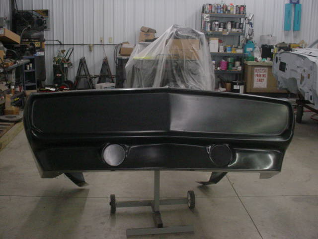

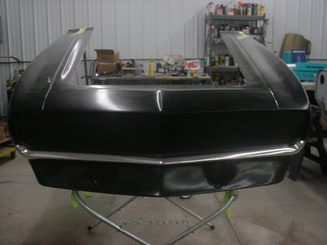

I have had a few inquieries on the chrome we are doing. Its up and running now. Here is a couple pics on a 69 camaro Ft bumper we just chromed, its a fiberglass front clip for a Top Sportsman Camaro. Possibilities are endless. I can also tint the chrome so it can do a candy color or anything. This is plating, not paint.
