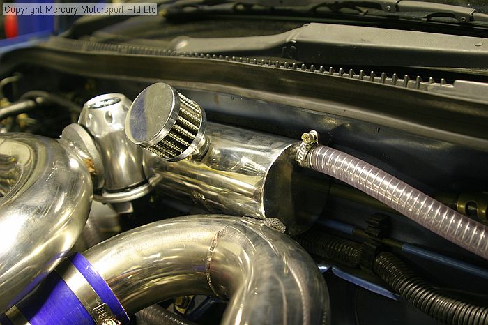

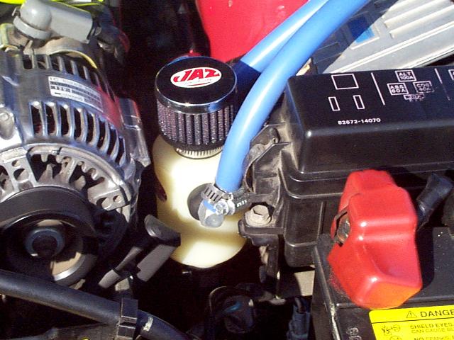

They're plumbed to a remote resovoir and I like that clean look, too. It's something that I'll probably be doing as well.

Thanks Scott! Got any pics of a resovoir of this type installed??

Tony, it's basically just a catch can with a breather added.
