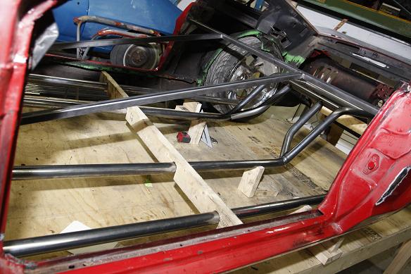

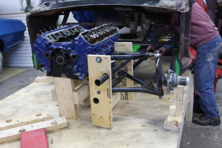

So today was a good day. Im a little bit ahead of schedule on 2 other cars so I thought that Jim ( My right hand man) and I would make the table to start mocking up the car and continue gutting it. I build the cosmetic tables out of wood and then transfer any fab over to a chassis plate. Here are some pics of where we ended up today. Enjoy!!! Tommorrow is going to be measurement day. We have a chassis blueprint pretty much done geometry wise so now we mark the tables accordingly and transfer the drawing into fixtures

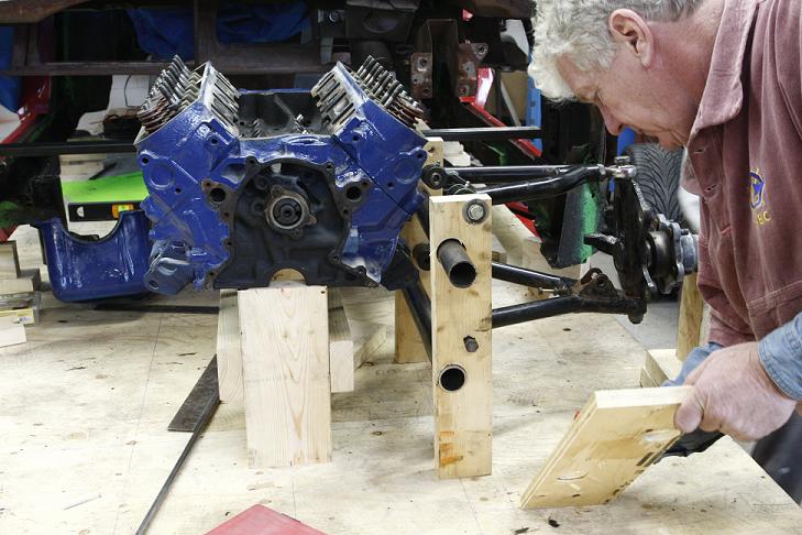

So we had a really busy week at the shop and really didnt work to much on the car, but come friday morning we were all pumped to jam on it this weekend. I think we all did pretty good, finished building the fixture for the chassis ( mock up only) as well as got the motor mocked up, main rails bent, rocker rails bent, back section mocked up for the independent rear, the front rails mocked up for the front a arms as well as the rack. All in all damn good weekend. The 2 rocker bars were kind of hard because of the staggered bends at the firewall it seemed like it would never end. This weekend I want to thank some of my best friends who could have taken advantage of the last warm day for testing their drag cars but stayed back knowing how important it was for us to get this handled. Polish Mike, Mikey grillo, Inder from Tag Racecraft, Stu Lawson from Modified Mag, Fatty from Bent Metal and my partner Jim Slack but important my MOMMY for several trips to and from the shop with coffees, lunch and dinner lol lol. Also spoke with Jason Rushforth about the wheel delema we have and the decision has been that we are diffently sticking with the pin drives and he can custom cut the wheels for us. The next step on that is finish mocking up the front end, and then we will be sending the front and rear hubs to him to get the ball rolling. He advised us to run 19 fronts and 20 rears so well see I really had my heart stuck on 20x15 with a nasty 10" lip in the rear but he knows best and his advise is crucial to this whole pin drive setup so well see what happens in the next few days
So where's the chassis plate? How accurate do you plan to get using wood jigs for holding stuff?

Actually this is the only way to build a chassis like this efficiently price wise and time wise. With this chassis in particular, there is a lot going on. To machine all the different one off spacers and tube holders it would cost thousands of dollars. Being that it has to be fully functional and a show peice we will be changing on the fly with certain components possibly being re located ( to hide). A good example of that was over the weekend I noticed the master cylinder would be to close to exhaust pipe under the driver floor. If that was a machined chunk of aluminum or steel I just blew the machinists time as well as 50 bucks. Totally not worth it. First you build all your bars as they need to be and then when all your components are mounted functional and spaced correctly you machine your fixtures one time only and there dead on. As for the chassis table. I have a tube car on there now as we speak getting its chassis welded. The problem is that if they were generic square tube cars a fixture costs very little and can be reused car after car. But round tube stuff is always different ( motor trans suspension etc etc) Drag cars use 1 5/8 but streets rods use 1 3/4 see what im saying? I wouldnt even consider building all these fixtures because we are not a chassis shop, we couldnt justify it. We build one chassis every 10 turn key builds if that. Skinny kid for an example have a ton of fixturing, because they have cars on tables 24/7 they can justify and can use the machined fixtures reqularly. Not to justify anything here but even if one wanted to weld something on that wooden table with a tig welder and someone who knows how to use it you could do it if you clamped the main rails properly. I personally wouldnt try it because I dont need to but i would bet 10-1 that an experienced welder wouldnt warp those bars if they were fit properly.
