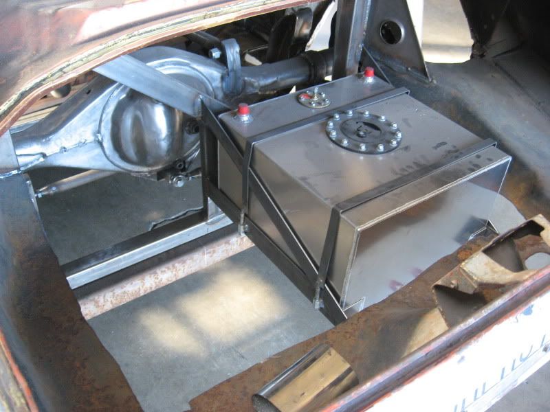

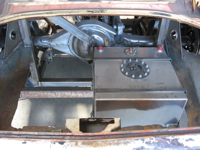

These are photo of the installed fuel cell. We cut out part of the rusted out floor. A new floor section will be installed later.
