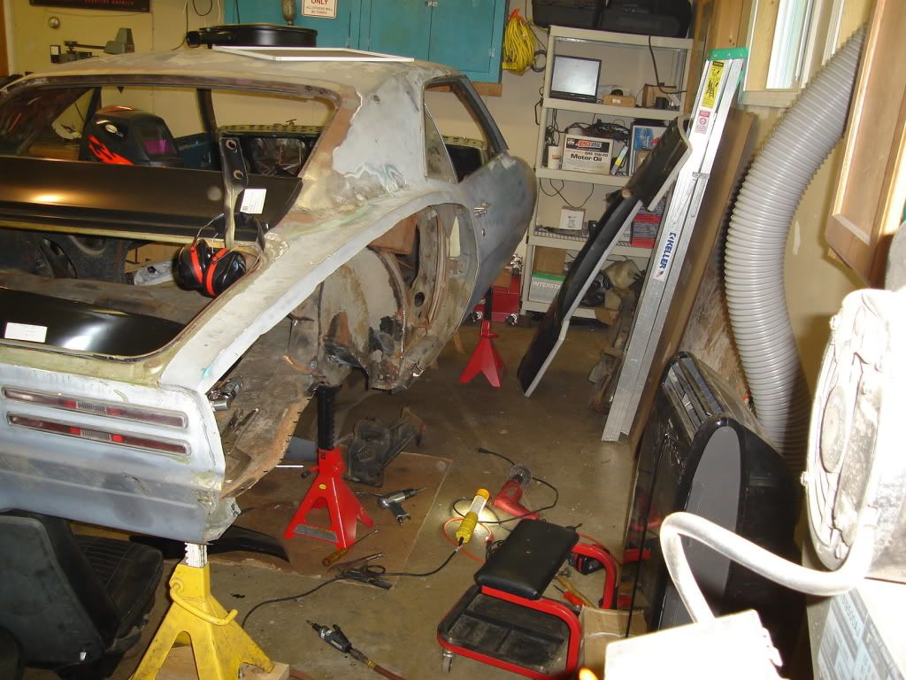

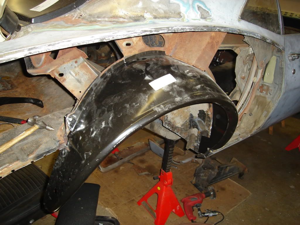

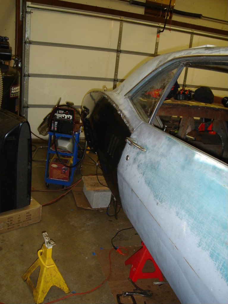

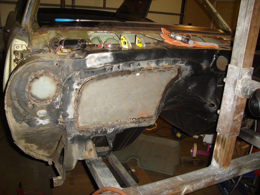

That wasn't so bad lets do the other side.
Tacked in place.

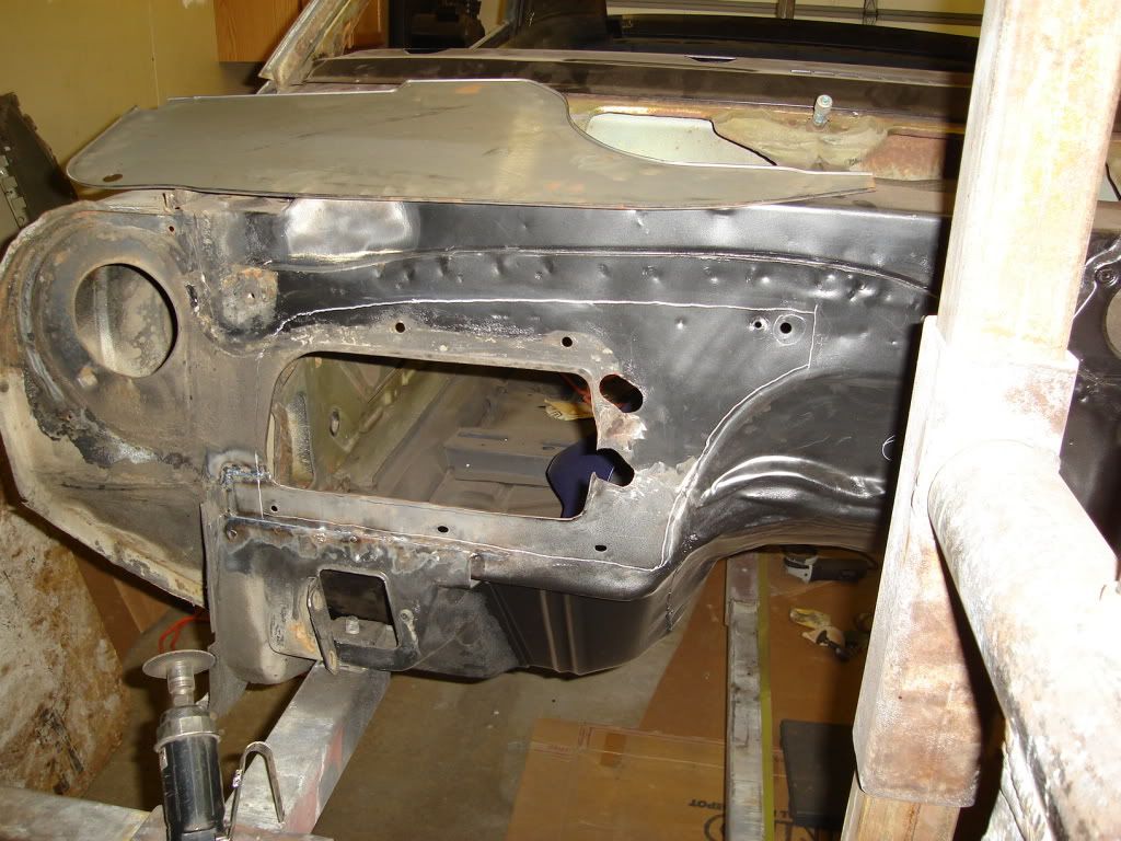

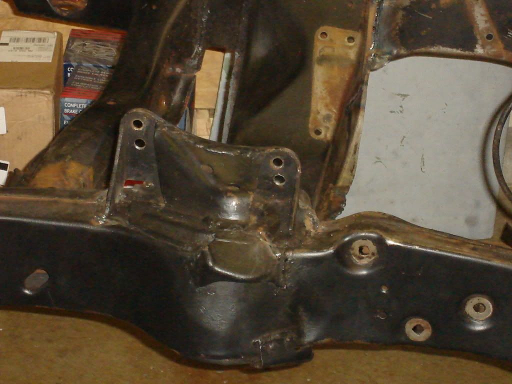

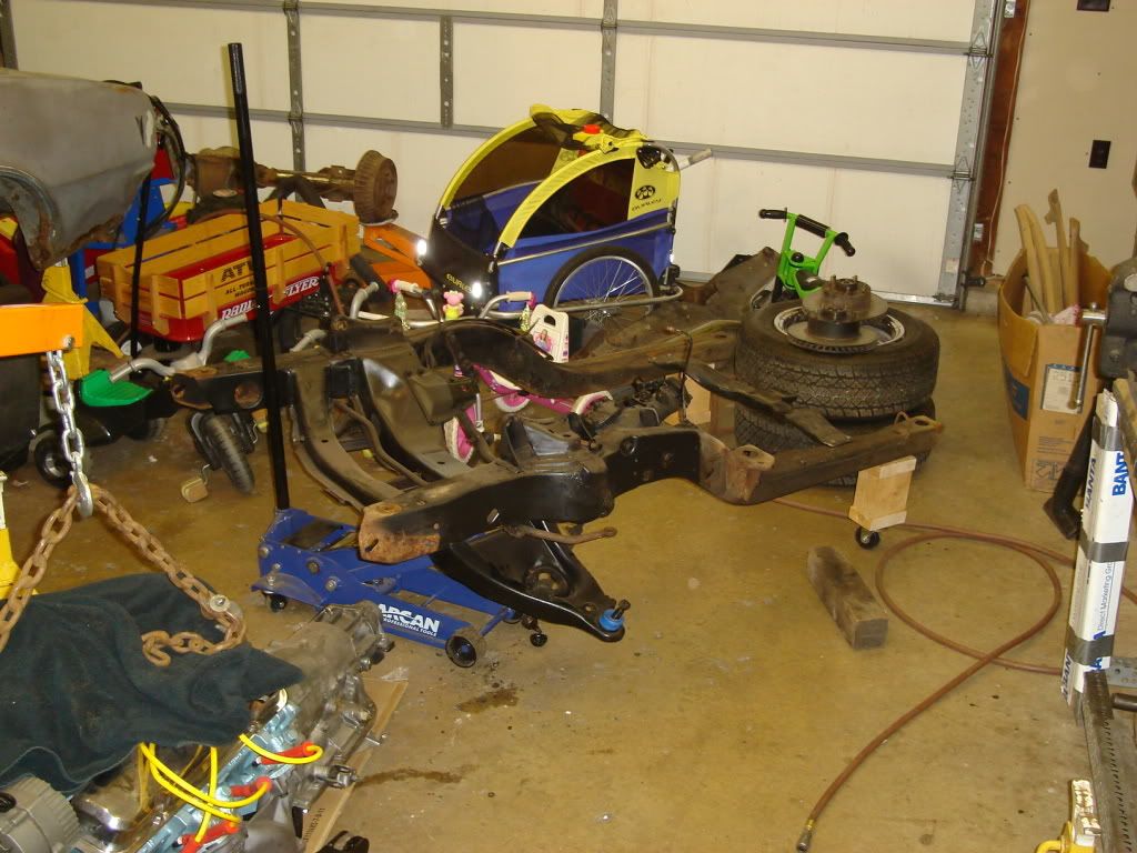

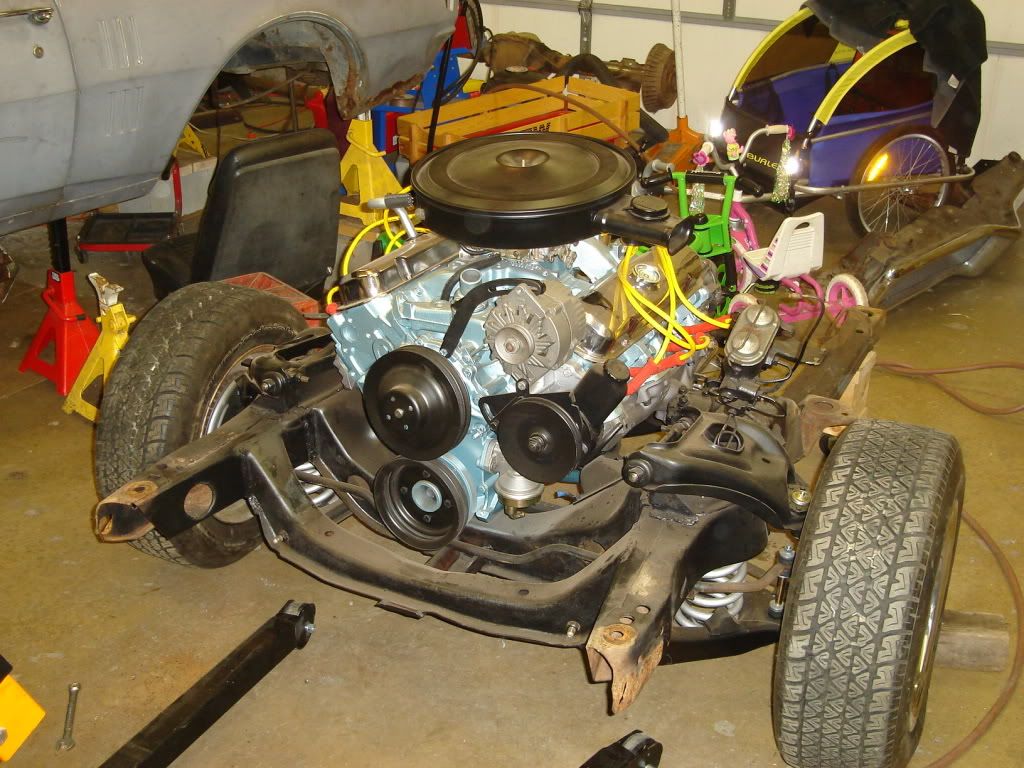

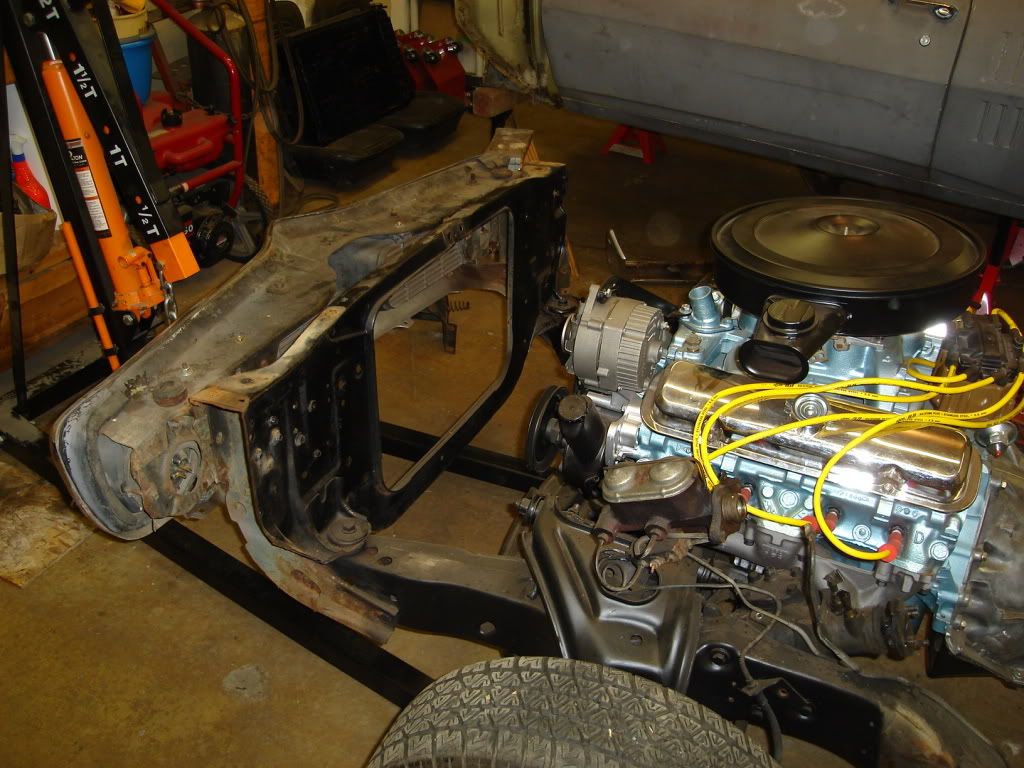

I had a good friend who offered to sandblast my subframe for me. I wasn't about to turn that down so I started stripping the frame down.
Almost there.
Bare frame, I drilled out the G-Mod and welded the entire frame up solid top and bottom.

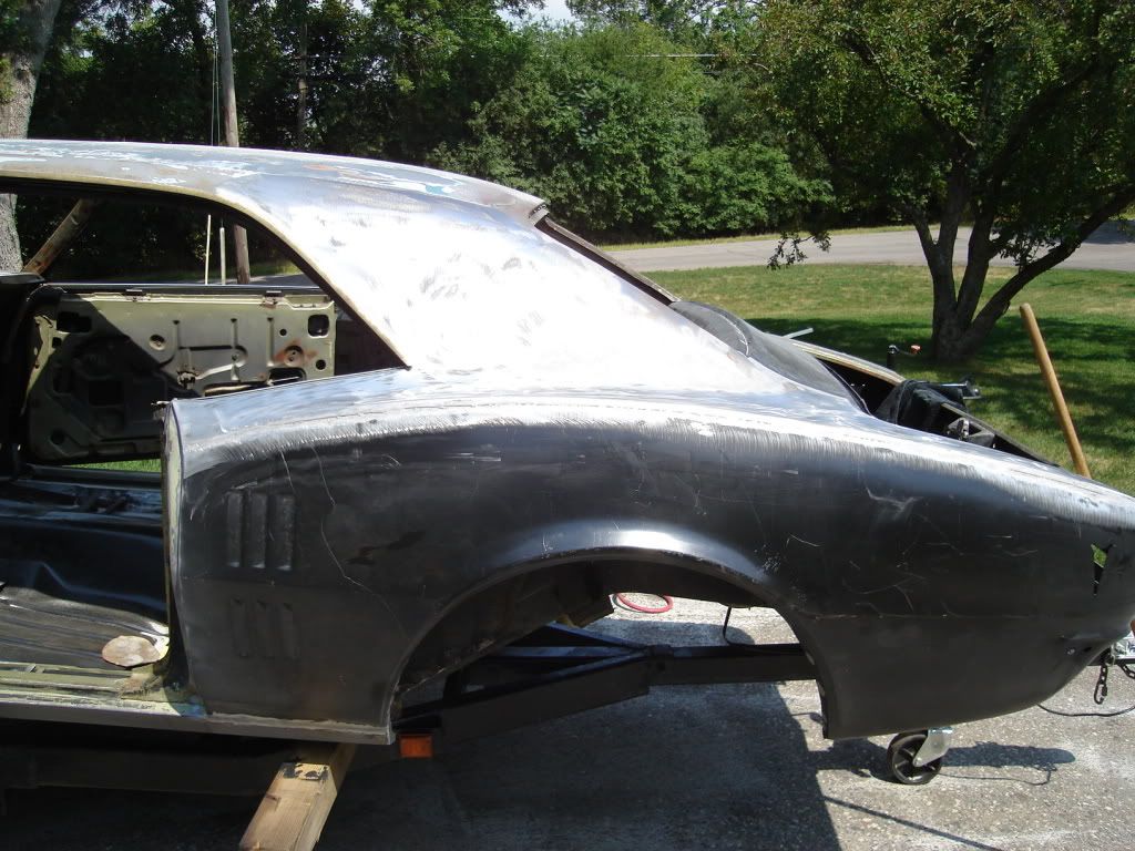

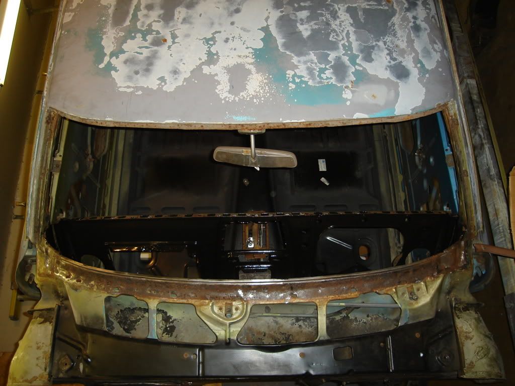

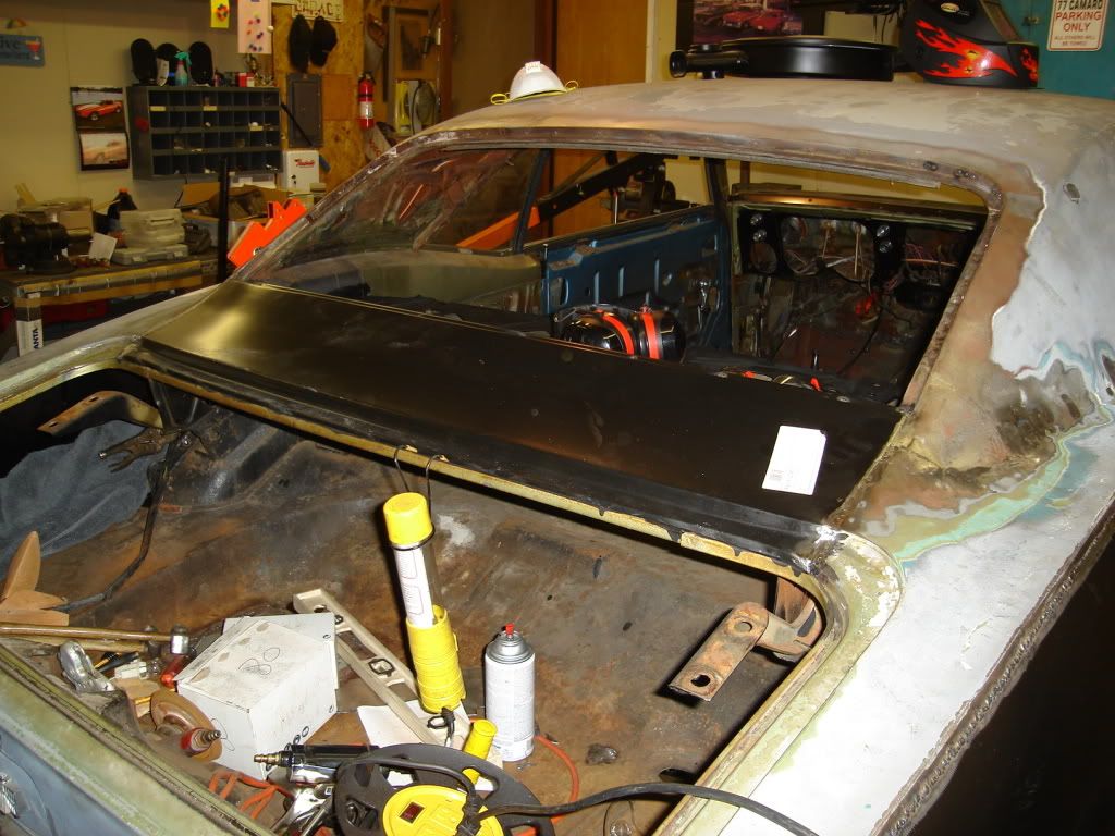

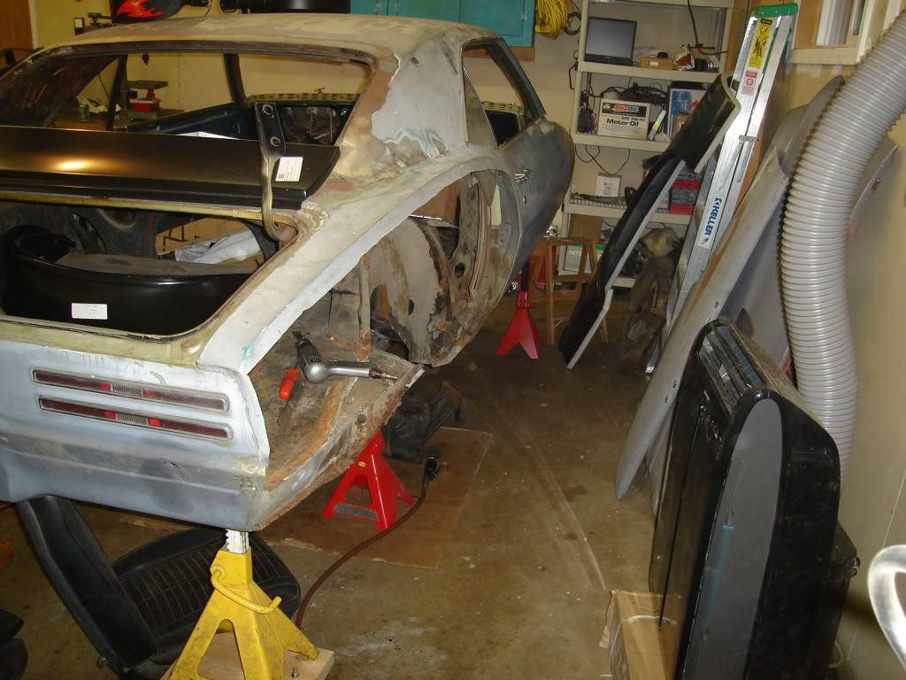

Again, cutting more metal off of the car. The car started life with a vinyle top which was not so nice to the tulip panel and window channels.
New panel.

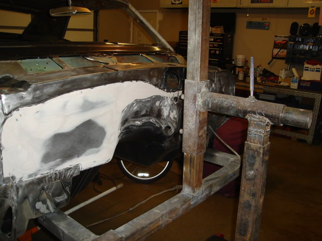

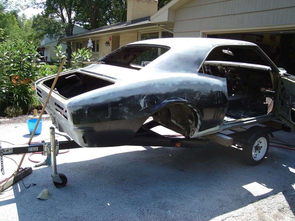

I rolled the car outside for the first time in over a year. Time to rough in some body work and shoot some primer.
Back in the garage after a days worth of sandblasting,bodywork, and primer.

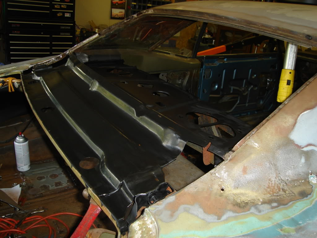

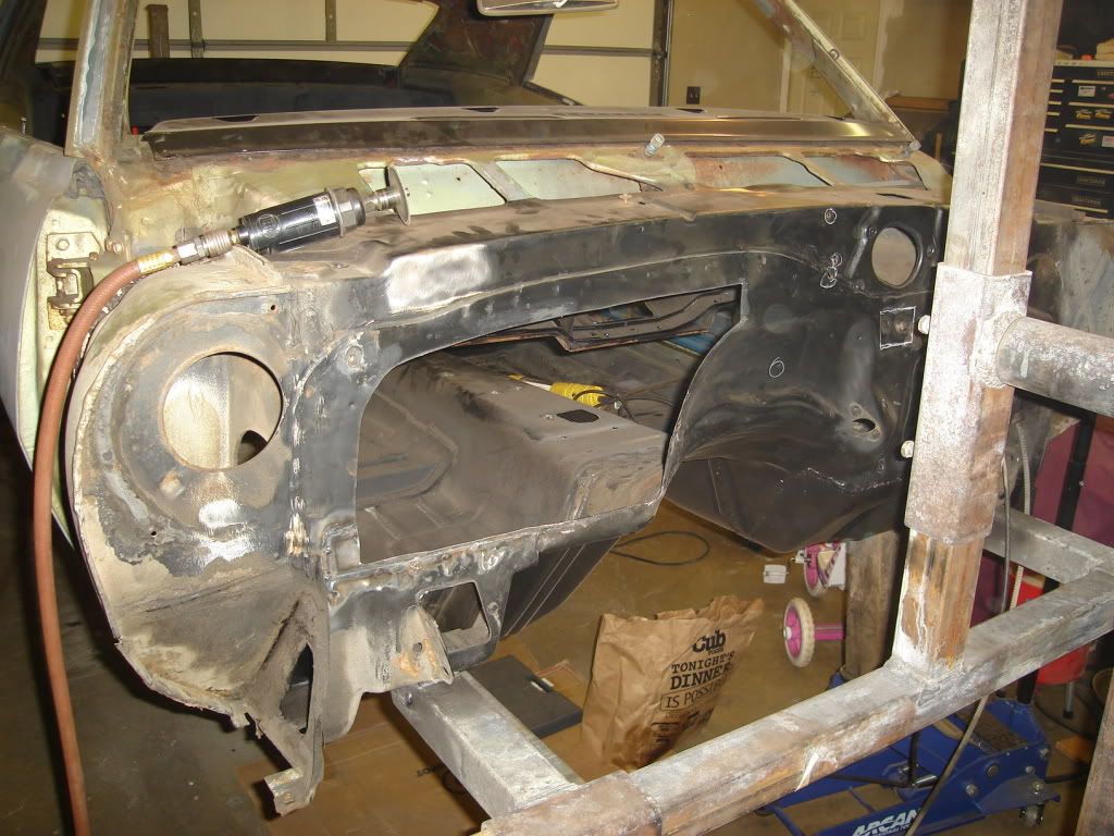

The dash looked to be in great condition untill I took the window out. Right under the ribbon seal was more rust
All cleaned up and welded in.

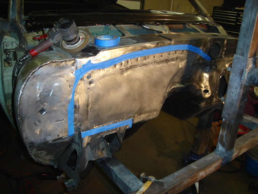

I decided that I wanted air in this car so the custom made firewall panel had to be cut out.
Cutting holes once again
All welded up.
A little more grinding.

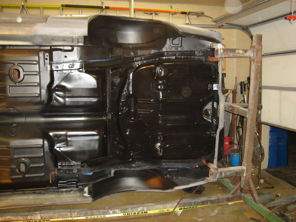

  #27
Old 01-19-2010, 11:17 AM
68400BIRD 68400BIRD is offline
Join Date: Jan 2010
Location: MN
Posts: 187

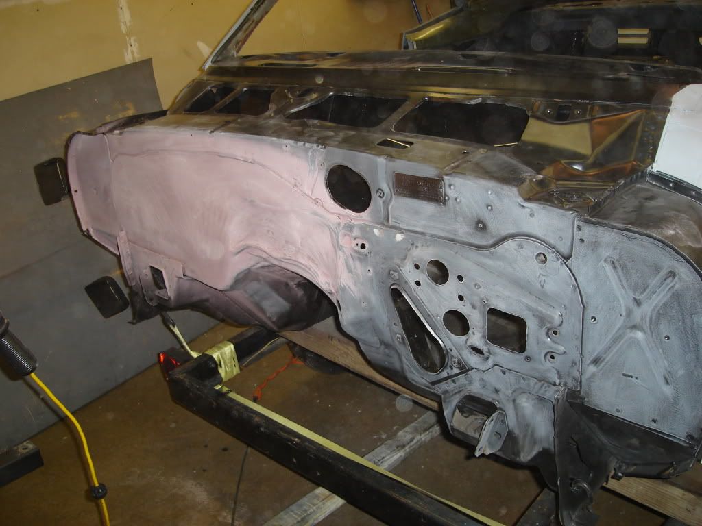

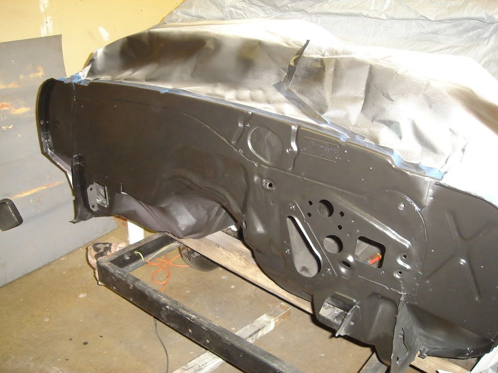

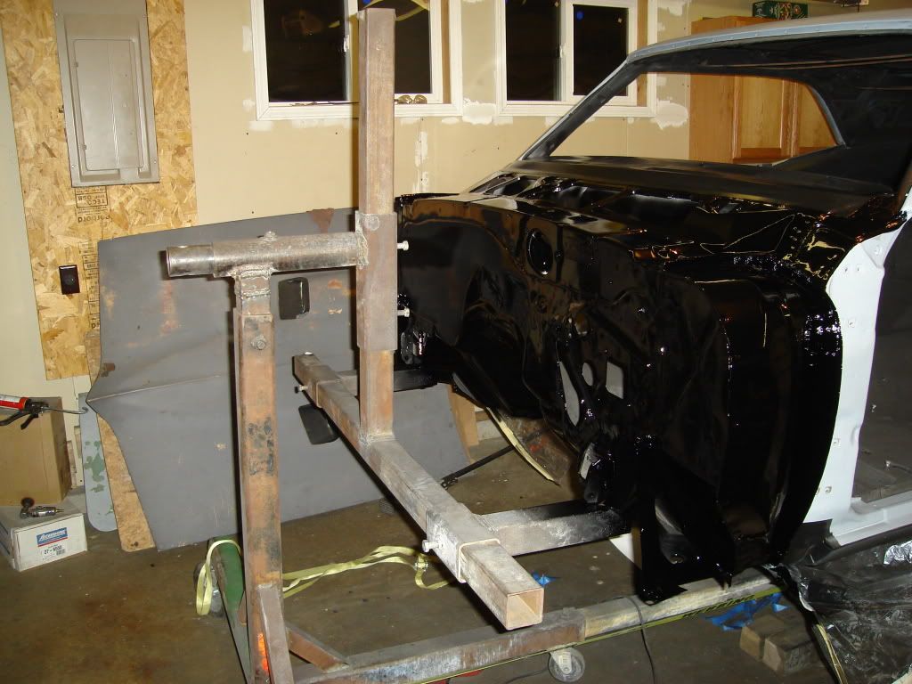

Body work on the smoothed firewall.
A little DP90 primer sealer.
Scuffed down and some high build primer.
Painted in DCC PPG gloss black.

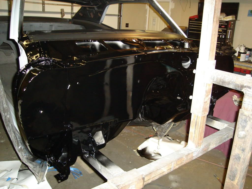

  #28
Old 01-19-2010, 11:21 AM
Join Date: Jan 2010
Location: MN
Posts: 187

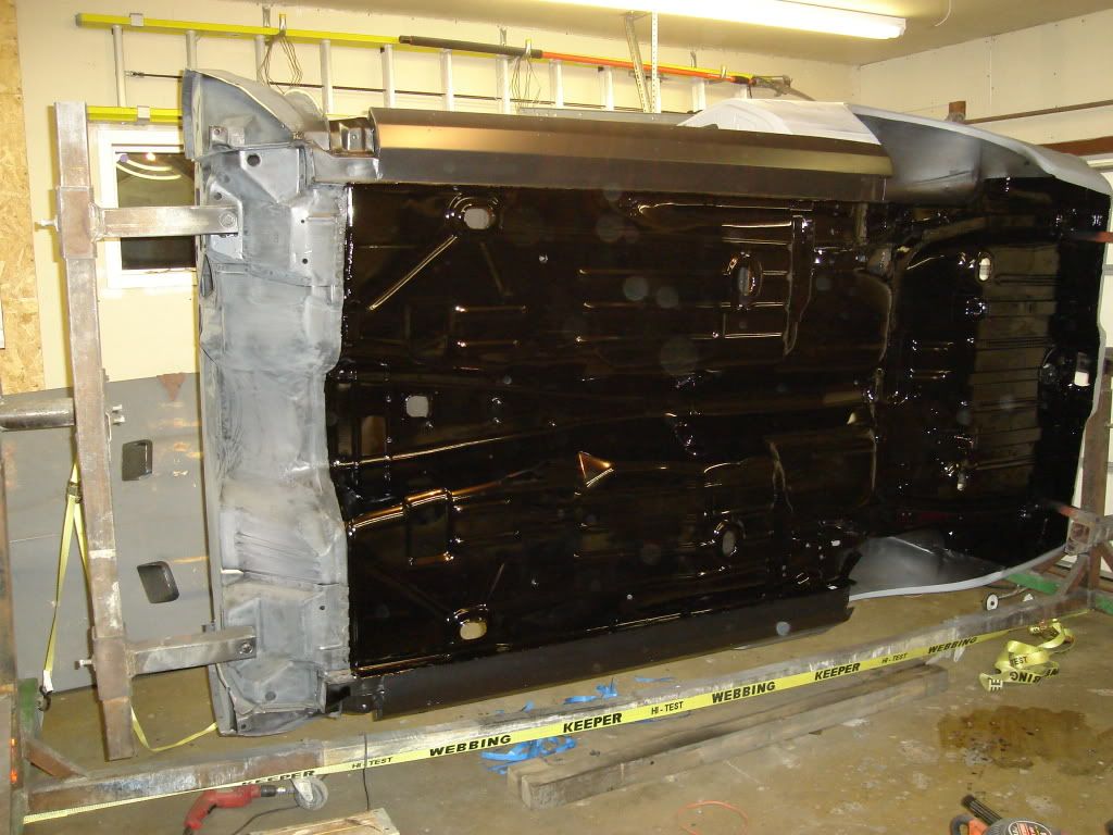

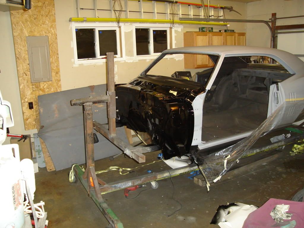

The car is now on the bird spinner. Time to paint the floor.
I did not get a chance to get paint sprayed on the floor so I had to scuff it all down again and respray primer. Went out the following day and shot the bottom of the car in gloss black.

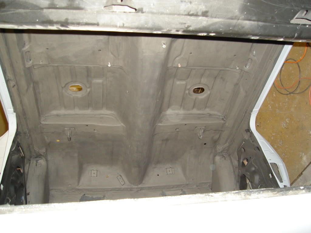

This is pretty much where the car is at right now. The whole shell is in primer and has the body work close to just needing high build primer to finish.
I have secondskin sound deadner on the floor and roof.

How did you apply the second skin stuff; shutz gun? How do you like it? I was planning on epoxy priming my Firebird and going over that with Dynamat Xtreme. Would I be better off with this stuff?
Thanks
