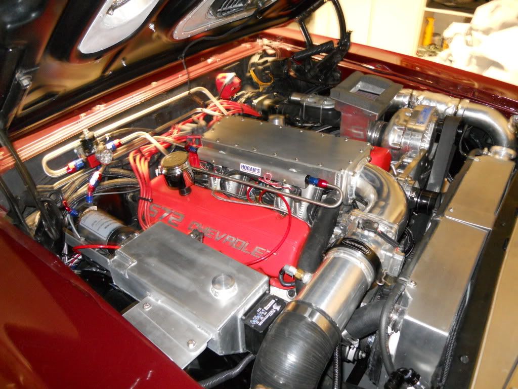

I started doing some research on adding a water/methanol injection system to my supercharged 572.
I will give you a brief overview.
After looking at all the systems that were available on the market, I narrowed it down to AEM and Snow Performance. After numerous emails back and forth with their tech support/sales people, I felt that the Snow Performance system had more to offer and I felt a little more comfortable with what I was buying from Snow. I will say that initially AEM was quick to respond to my email and answered all of my questions and I had to send a few email to Snow to get them to respond. I almost gave up when I finally got an email back. After receiving that first email, they were responsive to all of my questions.

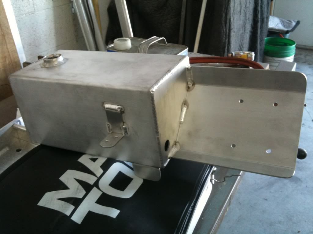

I did not want to use a stock ugly plastic bottle for my methanol tank. While AEM seemed sort of clueless when talking to me about using a different bottle/tank, Snow walked me through the issues I might see. Because methanol eventually turns aluminum chalky, I decided to use “Kreem” tank liner on the new aluminum tank I fabricated for this setup. Kreem tank liner is primarily made for lining motorcycle tanks, but will work on any tank that gas, diesel, alcohol or methanol is stored in. Since my tank is also at the same level as my intake manifold, I needed to use a solenoid so that water/methanol would not be sucked in to my intake, when vacuum is present. AEM did not offer a solenoid option.
My engine has a sheet metal intake. When I had it built, I had 4 - 1/8” NPT nipples added on the underside of the manifold for future use. I guess this new system counts as future use and decided to plumb a dual nozzle setup into the underside of my intake. I used 2 – 375ML Nozzles. Snow was very helpful in assisting me to determine the proper nozzle sizing.

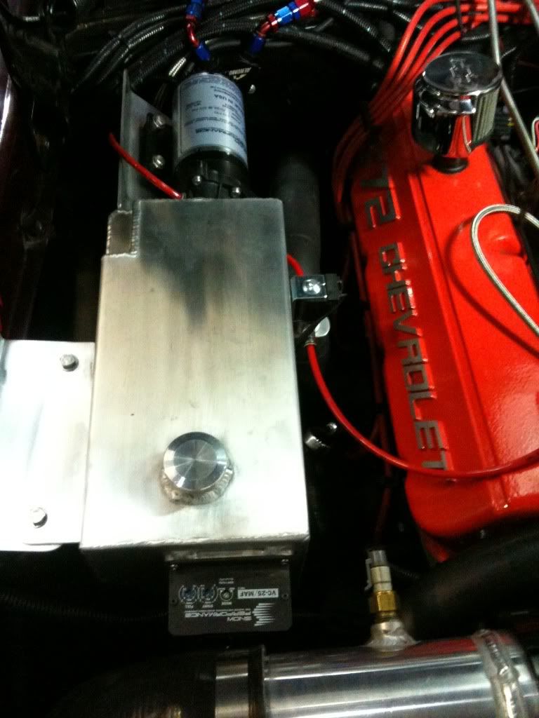

The custom tank I made has a bracket for the pump and separate bracket for the solenoid and controller.
Before this water/methanol injection system, the car made 1015HP. I plan to get it back on the dyno for some additional tuning and will post the results I see from adding this kit within a week or so.

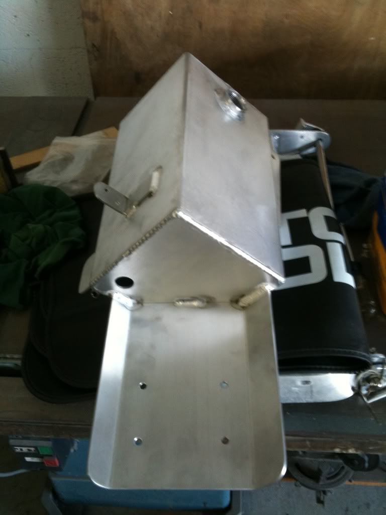

Setting up and measuring for the tank and bracket
Here is the tank with the pump and solenoid brackets.
This shows another picture of the tank with a whole for the low water/metanol sensor.

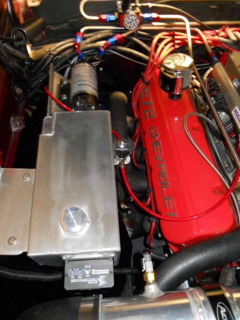

Here is a picture of the entire tank, pump and solenoid unit installed. You can see the controller mounted on a bracket on the front of the tank.

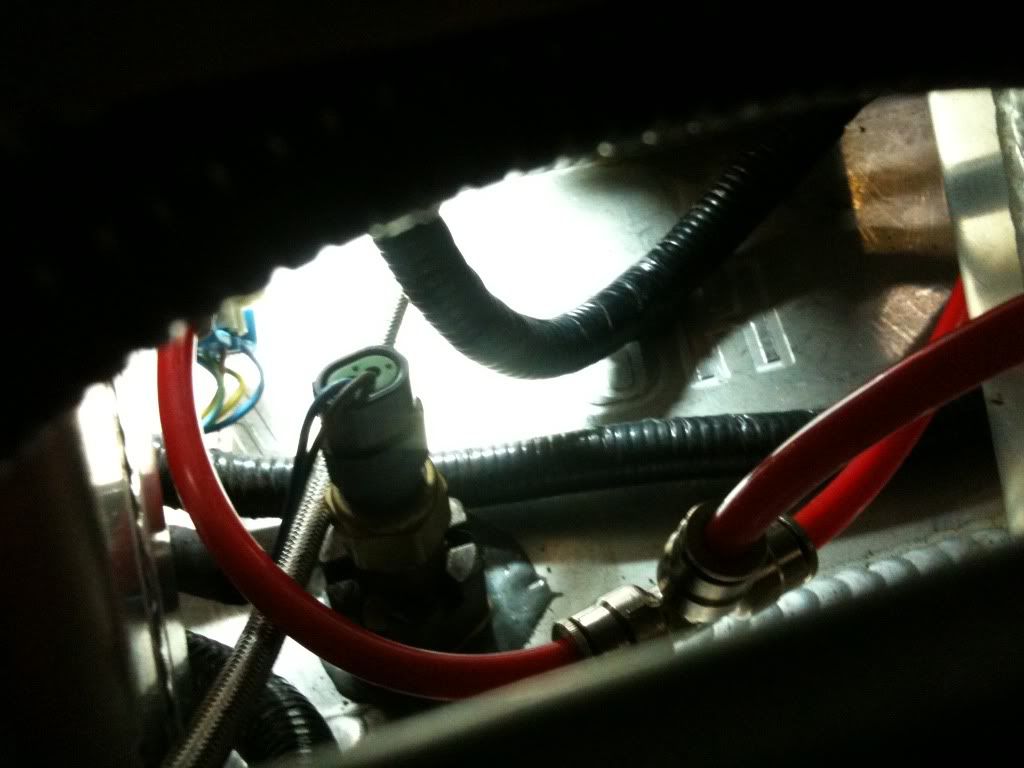

Here you can see the connector for the dual nozzle setup underneath the manifold.

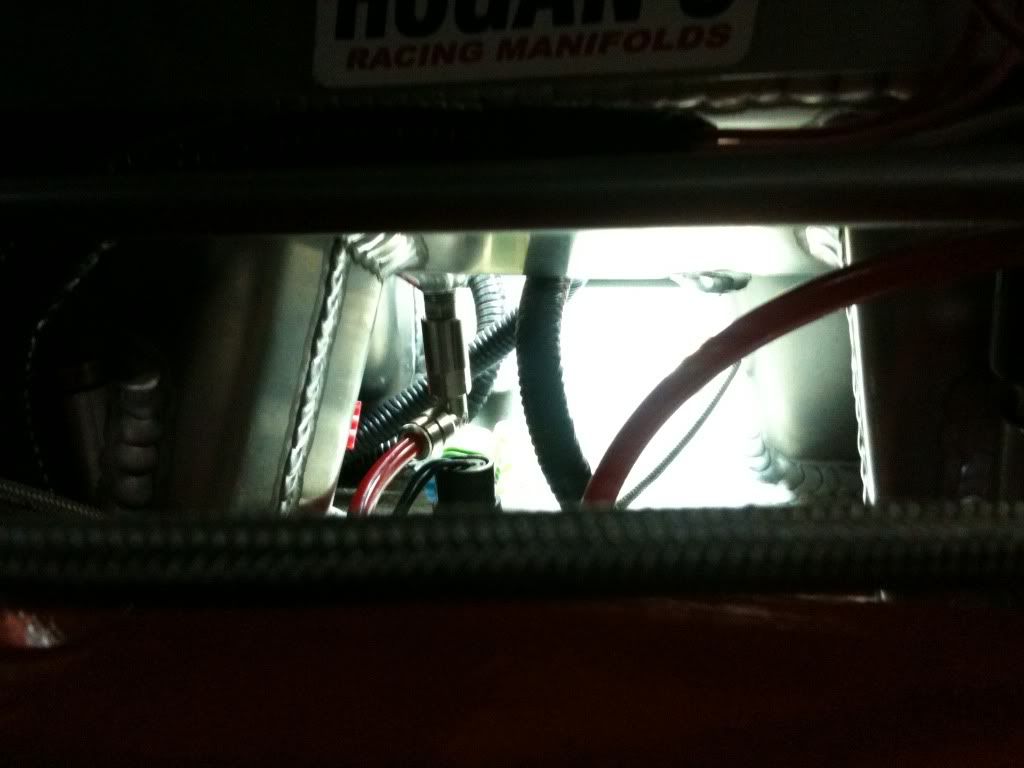

Here you can see 1 of the 2 nozzles going into the underneath of the intake manifold.

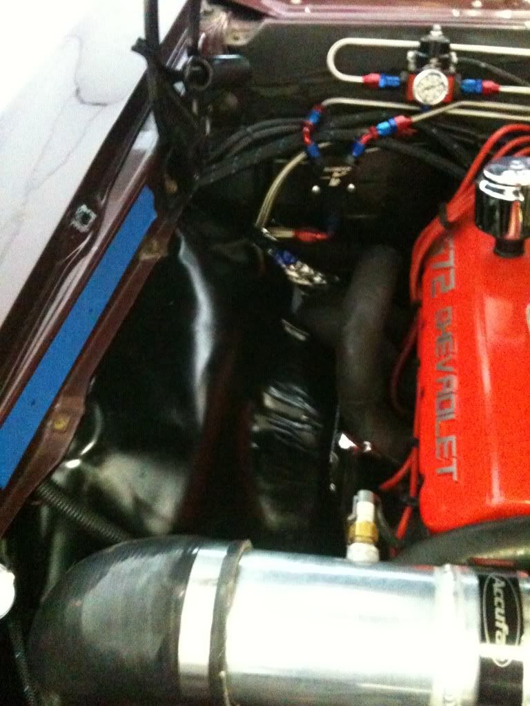

Here is another picture of the tank, unit installed.

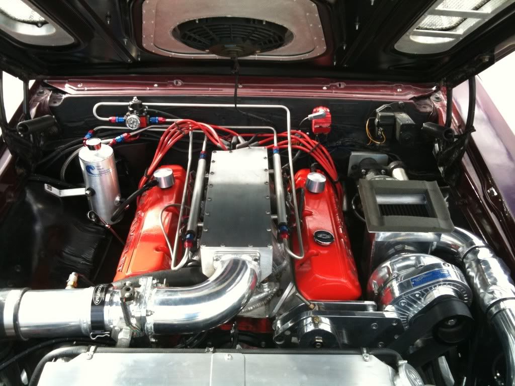

Here is a picture of the entire setup in the car.
