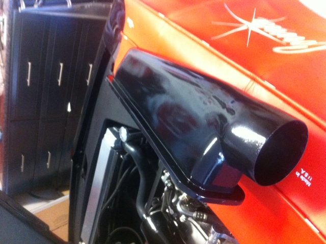

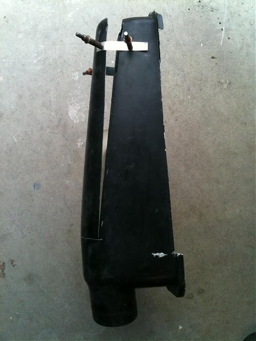

I did here you go: (sorry three year late reply...my kids- 3 and 5 and work took over priorities for a while, I'm back working/playing with FuEL)
I cut the existing boxes up and rebuild them bigger and way stronger the 3" has gone to 4" on both sides and 2" fatter through out every where else. Now to just make some 4" tubes running to air filters in similar location as the old air filter intakes...
Slowly tweaking other things as well.
