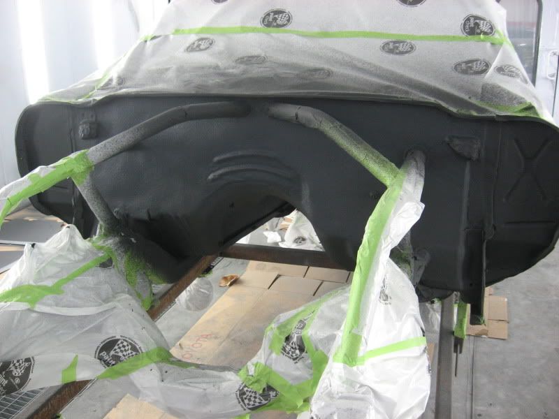

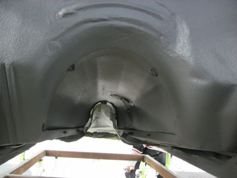

The Lizard Skin is turning out just as planned. My goal is to insulate the interior as much as possible from heat and sound.

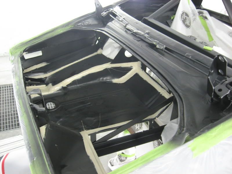

We seam sealed the trunk floor before the bed liner is applied on Friday.
