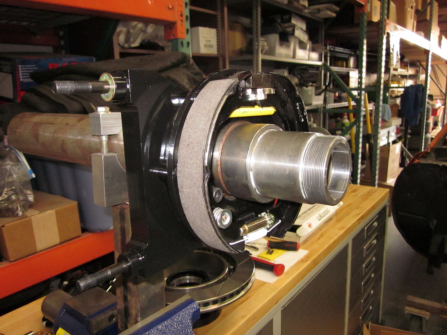

We used as many off the shelf items from Wilwood... The calipers are Billet SL & the rotor is 1.10 thk..
With all the components I used ... You can go up to a W4A caliper & 14.25 rotor.. The final set up on my car will be .810 thk with 12.88 diameter... 1.12 or 1.25 on the bore size... Don't want all the rotational weight..
The hat is an off shelf item that has no bolt circle machined to it.. We took care of that & machined the flange to weld on the axle tube.. Cost on the hat ?? @ this time..
This whole set up is sitting on 1 degree of negitive camber!!

Are you using the Billet Super lights narrow calipers that take the 1.1 rotor?
I am almost afraid to ask how much to duplicate the hat....but I will?
