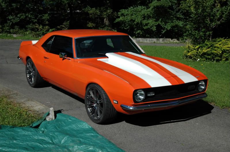

This is the final update on the Targa Camaro Project, since it no longer is a project.
The bad news is that I am sitting here at home, instead of competing in the 2010 Targa Newfoundland. The lack of seat time and development work to dial in the car properly were the main factor. We could not put all that time and effort and money into getting there and not be at the top of our game.
The GREAT news is that the car is on the road and driving great right out of the box.
This picture is now my desktop background. The reason for the weird wheels is that we have been experimenting with low cost wheels to get the sizes exactly right.

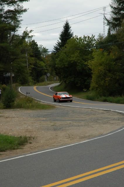

On Sunday, after putting about 70 kms on it (going to the alignment shop, calibrate the speedo, bed the brakes) I drove up to Mt. Tremblant, in the hills north of Montreal, using all the backroads. Some of them unpaved ! I got to test out the hand brake, sliding around some tight turns. I was thinking to myself that all I needed was a flag on the roof!
We broke off from the main pack and went on some pretty wild roads. I was keeping up pretty well with both a modded EVO X, a modded Sti and a VW VR6. The turbo cars are cooling off after a pretty wild stint. These roads are so twisty, that even at the speed limit it can be quite entertaning.
As far as driving impressions go, I am literally blown away by the handling and braking of this car. I have not really pushed it anywhere NEAR it's limits and I am already past my abilities. Hopefully, I will have a track session before winter sets in, and get an opinion from a "real" driver ( i.e. someone with more experience with a track car).
As far as negatives aspects go, there are a few. I would not duplicate this car for anywhere near a daily driver. It is noisy, since there are no rubber bushings anywhere in the suspension, the fuel pump is loud, and I don't have much room for mufflers. The turning circle SUCKS ! I can't even get it around my circular driveway without backing up three times !
The ride is very good so far. With just the initial adjustment of 3/4 soft, the car is a gem on the road. We have perhaps the (in general) worst roads in all of North America. The Penske shocks are soaking it up beautifully, while keeping me planted in very demanding conditions. I put 175 lb springs in the back and it seem good, at least initially. The Hotchkis front bar seems to be doing it's job so far.
The rear suspension is working beautifully. Needless to say, it is the best solid axle car I have ever driven over expansion joints in corners. I have enough expertise with those that I don't need anyone else to tell me. Since this was a prototype suspension from Lateral Dynamics, I did expect some problems above and beyond the ususal "yah it's BOLT ON" ones. We did find that the differential cover was too close to the Watts link, a situation we were warned about by LD. We were forced to shorten the upper link a bit to enable proper pinion angle adjustment. We used up all the adjustment just to move the differential forward.
The alignment guy was amazed at how straight the back end was, especially after I told him how far we had come from an empty shell. That was a BIG moment of relief, finding out that after all that, it turned out square !
