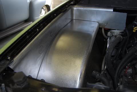

Our friends at Magna Charger gave us an offer we couldn't refuse...and over 500 h.p. with all wheel drive sounds like a blast!
Since there aren't really going to be any body modifications to the outside of the car (with the exception of a couple things that will most likely go un-noticed), we decided to focus a lot of effort under the hood to really give people something to look at. Started by making up some inner fenders:
Everything is made to bolt on so should anything ever happen it will make it easier to work on and/or replace things.

very nice work
