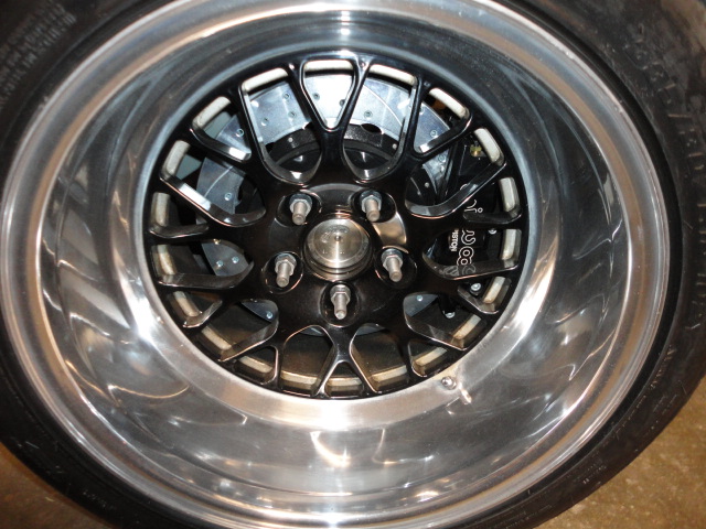

Looking good Frank, I really like the wheels. Got any better shots of them up close?
I agree. Killer deep dish on those bad boys.

ill get some close ups today and post them, toobad this wheels are not going to work for me . I bought them on ebay rear will work but fronts have a 7.750" offsett and fikse or thatcher are not able to help, these apparantely are the old style and they dont make lips or barrels. so I'm stuck with them
I guess I can use them until im done with build

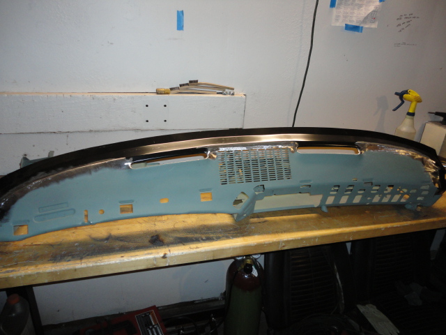

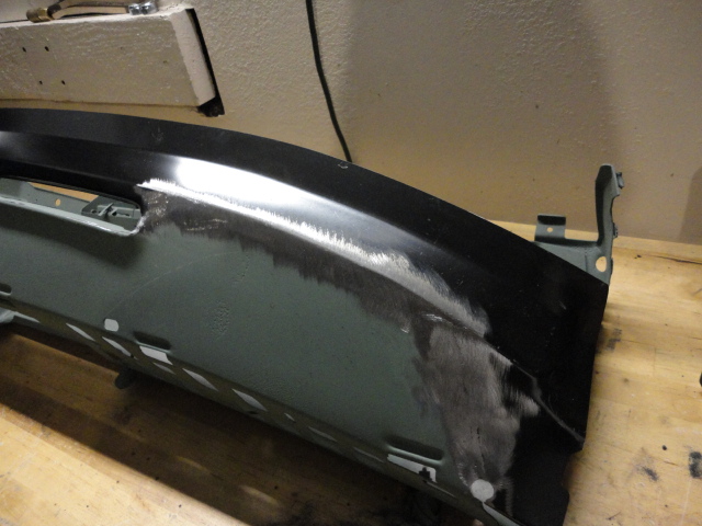

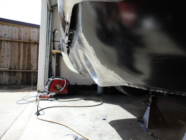

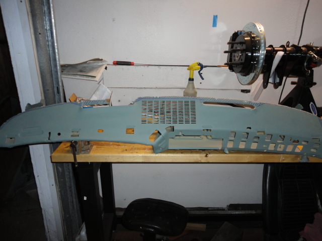

some pictures of used fm10s and repaired dash

new addition to the project, sold ctsv t56 and bought this on craigslist brand new

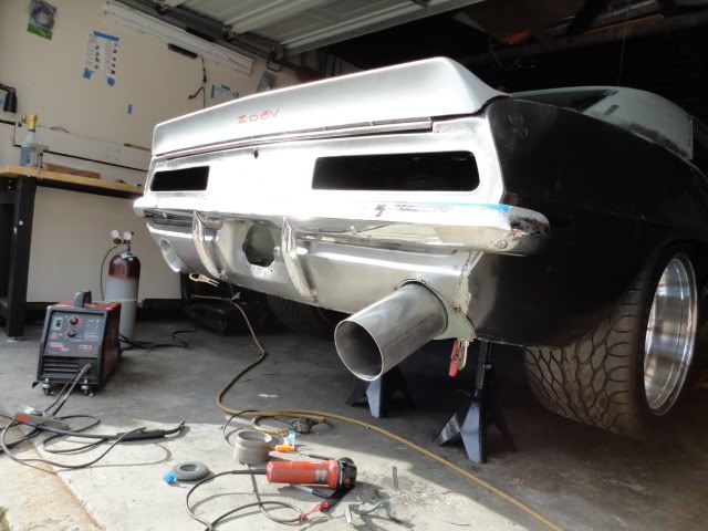

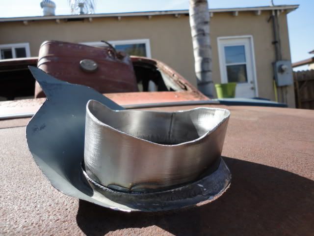

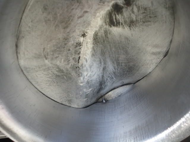

Default 5" diesel truck exhaust

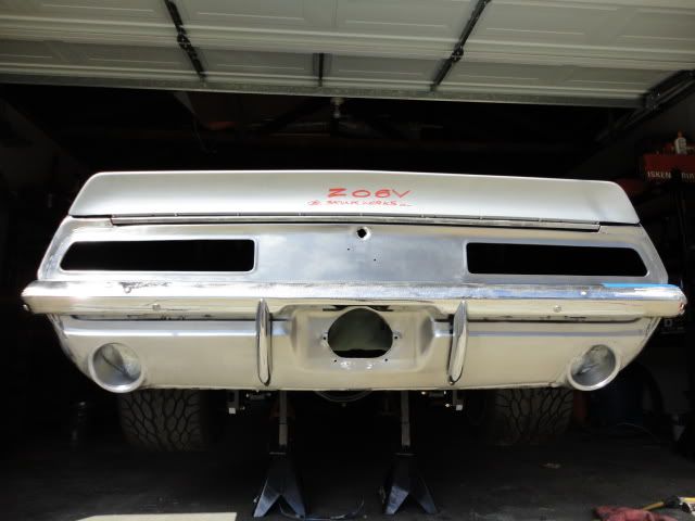

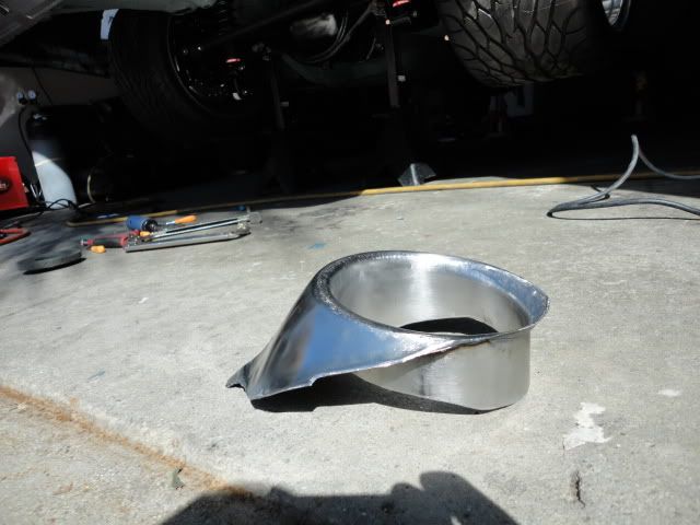

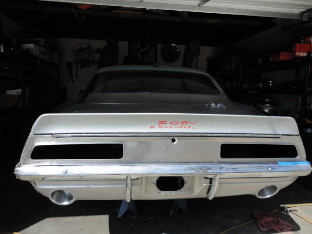

started playing around with an extra, damaged front lower valance and well got it into my head that I was going to use the round bezell for my rear exhaust. so I cut a whole on the rear panel and molded as much as possible went to a local diesel truck shop and got a foot of 5" exhaust. once I was happy with the way it was fitting the contour of the car ( both inside and out side) got to welding and grinding. and well 1 week later that how it came out.
also finally got another bumper that was not as twisted as the other and tucked in both sides to 1/8 from quarter all around (top and bottom) except for rear
it looks bad ass in person

excuse the double pics
