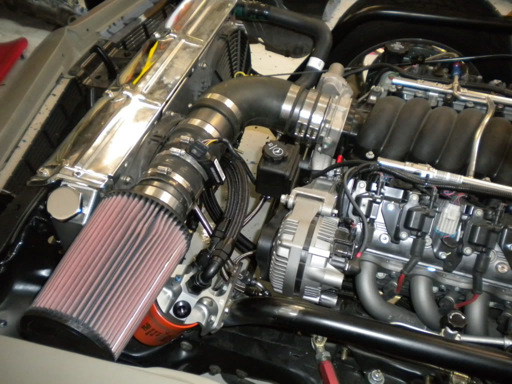

Here is how mine is mounted on a chevelle. Kind of a PITA
