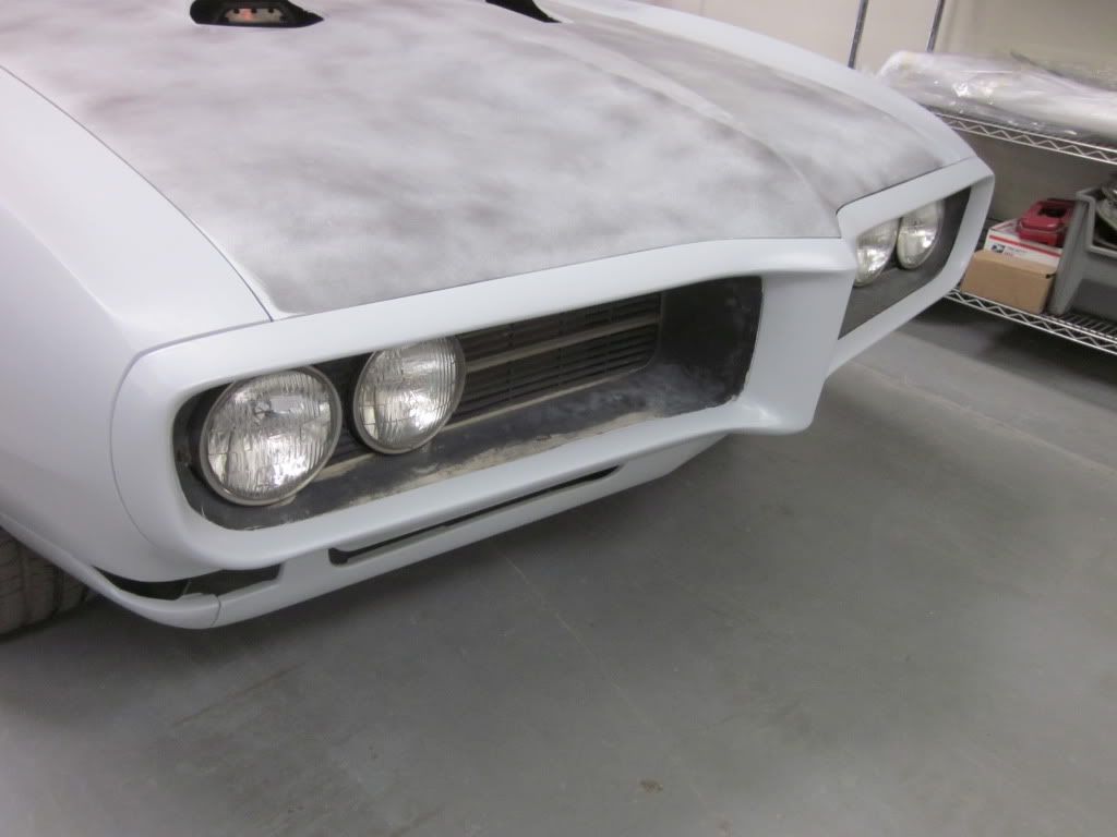

The Firebird has been getting a serious nose job!! It has been allot of work to get the lines as good as you see them in the pics.. got more coming! billet honey comb inserts that will bolt on to the orginal plastic headlight grills.. We even machined some mock up pcs...

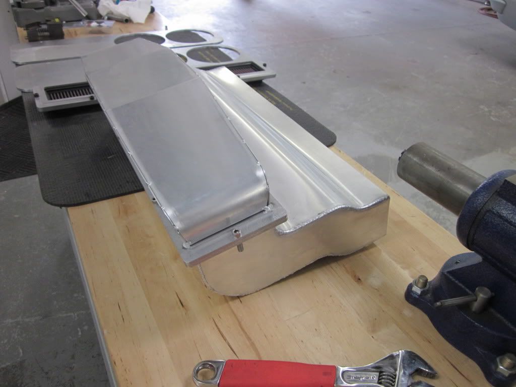

The cold air box is almost complete.. Machine shop should have one more piece I need to complete it & mount it...

Wow Cris, super nice lines on that beak. I have seen & heard how hard it is to get those noses all dialed in. that one looks really good.

Another great job and car Cris. The cold air intake looks cool.
