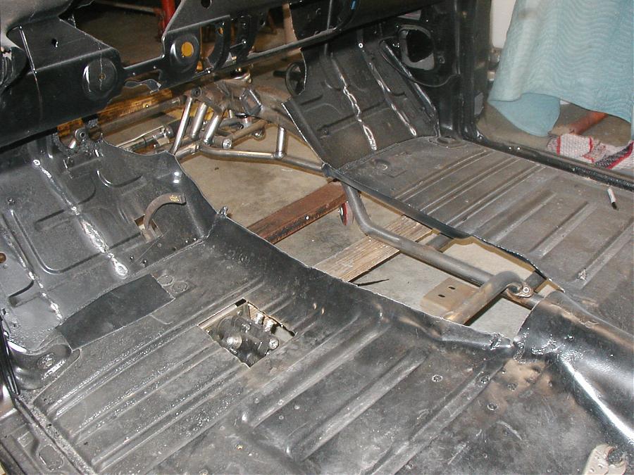

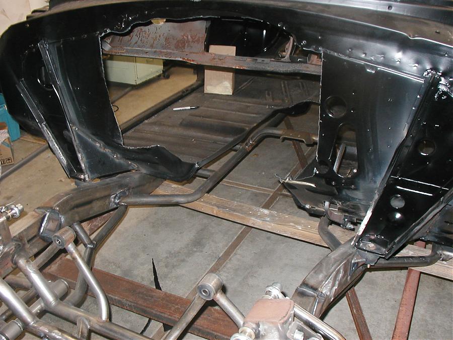

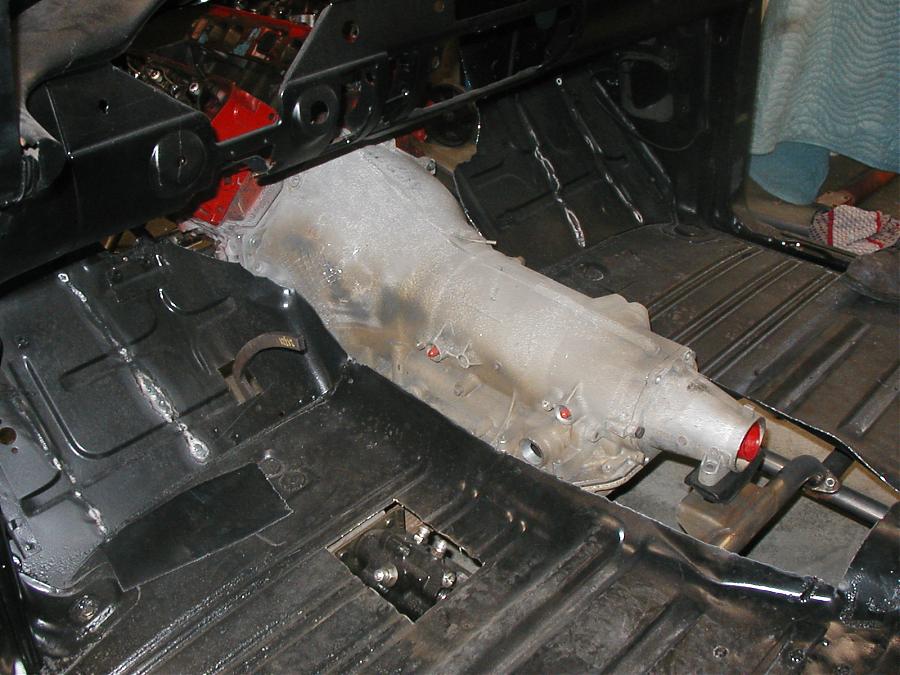

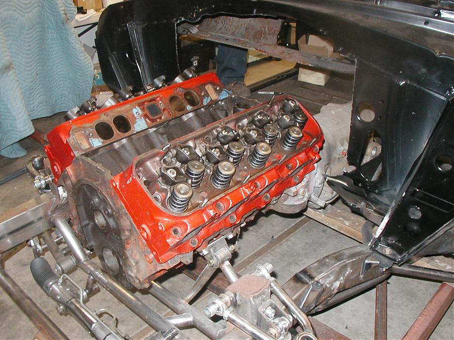

Well, other than keeping my credit card company busy, I finally got busy on the car. I made some support plates for the body mounts, welded them in & made some room via the plasma cutter to shoehorn the motor/tranny in. Had to really cut it up pretty good due to raising the motor/tranny 3 inches to keep the driveline angle correct. The reason for this is I raised the rear suspension up 5" over stock. The car will sit with the rockers 4.5" off the ground with a 30" tall tire. Took notes on how Troy did "Sickfish". I'll be working on my metal forming skills this weekend with the firewall & tranny tunnel.

The twin tubular K-member is a nice touch.

That is definatly a nice chassis.....
