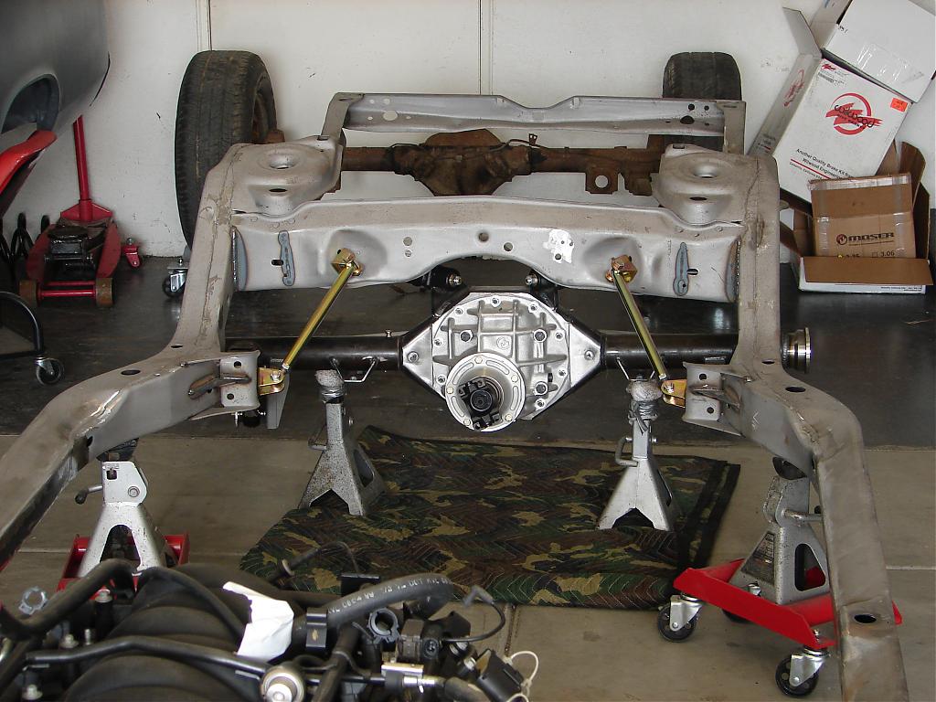

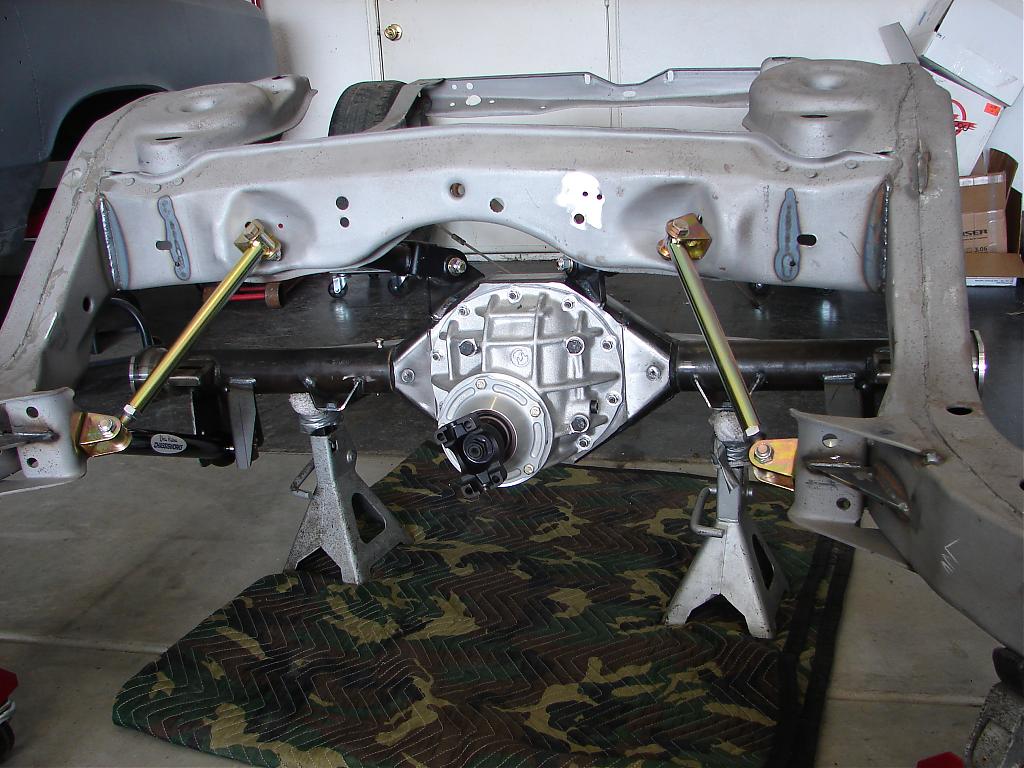

Found some time to get on the computer and catch everyone up on how the car is coming....

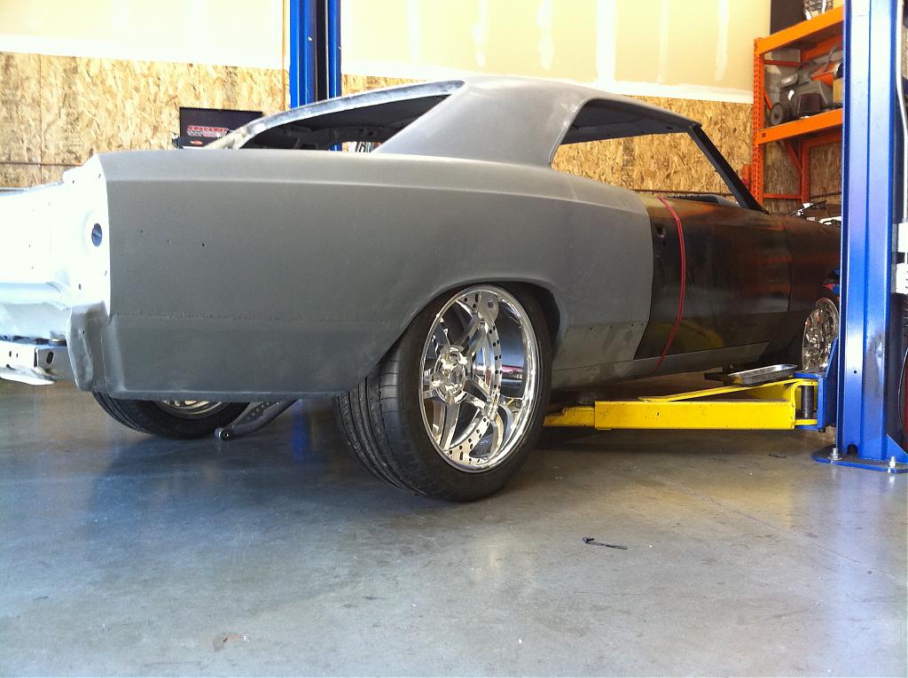

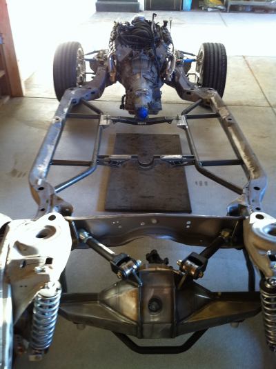

Since my last post the Fab9 has been installed with a Moser through bolt case holding a 35 spline Wavetrac. All being held in place a Chassi Works G-link and QA1 coil overs. On each end of the Fab9 is a pair of Wilwood 14" rotors and 4 piston calipers. Matching 14" Wilwoods with 6 piston calipers are on the shelf waiting to go on. Took a break from the car to add on to the garage so I had more room to work. Added on 530 square feet. It's almost done just need to get up some sheet rock and do the finish work. But when I saw HPI's new K brace kit I had to have it. After a few emails back and forth it was on it's way here. I had to get it on the frame as soon as it showed up. HPI did a great job on the kit. I had boxed my frame previously but with a little trimming thier tubes fit like a glove. Hope to get the body back on in the next few weeks to see how it all looks together.
