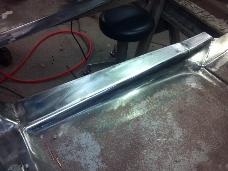

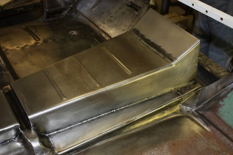

The trans tunnel and floor are going back in. The previous pictures were with parts tacked together. These pieces are in for good now. There was some rust repair in along with this as well. Turns out there was some rust where the heel of the go pedal was. Must have been wet boots! One thing I learned in this process is that I will just build a new floor the next time. This one will turn out nice, but I have half as much time in this as I would a new floor I think. Anyway, the underside will finish off nicely and more importantly it will be solid for years to come. All in all I am pleased so far. let me know what you think!

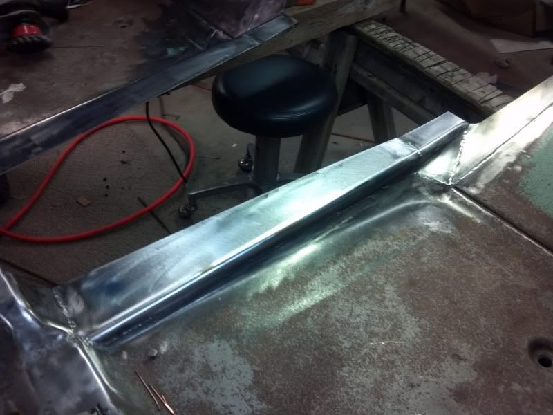

The new trans tunnel is in for good. Not much, but it is progress.

That's alot of progress to me bro. Looking good...keep it up!! I'm following this build because I have a 68 C10 I'm going to be starting on later on next year.

Lots of welding there Chad!
Keep on plugging away!
My back has been telling me the same thing! I need to lift this thing up another foot or so!

I find it hard to TIG laying down... Wish they'd make a chin operated controller...
Tell me about it! Those welds in the picture are about 2 feet off the floor and in the middle of the cab. The rocker hits me in the knee and then I have to lean in but keep my leg straight and work the pedal. Luckily I'm 6'-4" and can reach in. You know how that is! If I lifted the cab more my Dad would not be able to reach in.
