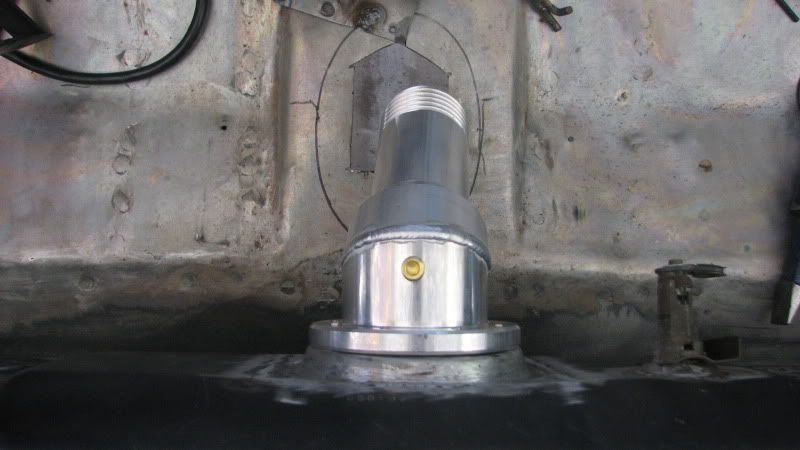

Ok before I start a Part III build thread, I figured I would do some updates of stuff I got done before I dropped it off at JCG.

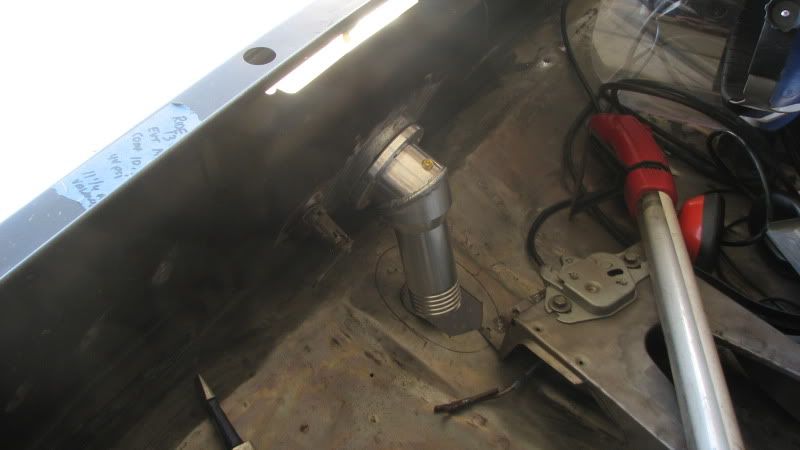

First I adapted a RideTech/Coachworks camaro fuel filler neck to work with my tailpan. I used the tailpan section from a '68 Camaro and cut out the recessed section of the donor piece and cut out a matching section on my Cuda tailpan...then it was dialed in and fully welded.

The Camaro piece works out pretty well, but it does have the slight offset point to the passenger side....it doesnt completely line up with the filler hole on the tank.....cutting the filler neck and aligning it with the tank inlet is on the "JCG to do list"

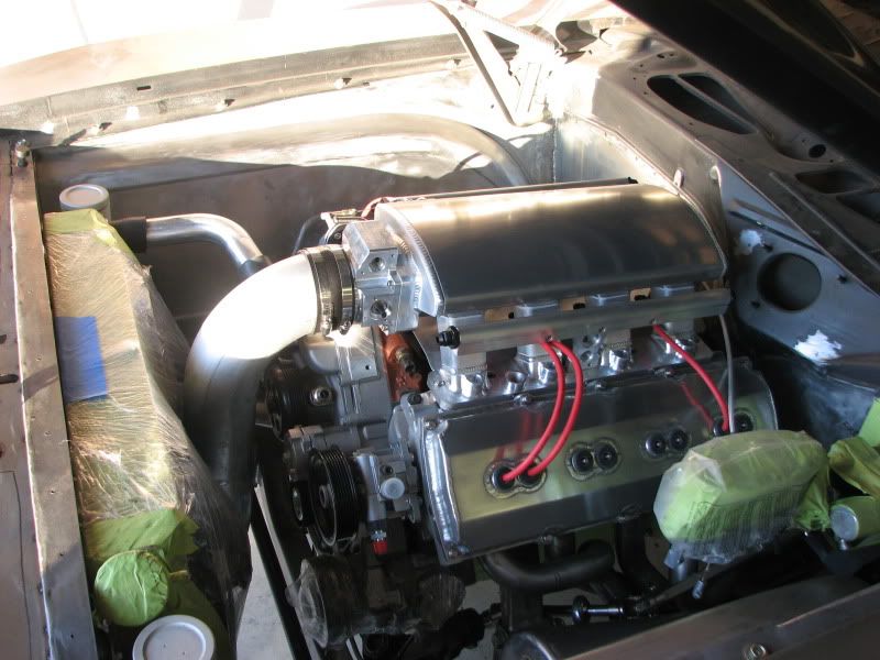

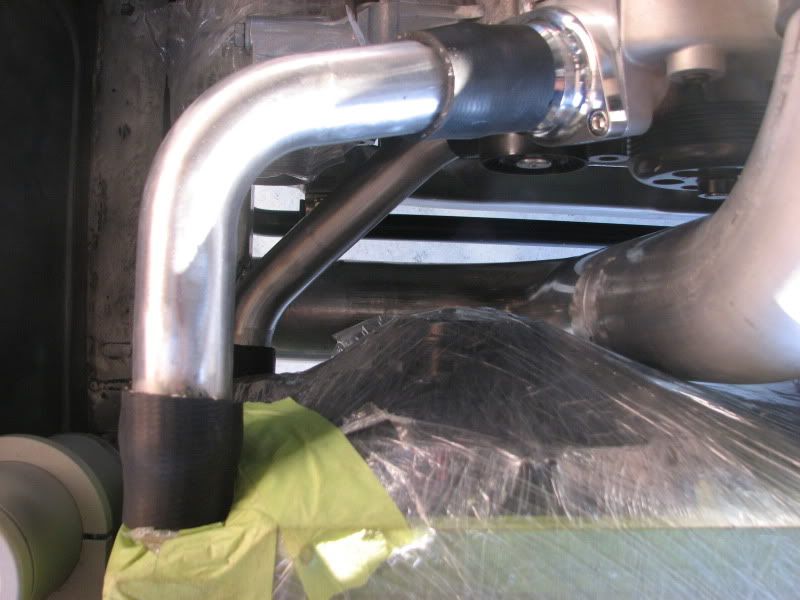

Then it was time for the air intake tube....decided to go with the 4 inch and keep in clean and simple....down straight from the TB, parallel to the radiator base and under the frame and into the wheelwell. I mocked it all up and Rob tacked it together for me. I'll get a good TIG man to final weld it all up
You can just barely see the tube at the corner of the front valance....I'm going to black coat the tube going into the wheelwell, so you will never see it...the car is really low too, so it should disapper pretty good.
