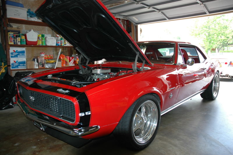

I should have a set of the L2R2 leafs in my hands in a few days. I honestly dont think you could go wrong with DSE or GW. On the 3" drop, I know I could not do a 3" drop leaf. I was at 2" in the front and rear and am staying at that height due to clearance issues. The 69's seem to have better clearance for some reason.
For reference, this is how the car sits right now lowered 2" all around.
https://lateral-g.net/forums/atta...9&d=1335824549
That looks pretty nice! Got any level side profile shots outdoors? +info on your wheel/tire combo please.
I can't see myself ever being as low as some guys and I think that would look "right" for me.
I just sent you a link with some pics and specs on the car. Didnt want to muddy your thread up. When I get the leafs in 2 days, I will get you some pics and should have the car back together over the weekend.
