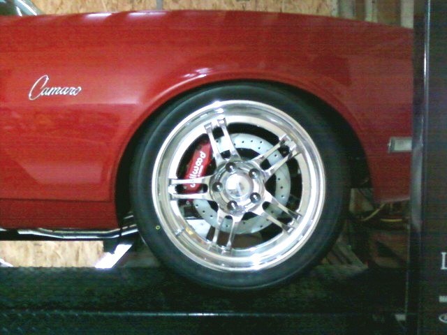

Nothing like a text message Sat night showing progress on your car!!
Teaser cell phone pics
315mm of meaty goodness out back
275 of meaty goodness up front. Front fenders will need to be rolled and inner fenders clearanced to make this work.
I can't wait to see this in person!

Chad, what backspace are you running with the front wheels?
Gaetano the front are 18x9 with 5.75" BS. Due to the full mounting pad fiasco I don't get much outer lip. I do have over 3" of caliper clearance though...
