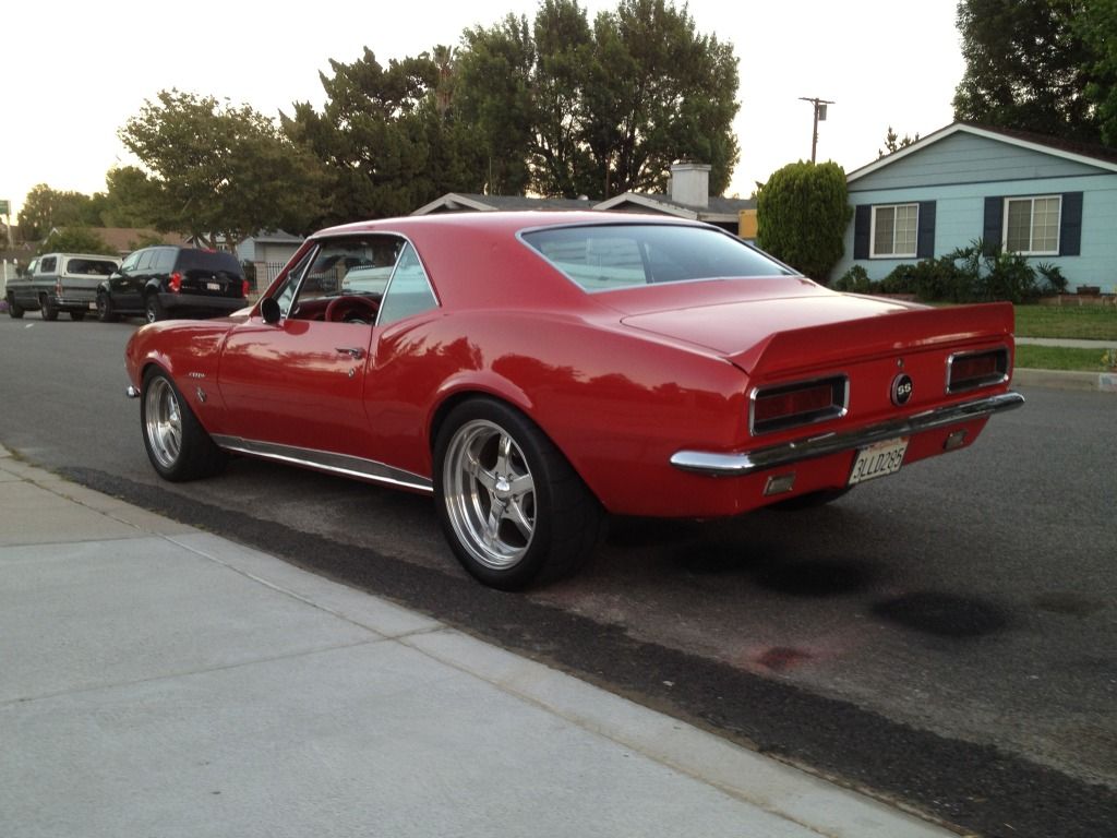

Here are pics of the reverse eye spring. Also, one side pic of the rear. I'll get some full profile shots tonight. I pulled the old subframe connectors out and got the new GW subrames in last night. Had to cut and reweld them to get them to sit up close to the floor.

Here are some profile shots.

Smoker, that stance looks killer. What are you tire and wheel sizes, if you don't mind?

Man, is he right about the stance. It looks great.
You've really got a great looking car.
Front: 17x8 with 245/45-17
Rear: 18x9.5 with 275/40-18
And thank you for the compliments guys. Robert, I hope this helps make your decision easier.
