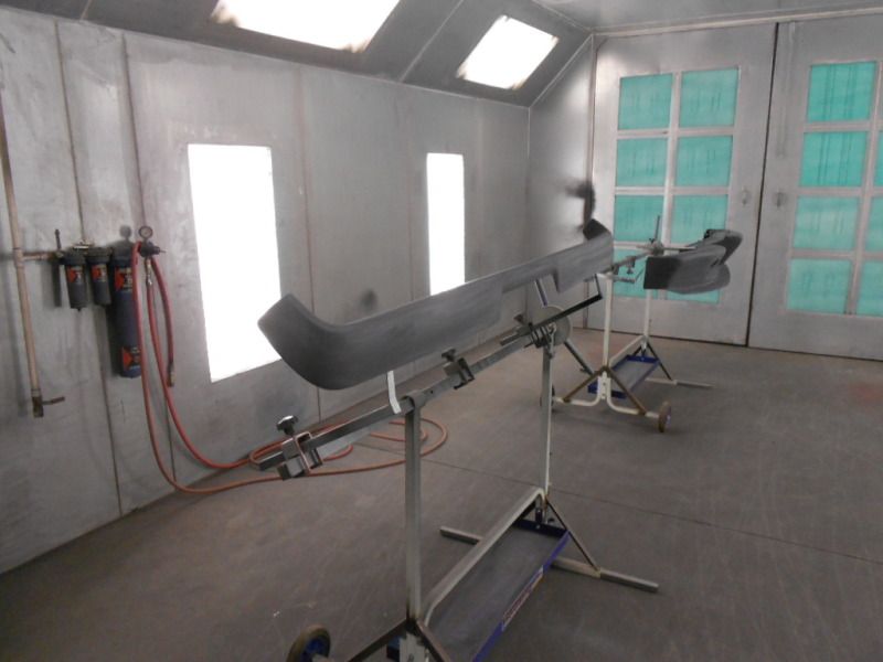

I will be busy block sanding this weekend getting ready for paint

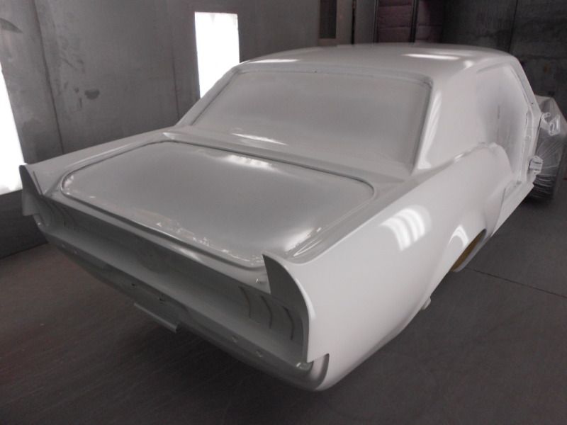

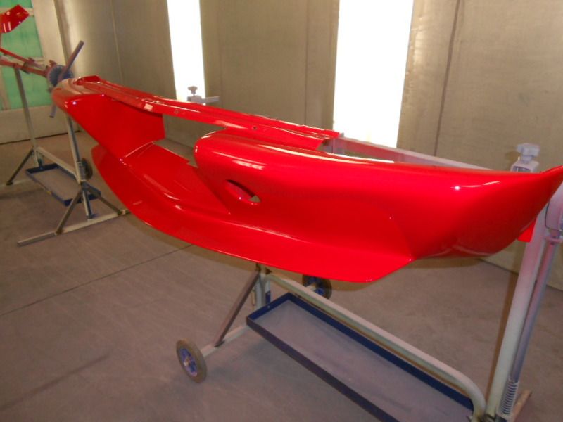

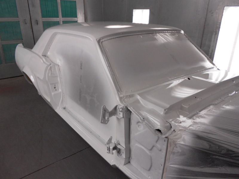

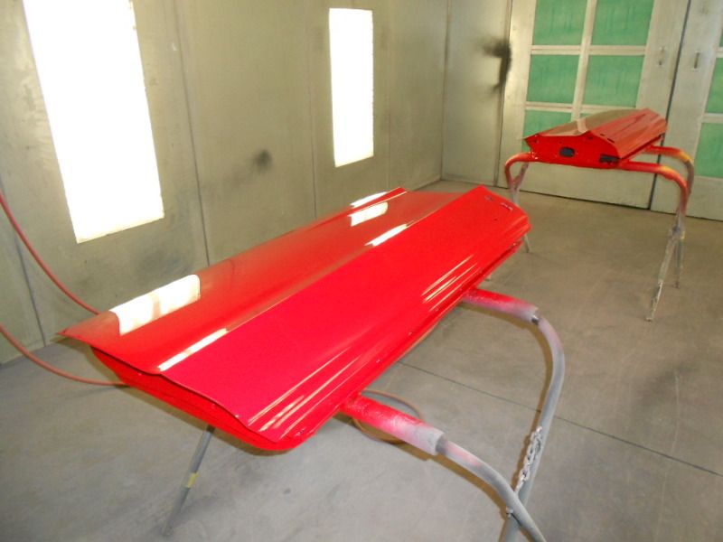

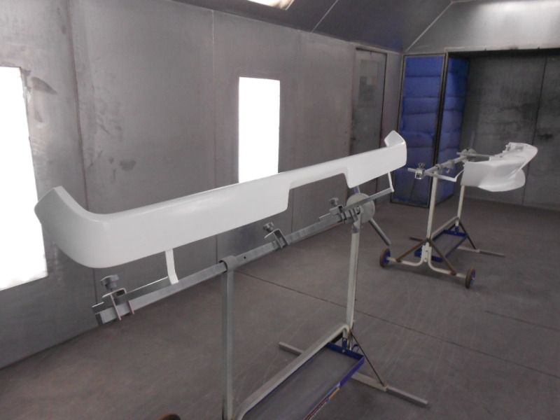

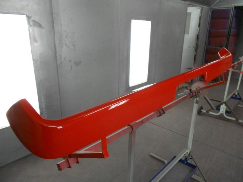

I sanded with 320 than epoxy primed white
After lightly wet sanding they were sprayed with SPI Red followed the next day with SPI Universal Clear.

Steve Baur the editor of Modified Mustangs & Fords Magazine asked if I would give 20 tips on how to do a paint job and wanted me to paint the Coupe for a future bodywork issue.
I have the doors and fenders painted
I epoxy primed the body yesterday with SPI white and today we are wet sanding getting ready for paint.

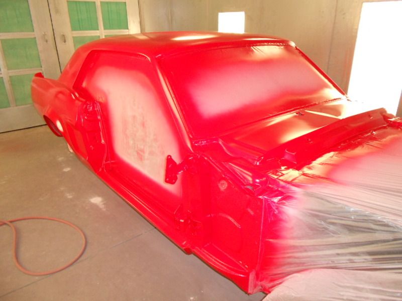

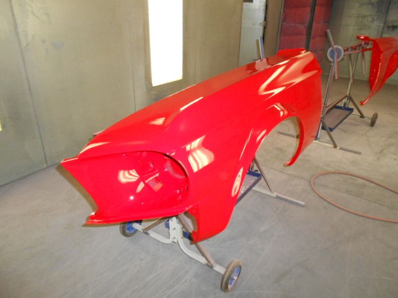

Yesterday I sprayed 3 coats of SPI Red

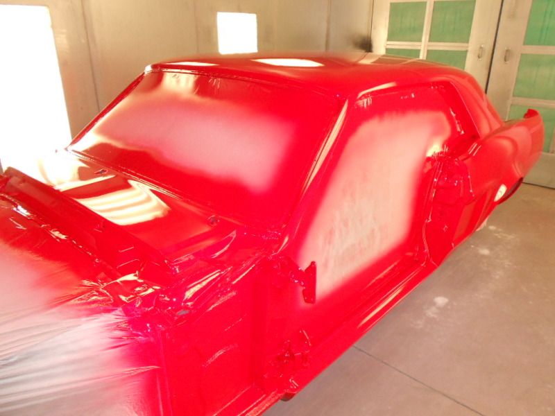

I sprayed 3 coats of SPI Universal clear

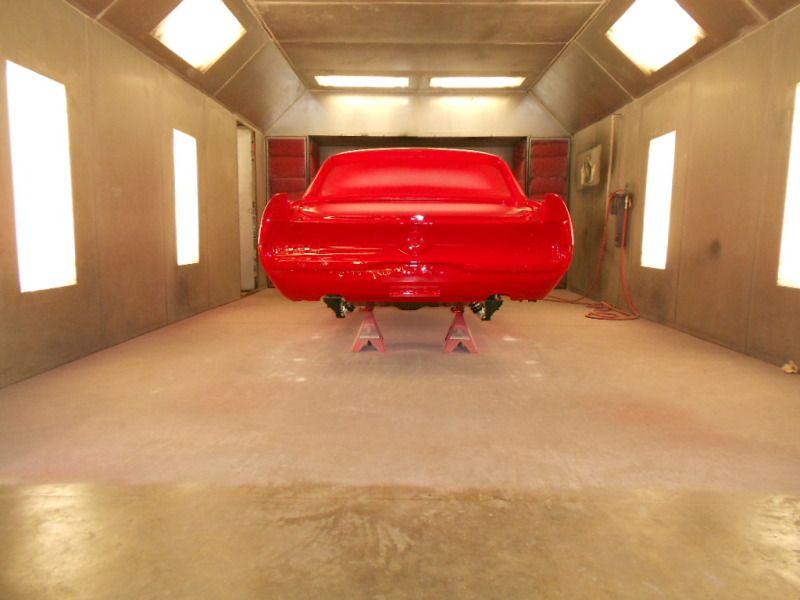

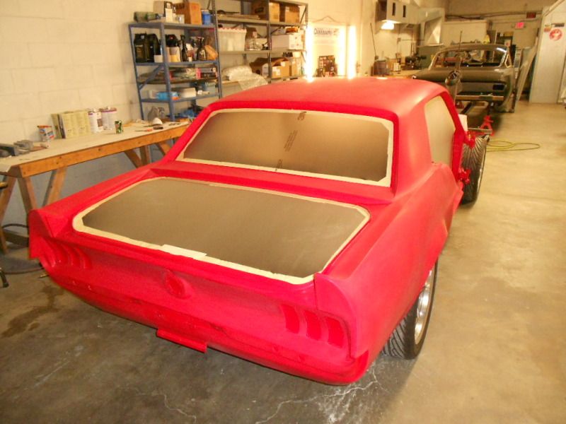

Ready to come out of the booth for wet sanding
After wet sanding with 400 Brian taped again and it is ready for 3 more coats of clear
