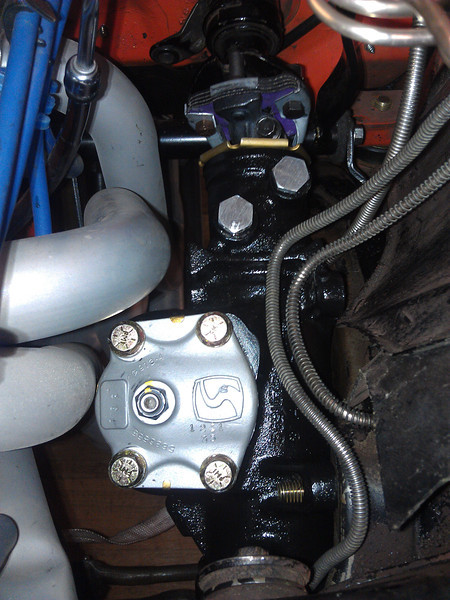

I just read in your build thread that you just bought a Lee box. The Lee 670 box is the same box as the DSE box, according to Lee when I spoke to him last week. If you were to purchase the Dynatech headers, you'll need the same one's as I have. Although, I'm running the 1 3/4" to 1 7/8" headers. The Dynatech headers will touch the steering box on your car with stock heads, so you will still have to clearance the header, aka dimple. There isn't enough meat on the box where it interferes with the header to make any clearancing on it. Dynatech needs to recognize the problem with their headers and correct it.

I can't answer if Dynatech's fit the 825 box, but I can take whatever measurement you want to help Just let me know

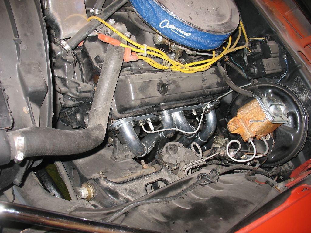

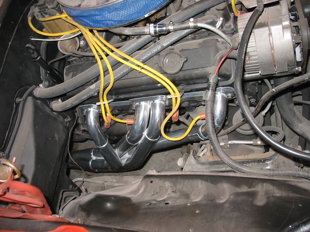

We use Dynatech ALL the time because they fit amazing compared to every comparable brand I have found....... here is a pic of the box clearance on a 69 camaro small block with dynatech headers. Sorry all we did was install headers, so its not the nicest engine bay! Oh by the way they even drop in from the top. I know its a stock box, but look at the clearance! I would venture to say no problem with the lee box.

See where my interference issues are and notice how the header flange is still not completely mated to the head. This is with the DSE box, which the company says they redesigned the headers to fit. They still do not fit without dimpling the #5 primary.
