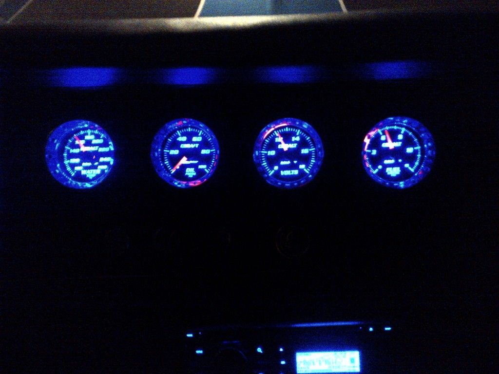

Took some crappy cell phone pictures last night...
Thinking I may just remove the Trans Temp and Oil Temp gauges from the map pocket area and just run the D-PIC or clock in the middle with two bullet style AC vents on either side...

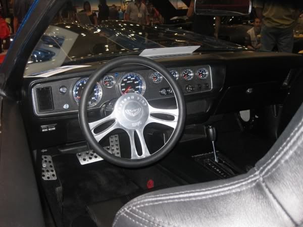

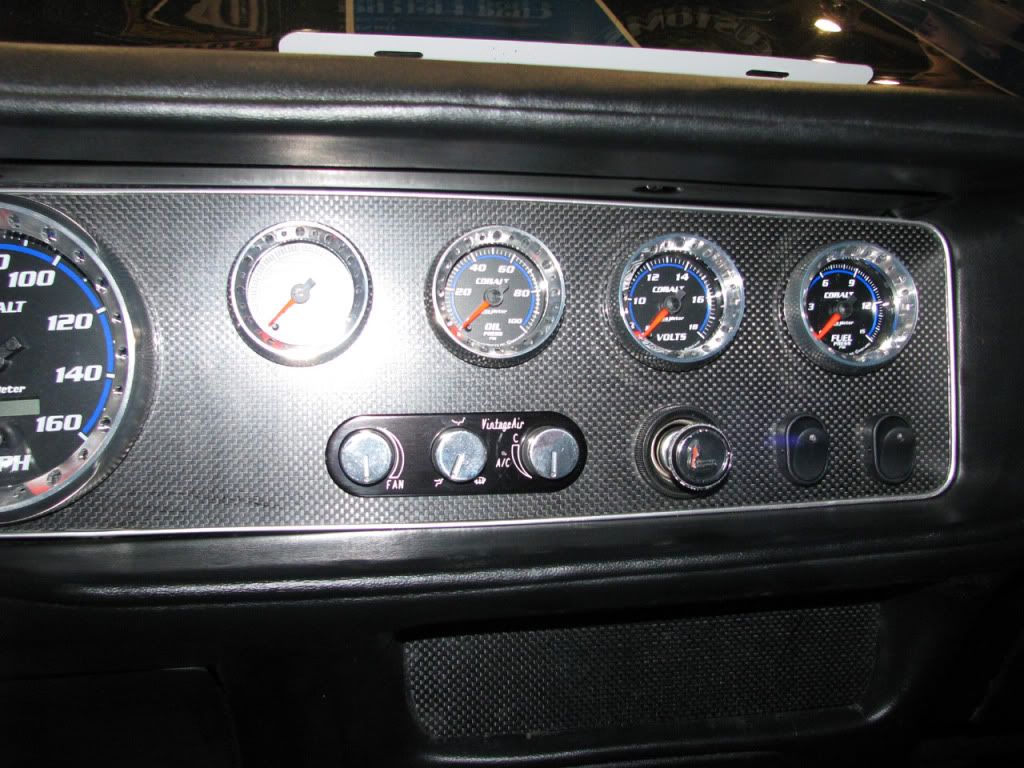

Old 09-07-2012, 11:53 AM
Musclerodz's Avatar
Location: washington, ok
Posts: 4,286
Thanks: 22
Thanked 164 Times in 95 Posts
Mike Redpath
Musclerodz & Customz
facebook page

Originally Posted by Musclerodz View Post
Okay Mike! Who makes it and where do I get it? LOL
Are the under console and glovebox door vents operational in this car?
Ty Ingle, USAF Retired
FREEDOMBIRD

carbuff's Avatar
carbuff carbuff is offline
Location: Austin, Tx
Posts: 1,320
Thanks: 17
Thanked 23 Times in 16 Posts
Does your Firebird dash plastic piece set that is in the lower area have the AC vents already (like in the picture above, under the steering wheel)? I can't tell from your pictures, but I'm guessing no? Adding those would give you a second pair of vents at least, and lower instead of just the uppers which you have now.
I agree that having some air flow in the middle of the car would be helpful too though.

Old 09-07-2012, 02:43 PM
Musclerodz's Avatar
Posts: 4,286
Thanks: 22
The under dash and glove box vents are not operational. It is a custom built piece and i started with a 69 Camaro center dash vent. I find it interesting no one has asked us yet if it came from the factory like that.
There is not 6 vents, there is 4 dash vents and 2 defroster vents
