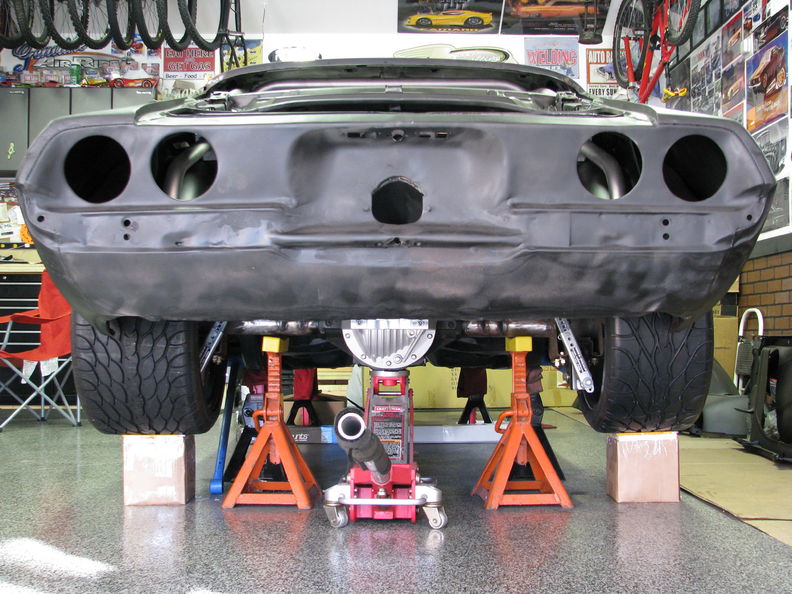

2nd Chance Camaro - To 335 or not !!![
2012 09-24 Update - To 335 or not !!!
www.2ndchancecamaro.com
Evening all,
There has been a lot of progress on the car and I am playing catch up on the posts.
So here are the two tires side by side. 335 on the left and 295 on the right.
Since the goal it actually drive this car I am pretty sure I am going to be using the one on the right. However I will still make sure the bigger 335 fits under the car.
