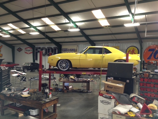

Here is a pic of Jackass. The tape is at 10' and the roof is a few inches below it. I took the pic from a ladder. I have 61" between the floor and the bottom of the hoist. The Nova in the background measured 55" tall.

Thank you for the idea, you just helped solve a dilema I was having for a new garage. How high would the car sit if say you have to park an SUV under that lift??

Measure your SUV then look at my pic. I have 61" clear. Is the SUV more than 61" ?
Lexus GX470 is 74.6"

Direct lift(the black lift) has a taller version. I have a cayenne under mine and it just fits the standard version. Tall height is 78 inches under lift.
