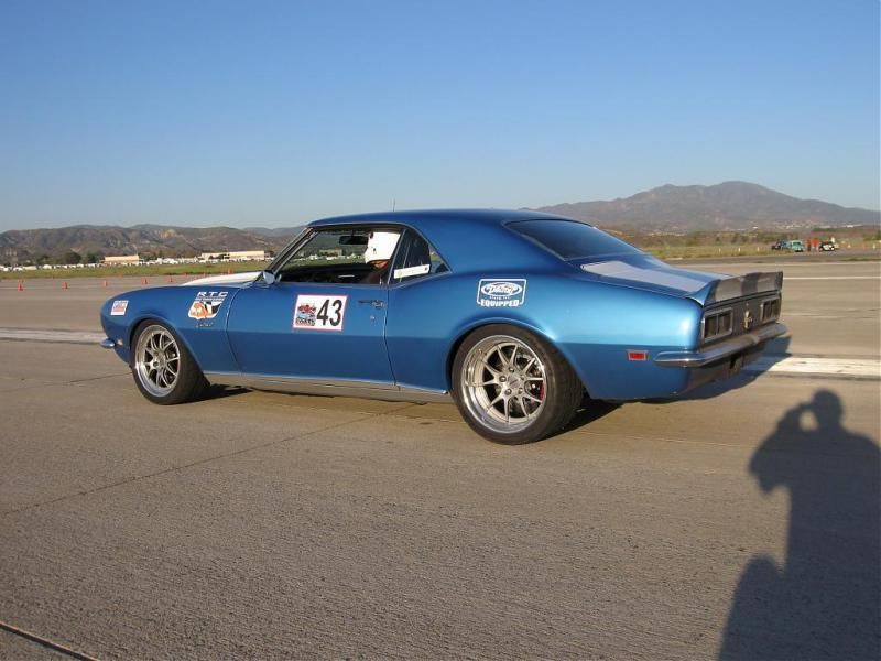

question 2
hidden hardware or not on a titanium center with polished lip?
question 3
zx3r or zx3p? why? <<< i sorta like the zx3p bc they make the rim look bigger
if you look at these two pic notice how theres more lip on the bottom pic front rim than the 1st pic. This is the only way i would want a step lip is if i have that lip right before the center part of the wheel

titanium center and inner, engraved color titanium centercap, hidden hardware, hoping to get alittle more lip on the front
the only thing that is left is my wheel size. 18x9.5 and 18x11.5, 18x9.5 and 18x12 or 18x10 and 18x12?????? after looking at "dust off" and "blue hour" im leaning towards 18x12 and 18x10 but if i go with 18x11.5 its a easier transistion to a 315/30/18 if i wanted too

Originally Posted by randy View Post
need help trying to decide what to do.
question 1
18x9.5 and 18x11.5 <<< allows me to go to a 315/30/18 if needed
or
18x9.5 and 18x12 <<<< 18x9.5 is the recommended width on a 275/35/18
or
18x10 and 18x12 <<<< widest rim size. pushing limits on how low i can go
question 2
question 3
Both front wheels most likely have the same the backspace, but the top pic (mine) is 18x9 and the bottom is 18x10 thus the extra inch of lip before the center.
