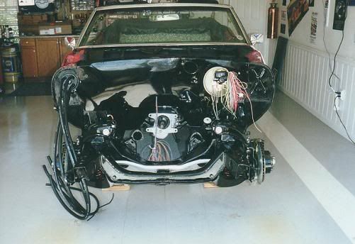

For 1969 Camaro - anyone have any photos of where they did the pass through the firewall using grommets only and not a bulkhead for their A/C, heater hoses? Would like to know how it looked turned it before purchasing bulkhead if possible.
If no photos for those that have done the pass through, did it turn out ok or have issues routing the hoses to get them to turn without kinks?

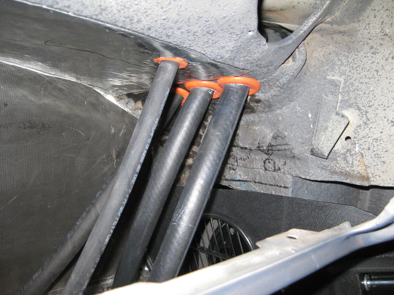

This is not my car but it is what I will be doing. My brother in law used black grommets and has had no issues/kinking. System works fine. Cheaper way to go, uses less fittings. If you havent ordered the kit yet just get it with longer hoses so you can keep the hoses hidden all the way up to the core support area.

Thanks for the photos, that was very helpful. I was going to run my lines that way as well and didnt see the benefit of buying all the connections and bulkhead when it would be hidden for the most part.....thanks!

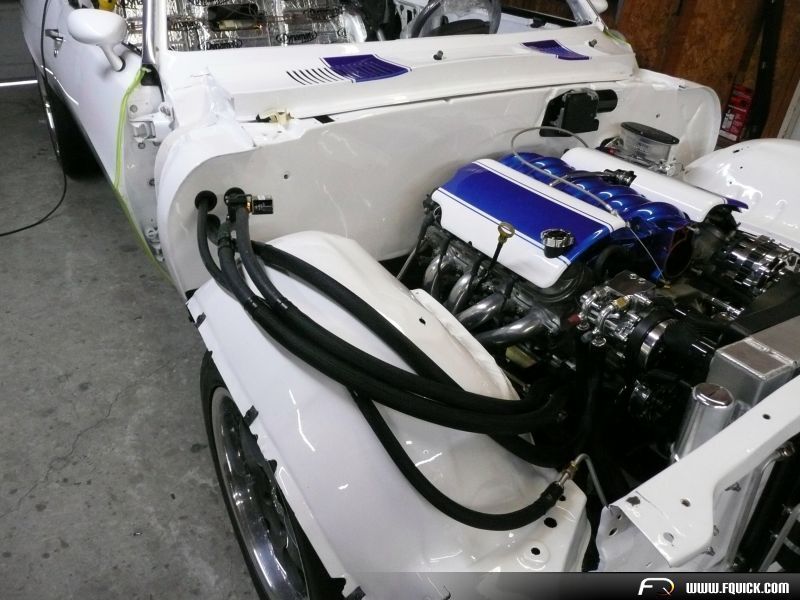

I am going to do the same. Here are a few that I have gathered for ideas on how to run mine.
I am going to run mine like this since I still have the blower hole.
