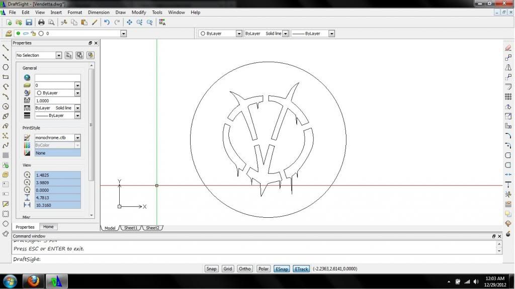

Now, 2 years prior to this my mom and dad got divorced. When this happened, my father had already stopped talking to me, and when i talked to him about it he said some very hurtful things to me, and about the car. After that I became depressed for a few years, debated on sending it to the crusher, selling it, etc. Finally i decided that was enough, that he was wrong, that i have the will power and drive to fix her and shove it in his face! The name of the project has been decided. Project VENDETTA!
