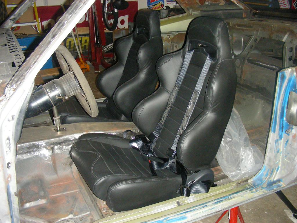

The height depends a LOT on the sliders/mounting brackets. My Arizen seats came with some low profile sliders. They added very little height to the seat. The sliders bolt to (2) 1/4" thick metal plates and then you measure and drill holes in the plates to bolt them to the floor, and use some shims under the plates to level the seats. It's a very tight fit because of the clearance of the seat to the floor but it works if fine if you get all the measurements just right. My dad is 6'2", about 220, and he had no issues driving the car, other than putting my rev limiter to the test too often.

Once you pick out your seats, Wedge Engineering is supposed to make lower seat brackets or make your own. I made mine and also extended them to the rear more which will help a little with the slop of the seat bracing. Mine are 5/8" thick not 1 3/4" like the factory made ones.
