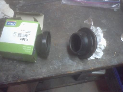

I have the part number written down at work but this is what the new one will look like:
http://ls1tech.com/forums/attachment...6-img_0747.jpg
and the old:
http://image.gmhightechperformance.c...-glory-024.jpg
Strange, that's a lot different than the other pics I've seen on the net. I thought it would look like the one on the right in the following pic(the standard one is on the left):
And here's a pic of the rear seal on a Viper-spec T56. You can see the metal lip(red):
They look much different than the one you provided a pic of. Are you sure that's the new one?

Called Tremec this morning and spoked to Dale and asked him about this issue and if he had the part number for the metal-rimmed version of the seal. He said the following:
"We've heard about this issue with the rear seal and we believe it can be caused by the seal simply not be installed into the tail housing far enough from the factory or that your drivetrain/shaft is too long and it's smacking the seal during suspension travel. Check your seal and see if it seems like it's installed properly. Also, I'll check that part number for you on the metal-rimmed seal and call you back."
He did call me back 15 minutes later and gave me the following part number: 1300-044-017
Raj, is that the same part number you got from them?

Sorry for not getting back to you earlier Chris but the part number is the same as you listed above.

Going by memory, my T56 mag was ordered 1stQ last year. It has the metal ring on the OD, rubber seal inside that so I would think you're safe Chris.
