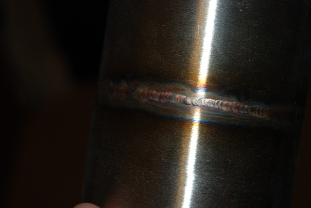

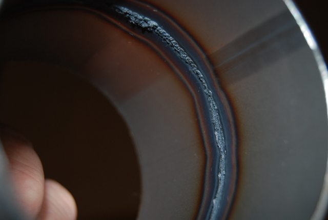

Well I have been playing a bit and I think I am getting close.
Next I will try with back purging.
Greg

Weld looks great Greg!
Yes - back purge will take away that sugaring and make for a clean inside the tube.
Nicely done!

I'm still playing, I have a set of headers to make and I want to leave the welds untouched, I like the fabricated look.
Greg

Well done Greg.
Looking forward to the back purge results.

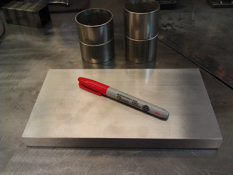

New addition to the welding bench............
I'm looking for all the handicap I can get!

And -- just because I see the Sharpie there... that reminds me! Don't try to mark something up with a Sharpie and TIG around it --- pencil either!
In other words -- if you've made a line on a part - clean it off before you weld.
