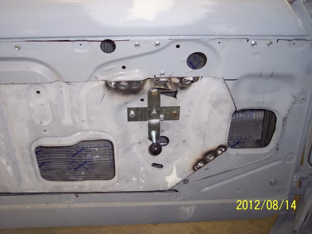

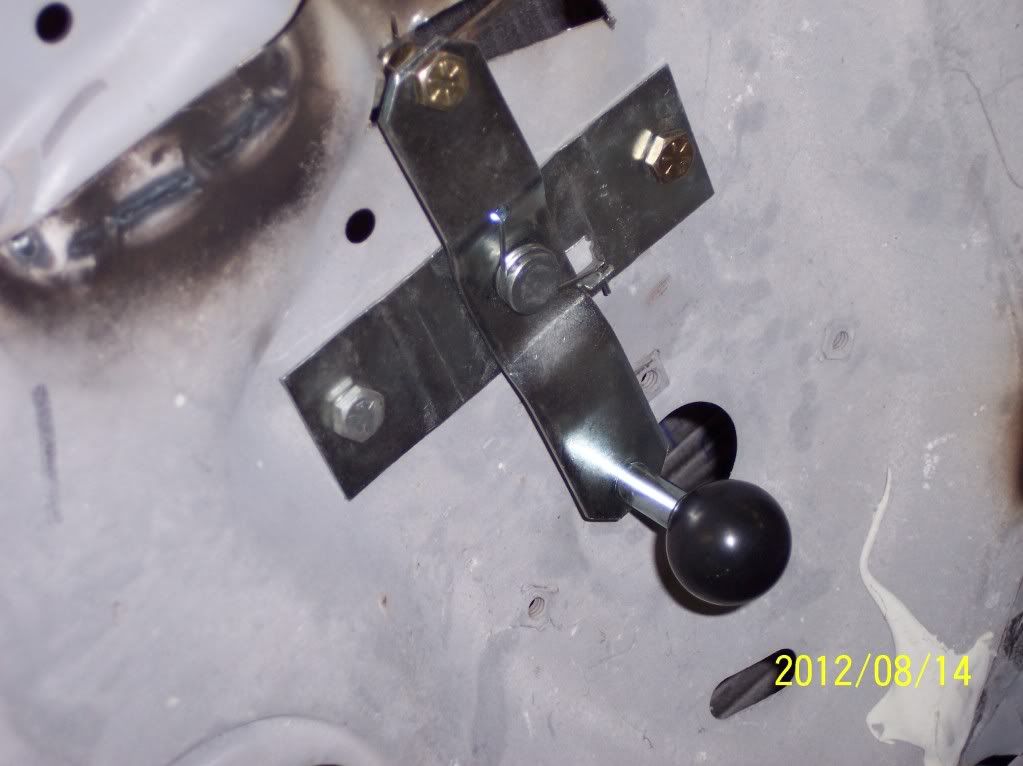

Had to move from outside of door glass to panel side, since going with vent window delete&powerwindows,,upper panel had to be removable for fuzzies to screw in,, Hope this makes cent$

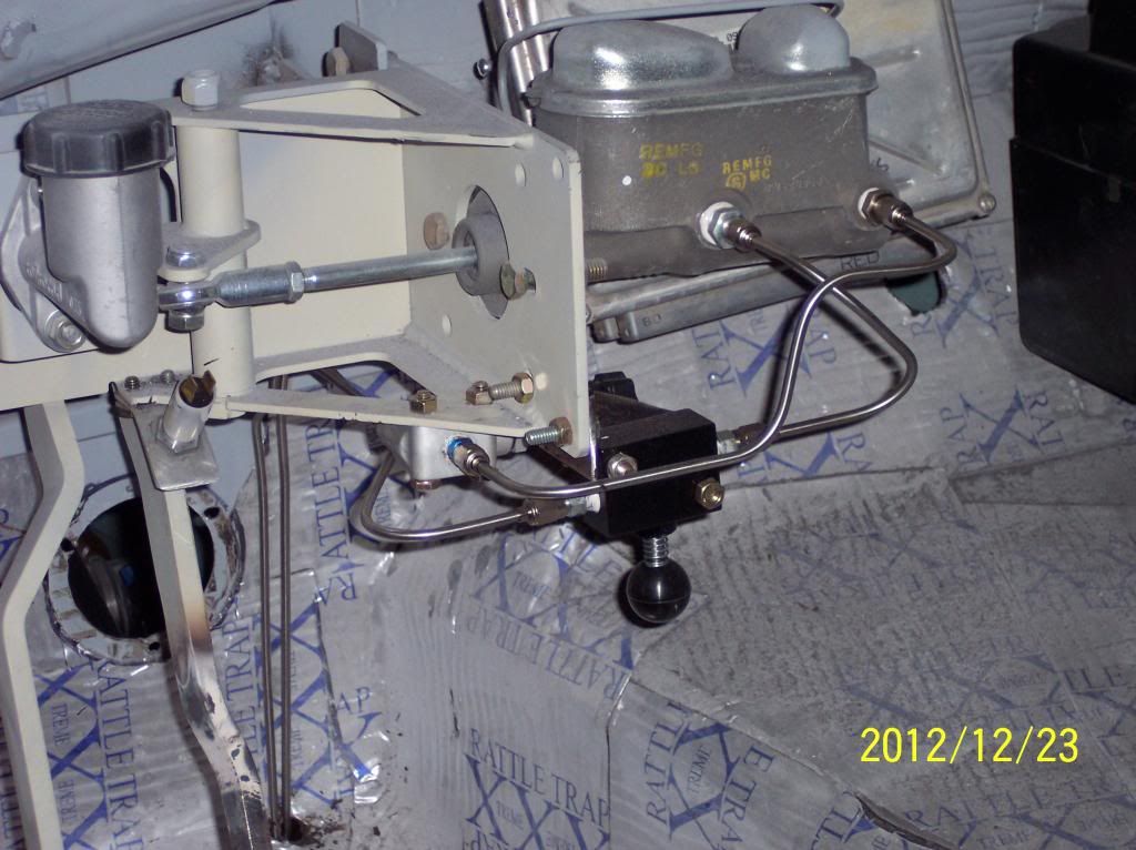

A/C trail fit,, Brake lines in position,,,,Defroster vents cut in,,

I love your dash but how are you going to service your brakes. Its a sweet build

Dash, will bolt in,,, brakes and clutch will be operable before dash goes in,, Can access, from bottom ,will need a hose and bottle to service if a leak shows up ??? Will have to pull steering column ,to remove dash,,,,
