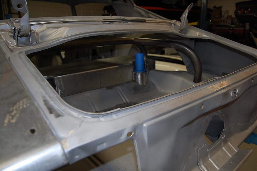

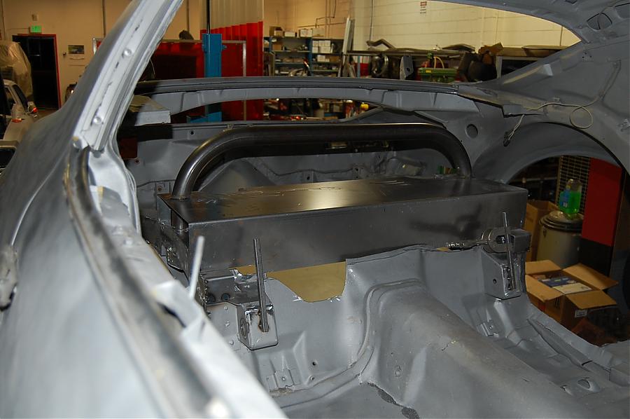

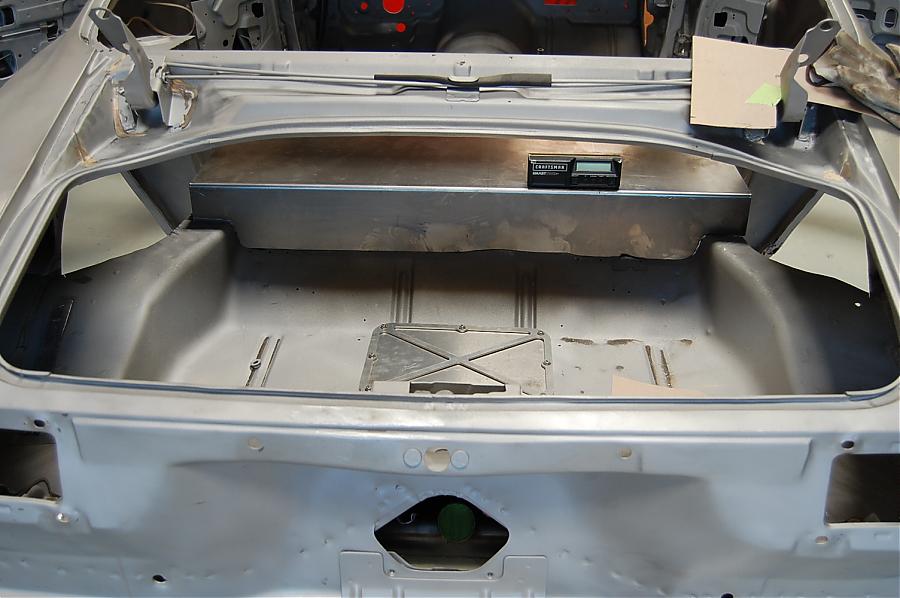

I was looking at it and it would be easy to resin in a few AL dzus tabs in the grille area and have screws to the fender behind the headlight buckets. We'll figure it out when we make it to that end of the car.
We mocked the gas tank in and trial fit the rear tray. Now to box the frame.

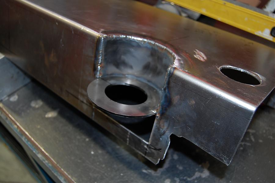

Vince@Meanstreets's Avatar
Posts: 5,532
Thanks: 13
Thanked 20 Times in 13 Posts

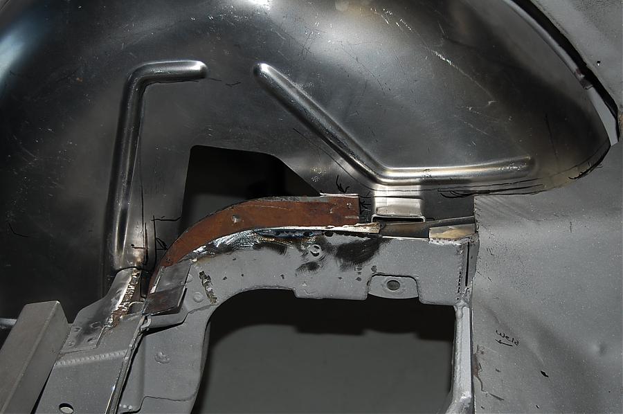

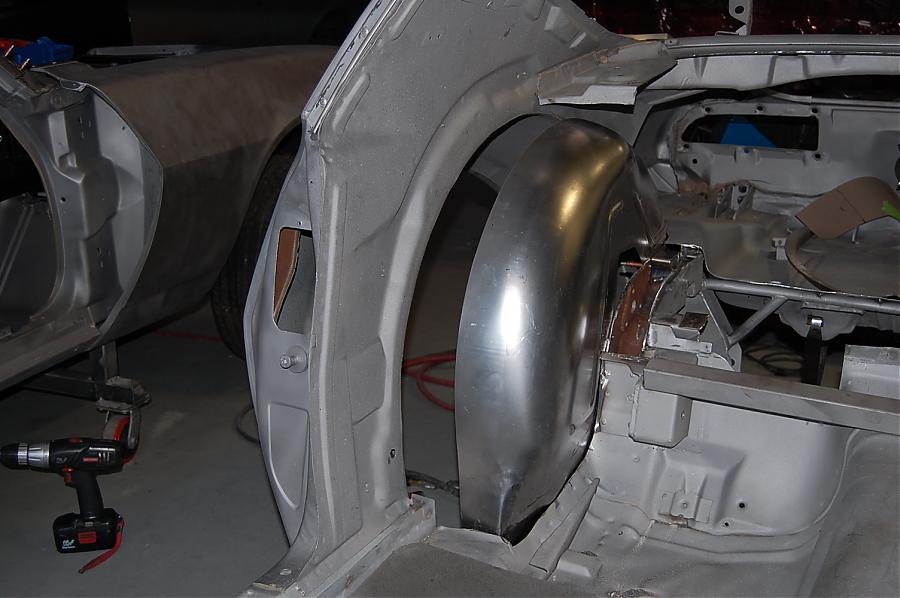

Sorry I haven't been updating the progress. We had an emergency rush job come in and it took a week to get through.
I side tracked myself with the extra bracing, then frame rail trimming but managed to get one side of the frame rail modified and inner structure for the support bar in, now I have to go back to work on the frame rail cap templates so we can get it all welded up on Monday. Then repete on the other rail.

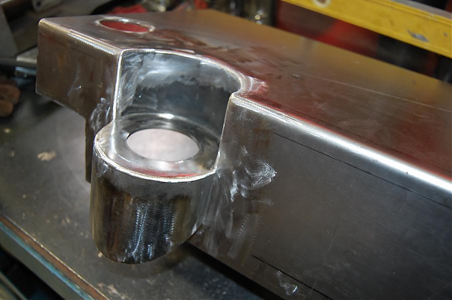

Posts: 5,532
Thanks: 13

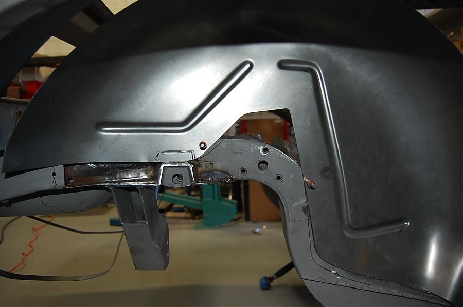

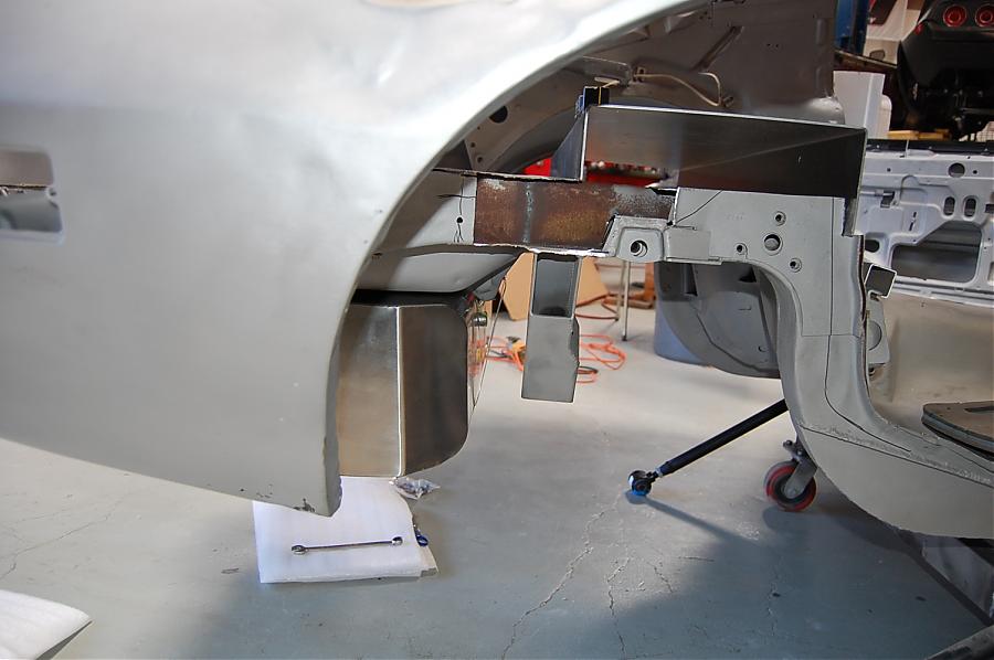

Left and right frames are done and boxed. Now on to the crossmember and cross bar.

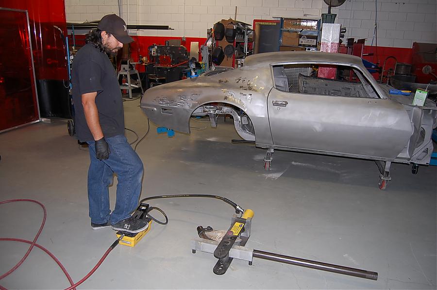

Posts: 5,532
Thanks: 13
bend er up son!

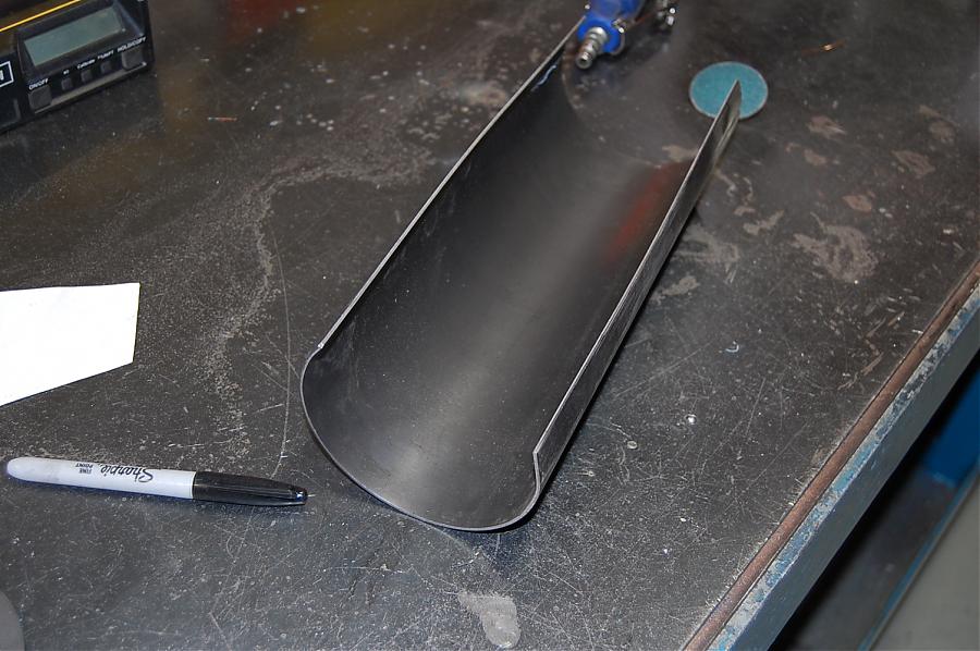

more of the II Much vent supports....

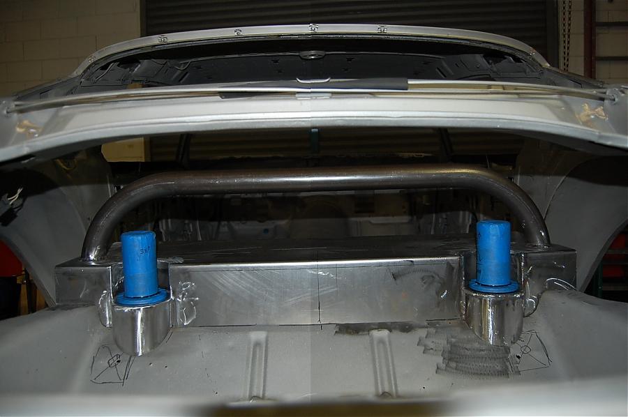

Posts: 5,532
Thanks: 13

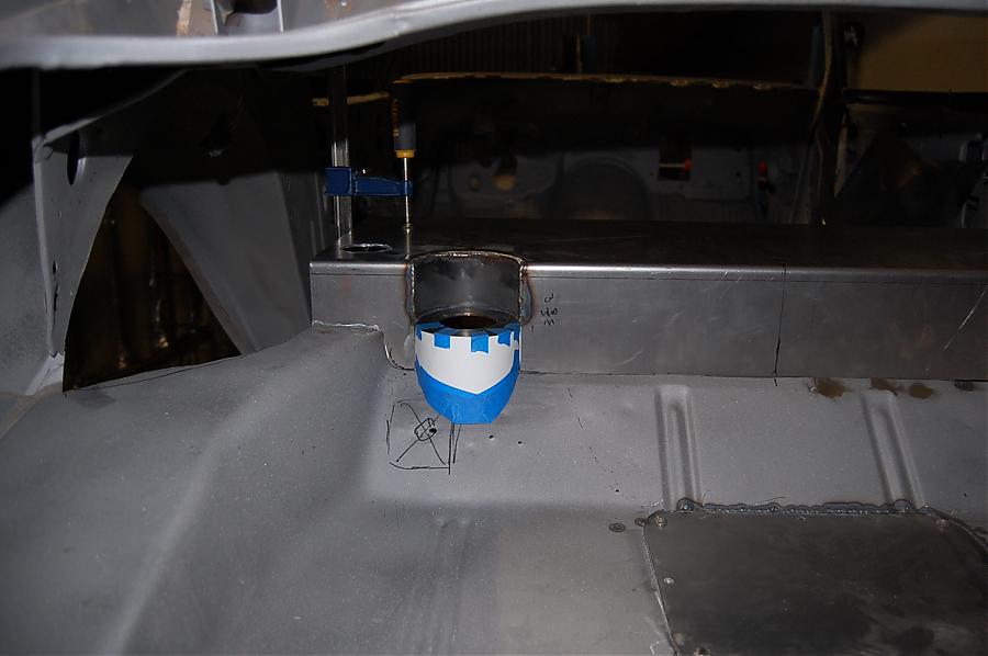

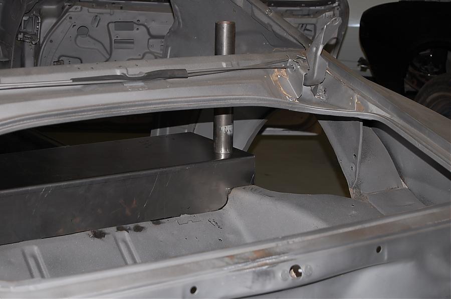

with the rear hoop in and the supports finished.
rear down bar test pipe mocked in. I think we will be doing a 45 then terminate back farther.
