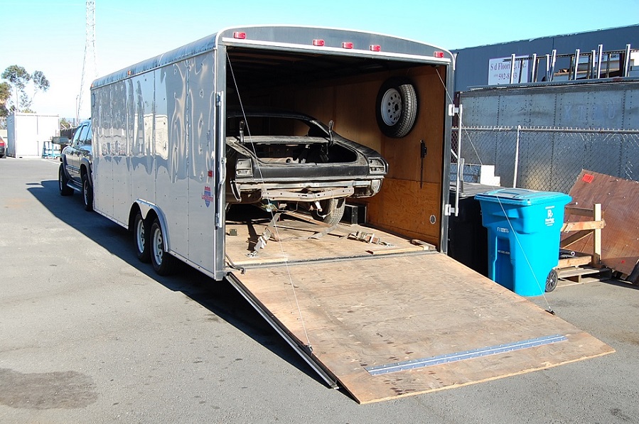

The car finally made it to the shop. It only took 10 months or so.

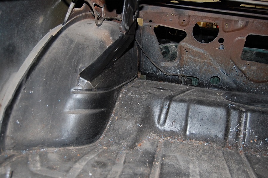

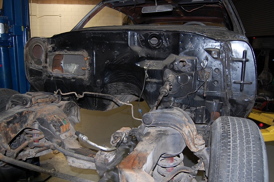

The day will start out with inspecting the body and see what sections we will have to remove prior to media blasting. I like to do major cut outs first so the blaster can get in all the nooks and cracks.
Punch card for this stage:
Inspect panels
Cut out:
inner and outer rear wheel houses
rusty rear window channel sections
trunk filler panel
heater side firewall
front cowl gutter
trans tunnel
Get to media blasters by Thursday.
