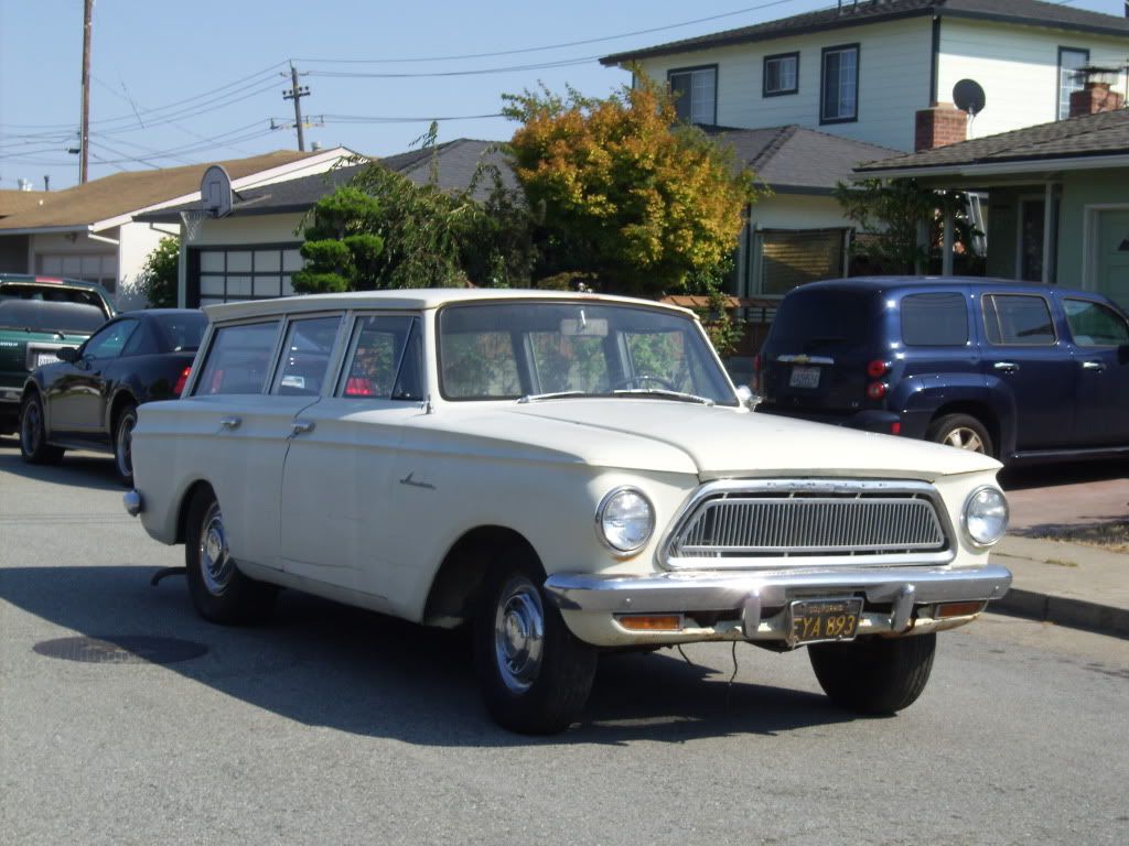

ha ha ha funny but thats not the camaro in that picture that's the Rambler project Im building,
here it is, still under construction
widened track width (60inchs), only a 101 inch wheel base, 10 bolt 8.5 chevy diff, ridetech 4 link, custom subframe, corvette, spindles and brakes, coil overs front and rear
what I started with
Jane's fenders are fine here a link to the popular Hotrodding feature on my car just in September
http://www.popularhotrodding.com/fea...evy_camaro_rs/
