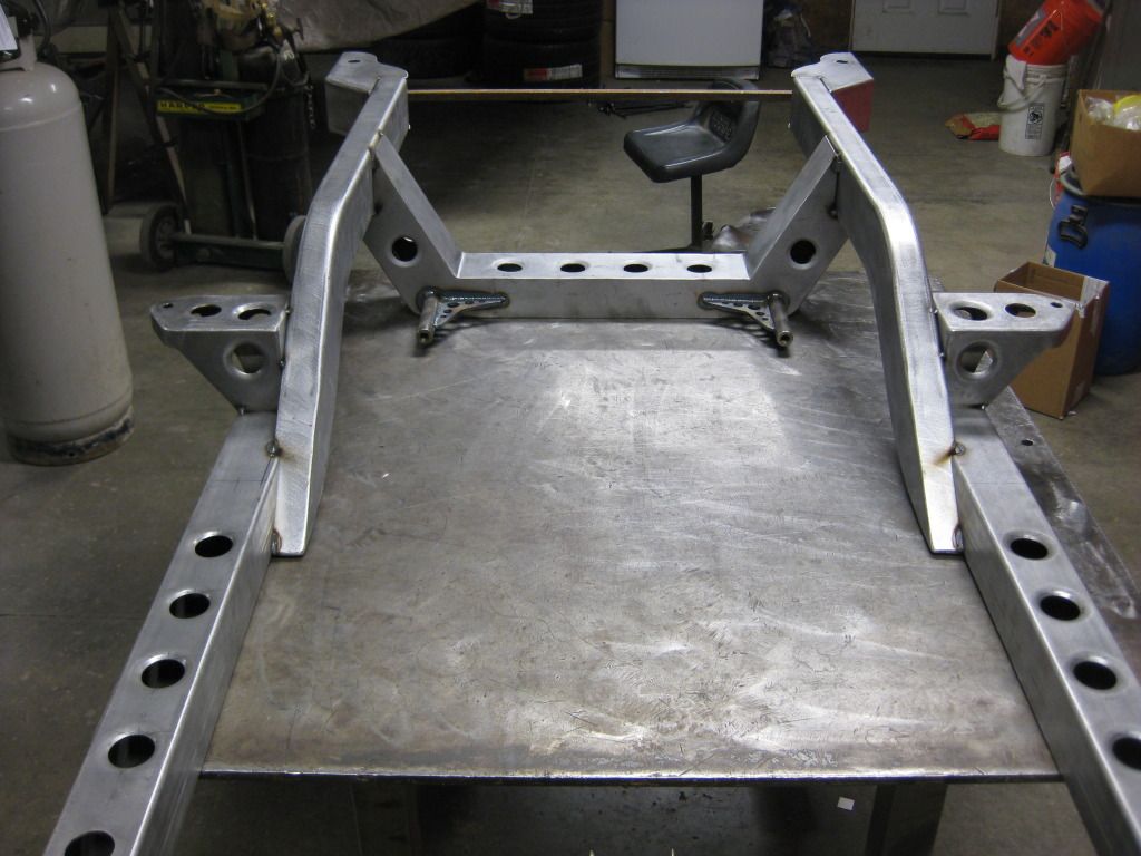

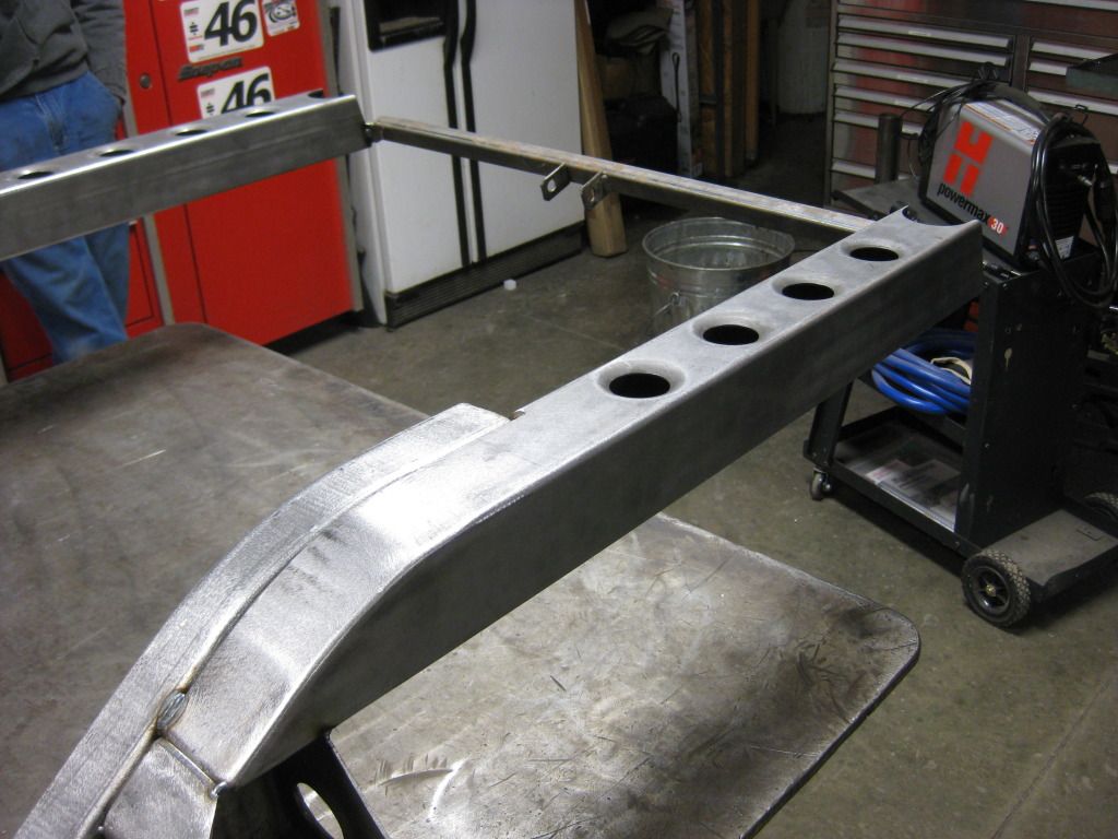

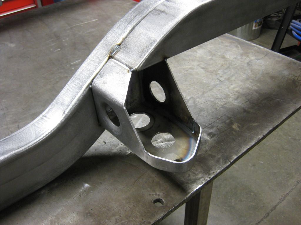

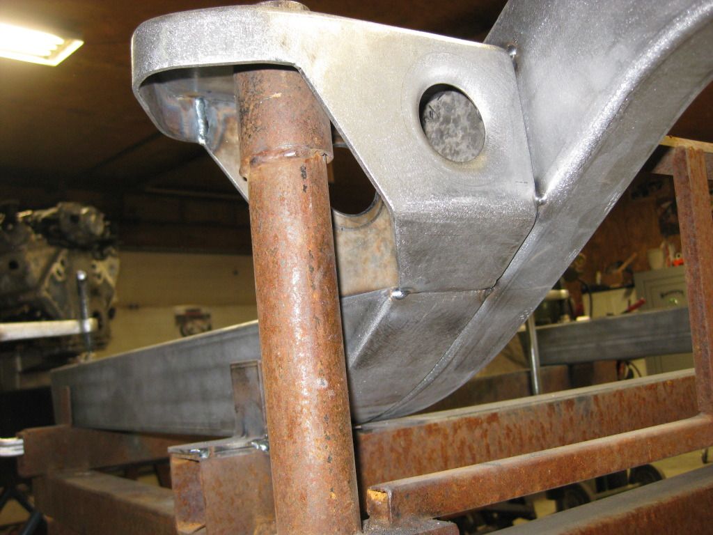

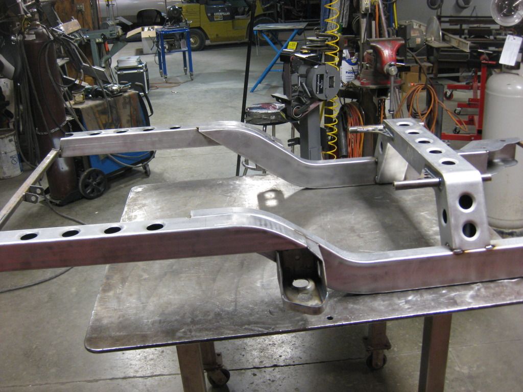

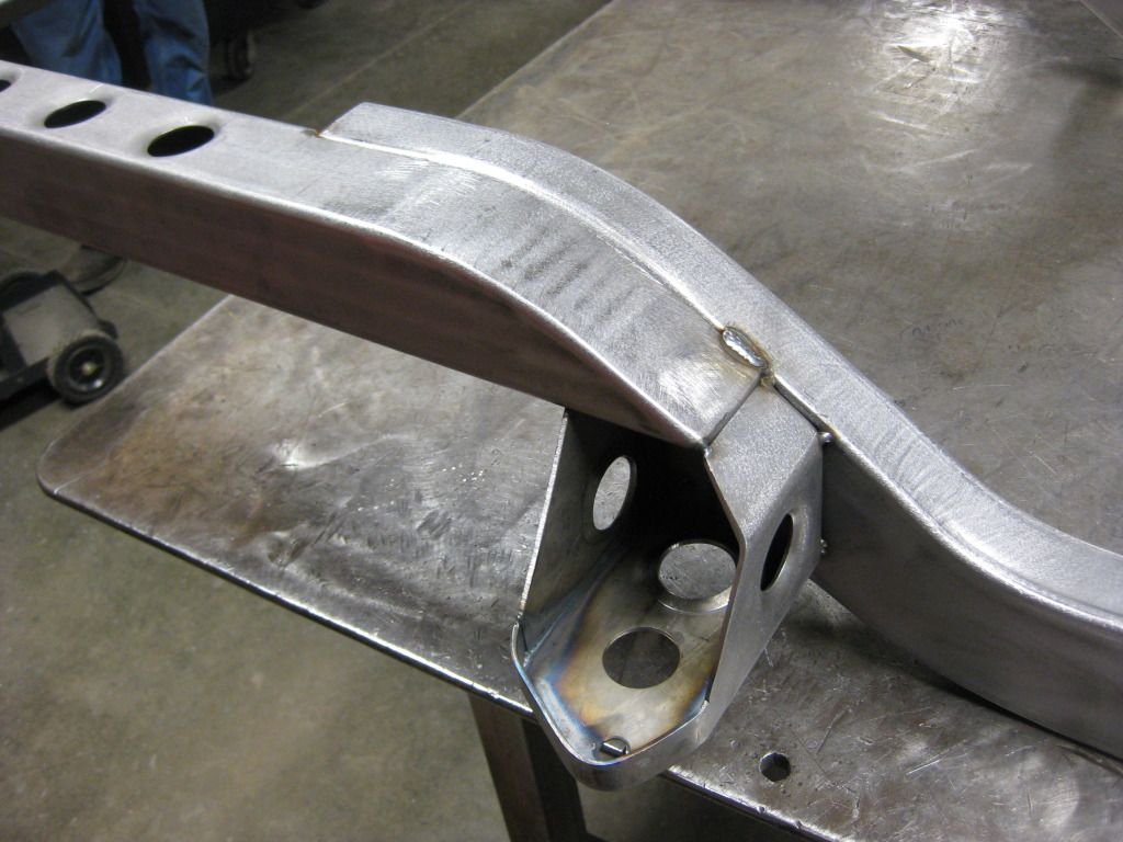

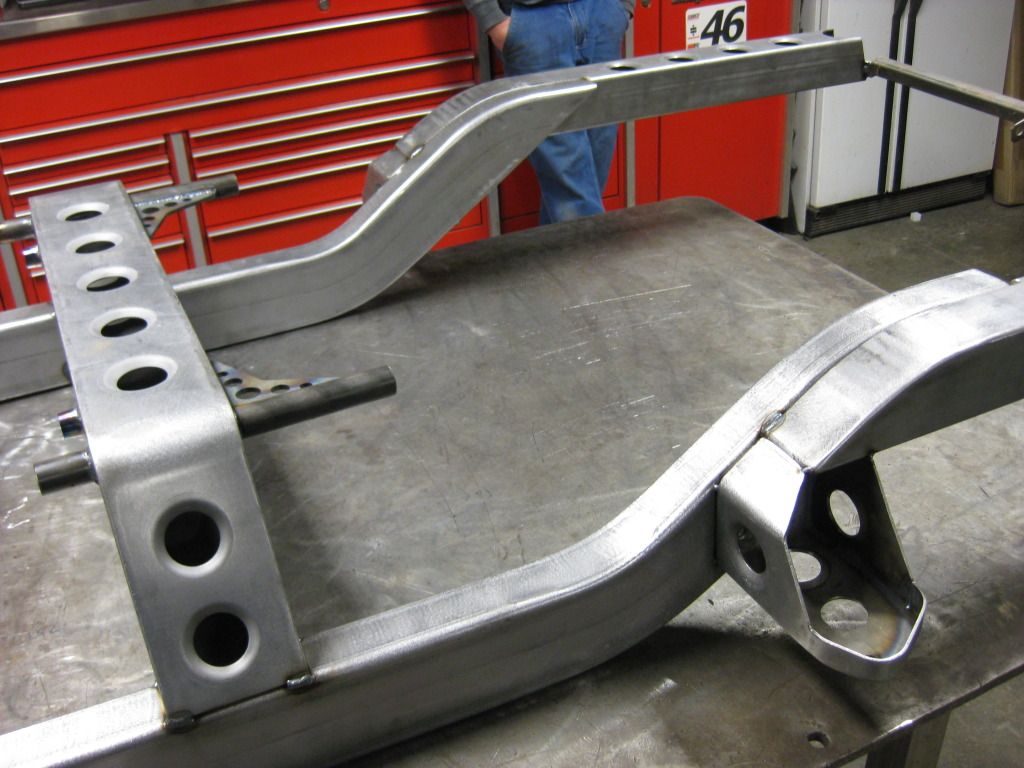

As the heading say's I have have a new sub frame Design to 2013.This will be an upgrade for those of you wanting an even more Professional Looking Design.I have Added new Mandrel bent 2x4 mail rail's,CNC Plasma cut flat part's,New stronger cross member design,A new upper A-Arm mounting plate W/more coil over shock ajustment.A New sway bar mounting tube design,All new lower A-Arm surport mount's,New frt. body bushing mount bracket's w/alinement hole's,Punched & dimple die'd lighting hole thur-out the design.An all motor mount & new tran's crossmember design.All material will be P/O tubing or plate.Completely DA'd smooth and ready for Qualtiy Powder coat or paint.Here are a few sneak peak photo's of the progress.http:jpg
Wow, I just found this. Super cool styling. I'm a big fan of the Dimple Die work.
