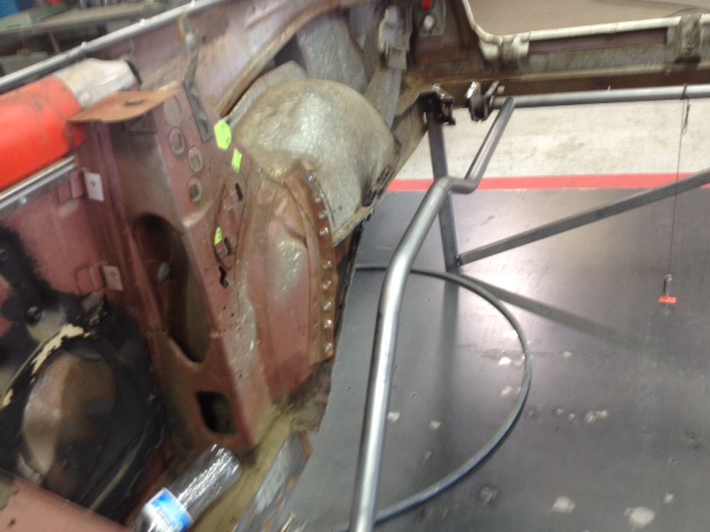

Here was the starting phase of fitment and teardown. To answer the big question about is it a street car or race car. Answer is this is a Street car. will it be daily driven, NO. Capable of daily use? 110%. Im just not taking the risk of something happening to it. LSA drivetrain. 6l90E. So why wouldnt it have CTS-V like reliability. Strange 35 spline trutrac ford 9". Brembo brakes. Detroit speed uses vette front spindles. So whats gonna be the weakest link? probably the soft top lol.

jig that they built to hold everything nice and square while cutting out the floors
