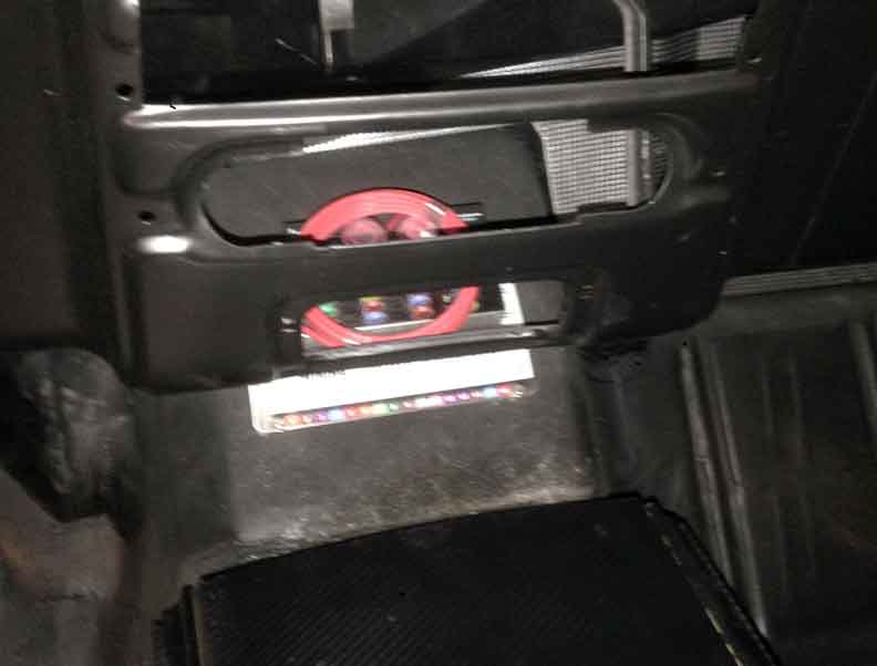

This was one of those weekends where I did many little projects. I dropped my headers off for ceramic coating, installed two grounds to the engine block (with the frame ties welded into the car body, there is little point to grounding the body to sub frame), cleaned up and painted the galvanized metal panels that run alongside the rocker panels (then remembered that, oh yeah, I should have test fit these. oops...) mounted the fuse box on my trans tunnel (absolutely no room on the firewall). I did insulate the back side w/ header wrap so the fuse panel doesn't soak up the heat from the engine/ trans. I'll need to build a box now to help hide this. I also laid out my battery cables and started to mount those in place. The ground wire is just long enough. I don't think I'll be trimming that one at all. I drilled some holes and installed grommets anywhere they passed through metal, and I insulated the positive side with that plastic loom for extra protection. I'll get some heat insulation for the engine compartment to help fight against voltage drop.

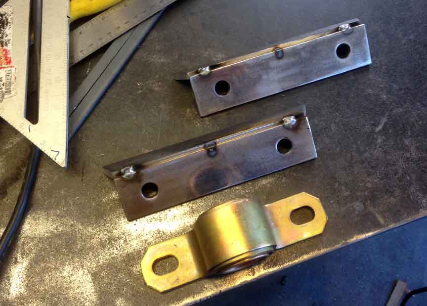

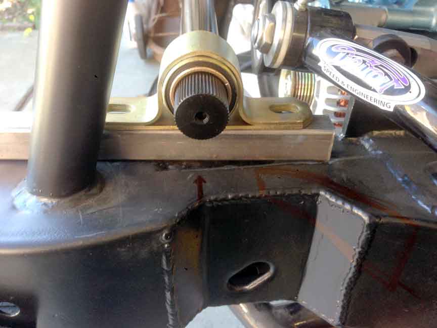

This weekend I'll sum up as a lot of lessons learned.
Lesson#1- metal still moves even after significant tack welding. Got my headers back from them being coated. and the driver side no longer fit. It fit beforehand. I thought I checked, thought I had pics, etc. I guess not. There are no other variables. It's either that, or the laws of physics are different in my garage. so I had to mod the header more and now I need to get it re coated. Money and time wasted
Lesson #2- Install the sway bar(s) before painting. I thought this would be a simple job I could quickly do later on. I was wrong. As seen in the pics this has turned into a bigger job. I also turned to help from Brett and Jeffrey over at Fab53 to help me with bending my sway bar arms. I don't have the equipment for heating up these big blocks of metal. I built a template and we used this to follow for bending the first arm, then bent the second arm to match the first. The results are really good, too. Thanks, guys! Now I just need to clean them up, make my end links, paint and I'm g2g. I spent the rest of this weekend building the perches for the sway bar pillow blocks. Next will be making the end links.

a couple more pics...

Your sway bar end plate pics are exactly what I've been looking for now that I'm contemplating making my own setup.. keep up the great work!

Looking good Brendon! That's a lot going on there to factor in for your mounts and arms. Great job!
