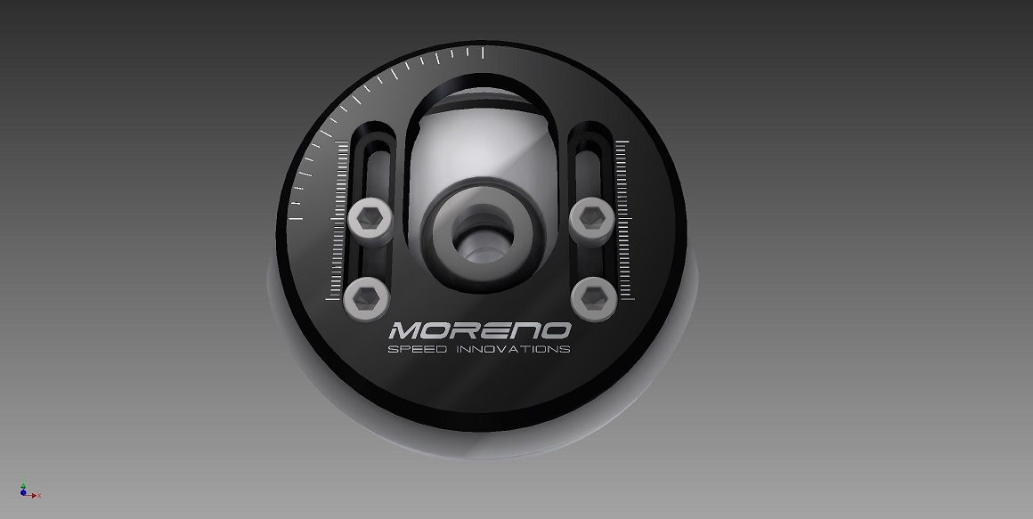

Thanks Vince, Justin is getting pretty dangerous with the 3D stuff. He is starting to design and bring into production his own suspension parts. He met last week with the machinist to get the prototype cut.
Name:  Camber plate assy.jpg

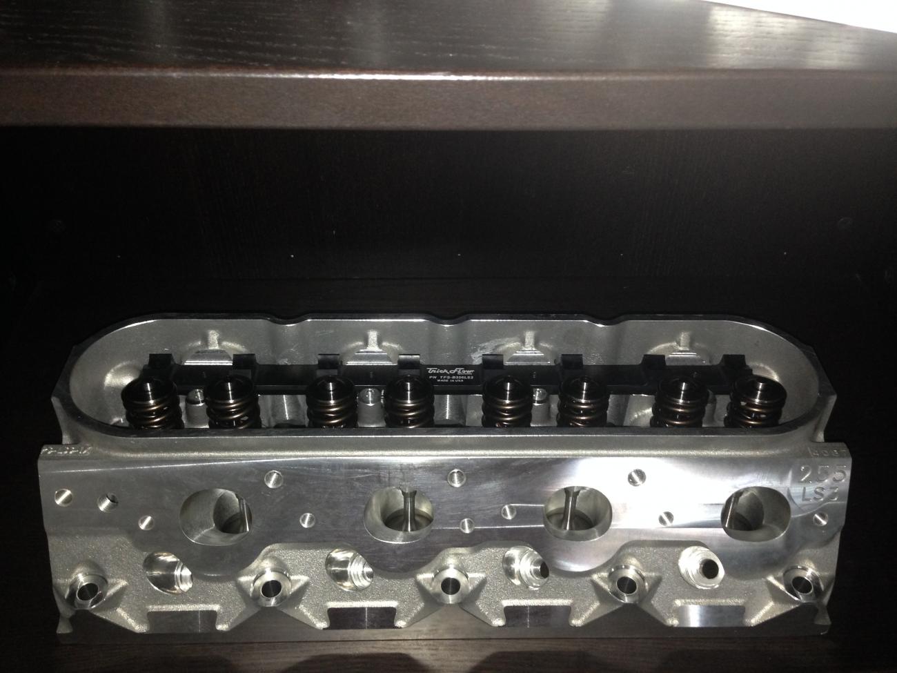

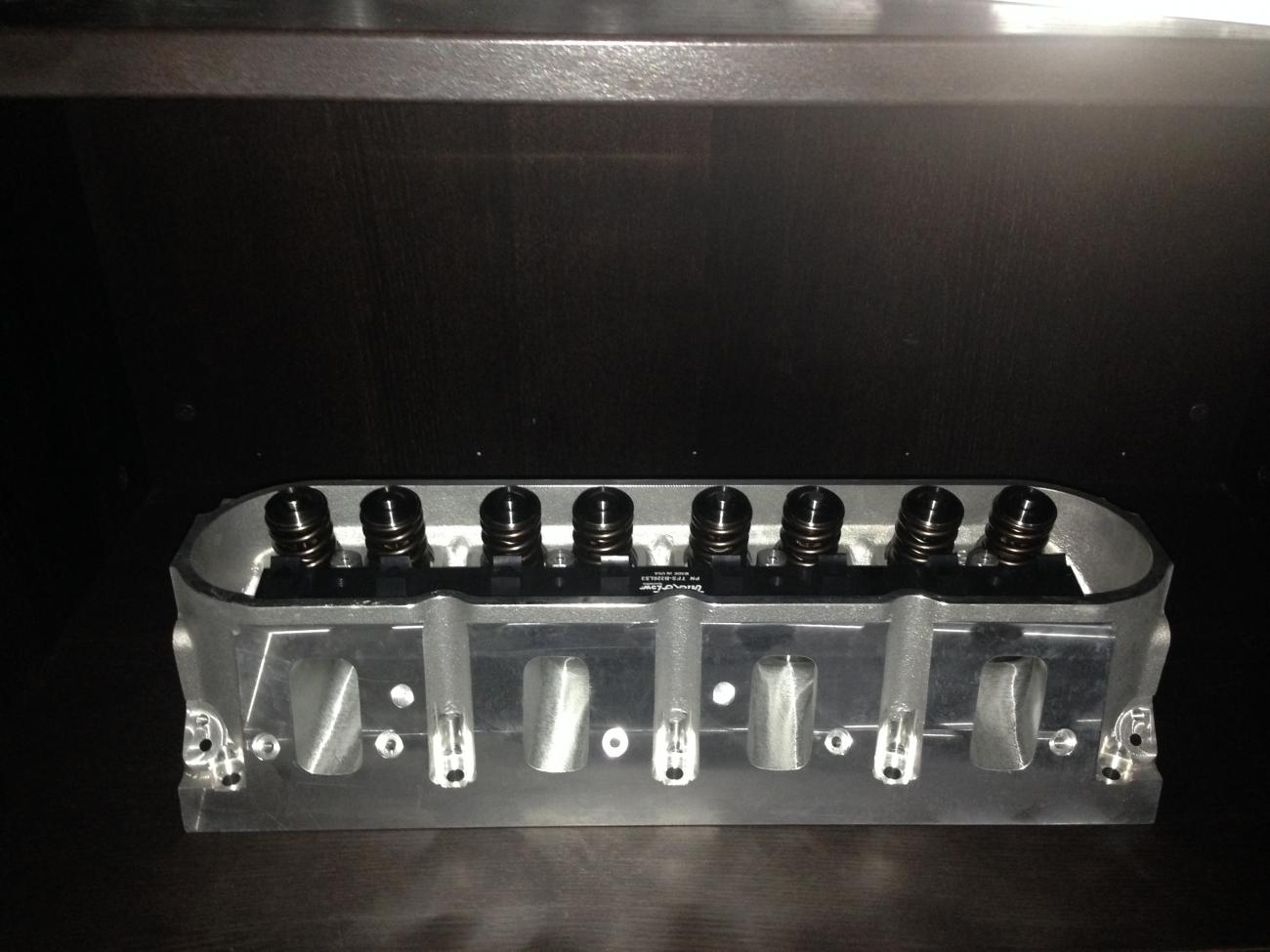

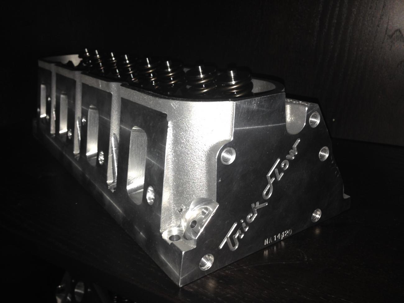

We were considering the MAST heads as part of the engine rebuild. After speaking with Patrick Guerra who spec the new road coarse inspired cam, he suggested if we were looking for a superior head, to look at the newer Trick Flow LS3 255. He said they have an LS7 chamber which moves the intake valve away from the chamber wall which reduces valve shrouding and improves hp a great deal.
I will be interesting to see were we end up power wise.
The only bad part is having to remove all the casting to make these smooth as it's a lot of work!
