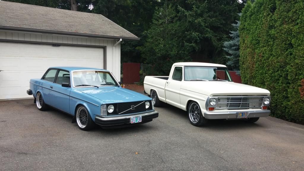

Got it home and off the trailer, my LS swapped 240 was in the driveway and I thought it was pretty cool so I snapped a quick photo...
