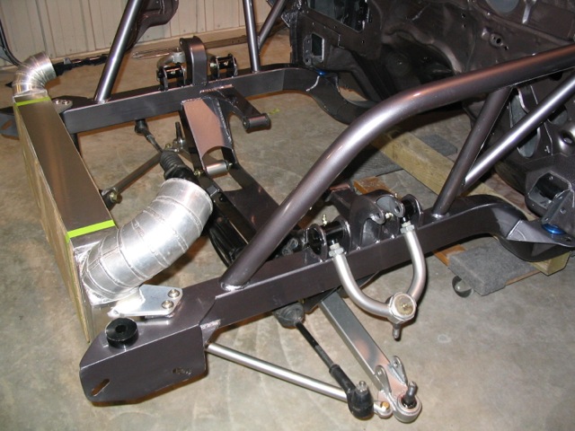

Whose subfr is that? The cutouts in the cross member, is that for weight savings or turbo clearance?

Front sub is Martz chassis. I think it's got to be one of the lightest ones out there? There really isn't much to it and since I had it from another build I figured I would use it. It does flex quite a lot during mock ups so we decided to tie the cage into it and it's solid now!!! Cutouts you see are going to be for the turbo crossover pipe as I wanted to try and run it under and through the frame so I can go around the a/c compressor.

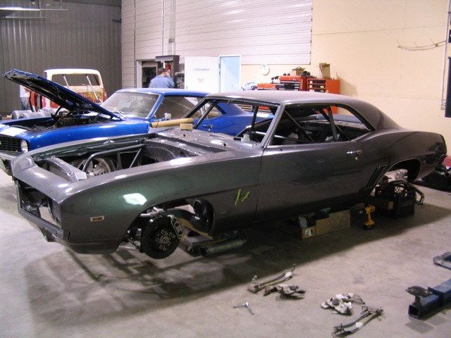

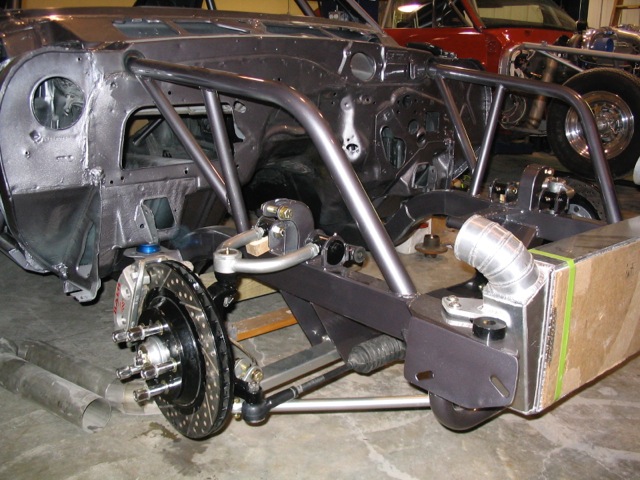

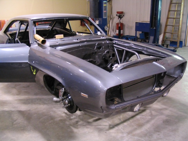

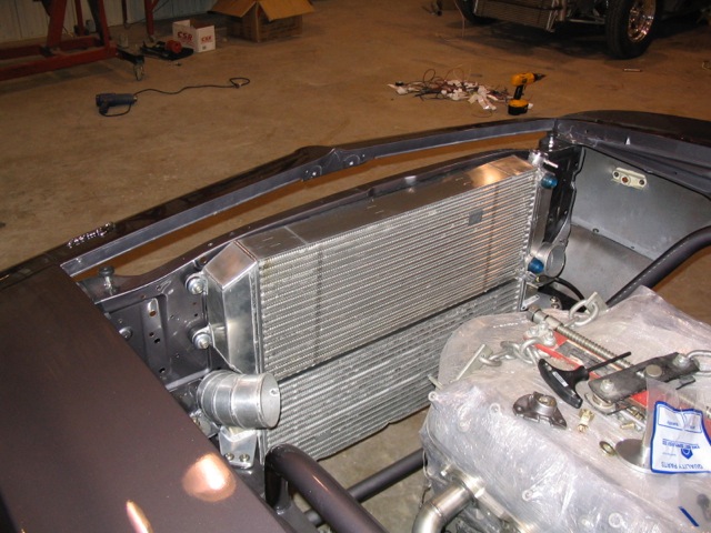

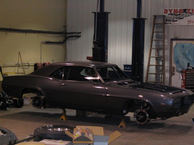

Ok back to putting up some pics! These pics show intercooler and rad finished and polished. Front suspension powder coated and going together with Baer track claw brakes. I jumped the gun putting the front sheet metal on since i still need to paint the backsides of the fenders. I still have a ton of work without fenders on to do but i just couldn't wait to see some more of the car together!

Have you checked your turning radius with a wheel on the front? Only reason I am asking is the strut rod looks way out there from the pics.
