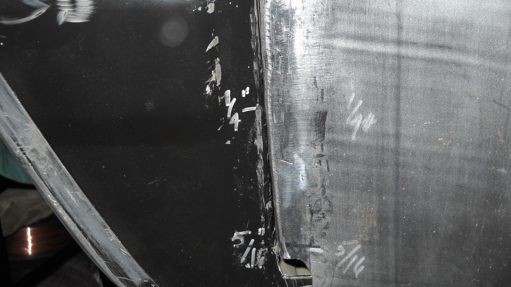

I started on the arms with maroon and WD40, seemed to get most of the grime off. The lowers are worst with grease and smuck all over them .....
What have I been doing? Cleaned up the upper and lower C5 arms, ordered all the Grade 8 hardware I need to bolt up the C5 on Mock's frame, replaced front disc pads on the GMC truck, replaced the clutch out on the XR650R ( friction discs were at the service limit), and started working on the SBC .... JEGS delivered yesterday. No sense wasting time, can't do anything til the Grade 8 hardware gets here .... work on the SBC!!!
Torqued the heads and PTV clearance (check), pushrod length (check), ...... where the heck is the rest of my ARP polylocks? Don't know, they just vanished, end of the night!!!
New friction and discs for the ol bike!
The SBC getting some work prior to installing!
Comp Cams 1.52 rockers set on #1.
Pretty good markings for push rod length 7.80
Piston to valve clearance .... plenty!
Can't wait to fire up these AFR's .... sweet!
I'll get back on the engine tomorrow, as soon as I find the dang polylocks ... or buy a new set, GRRRRRR.
Thanks for looking .....
