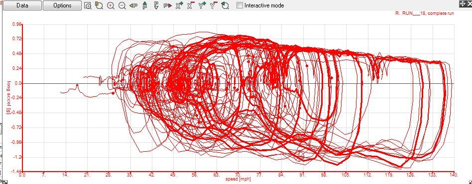

It is geeky engineer Friday. The graph below is the tractive effort curve from LVMS. Longitudinal acceleration vs vehicle speed.
The data shows I'm accelerating at about 0.85 G at 60 MPH and still pulling 0.6 G at 100 MPH. On the flip side I can generate 1.3 G decel at 120 MPH.
Just fun to look at the data.

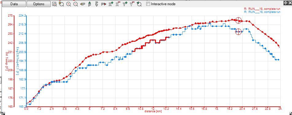

On the temperature side this is the data from my last run the air temp was 85 degrees F.
After 15 minutes the water was at around 220 F and the oil was around 270 F. To road race a 900 ish car and to keep it cool is tough. I'm very happy with the data.
Looking at the data the temps are becoming steady state and they will stabilize below peak excursion limits.
Once I get out of the throttle look how fast it cools!

Looking the data Hellfire lacks forward bite.
Looking at the data AWD would fix forward bite.
Need to add another dial on the dash........for traction management.

I came across this thread yesterday and haven't had the time to digest it all just yet (!) but some simple math tells me that a rear-engine design with something like a 40/60% F/R weight distribution might do wonders for forward acceleration. I know this is a huge transformation, but at the rate you're going, I might imagine you're not many iterations away from something even this bold. Assuming mu(s) is 1.4 from the braking data, then your attainment of 0.85(ish) g's long. accel. is right at the theoretical limit given your weight distribution and ignoring transient effects from anti-squat (I'm assuming WB is 108" and the COM height is 21".) Go 40/60%, and you could attain 1.15g's.
