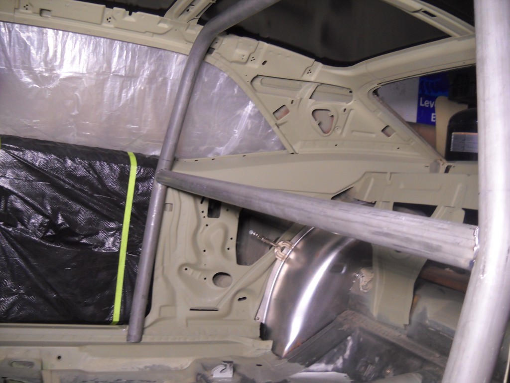

Good day in the garage .... Figure I'd start on the roll bar now that the connectors are welded in solid, got the drivers side pretty much done. Still need to bend the floor plates to match the rocker panel and put the kicker bars onto the connector, but that's easy.
I gave the roll bar a little angle to match the quarter window and to make it easy to weld the top joints with the roof off ... finally be able to weld on the roof after the quarters are on! I even installed the rear window to make sure it didn't hit, we're good.
Take a look ....
That's all, I'll work on the passenger side tomorrow and get the kickers mocked up and then add some heat ....
Thanks for looking .....

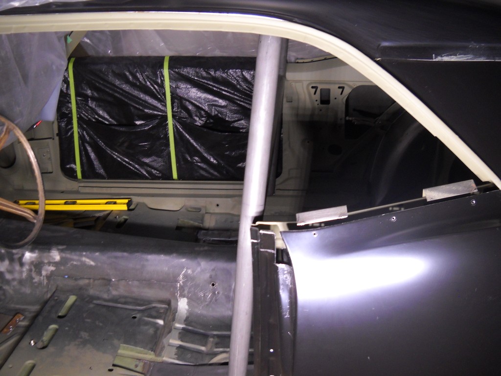

Here is some pixs, still need to fine tune the angle for the main hoop (85 degrees) and bend the plates for the floor.
Made some clamps to hold her in place!
Rear window is in place ... plenty of clearance!
Kickers tuned to fit the connectors!
Better view ... looking cool!
There's tomorrow for the rest (1) fine tune the trunk drops (2) bend all the plates to fit (3) get help to take off the roof so I don't taco the roof (4) start welding!!!!
This is time consuming to get it fit really nice, but it's paying off fer sure!
