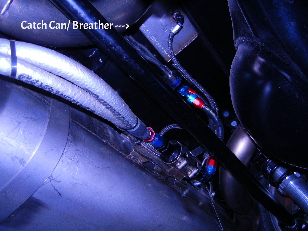

I am doing a bunch of upgrades & freshening this winter on my Camaro, and have now been able to fully see the plumbing of the evaporative system that was installed, I think by DSE when they installed the F.A.S.T. fuel injection system 4-5 years ago. (I bought the car last year), and am hoping some of those up on these things can help me figure out what to do with it.
The system...
There is a vent line going from the filler neck of the stainless tank to a small catch can under the trunk floor. Then a line from the catch can to the engine bay to a charcoal evap canister hidden under the fender. Then a line to the throttle body, drawing the fumes from the canister.
No valves to control the vacuum draw on the system. Pretty simple, but I just discovered a "T" in the vacuum line hiding under the brake vacuum booster, that can't be seen readily. So, there has been a 1/4" vacuum leak that the F.I. system has been compensating for all along! Also, it is drawing in unfiltered air, not a great idea.

Thanked 88 Times in 46 Posts
Originally Posted by cmraman View Post
look into a II Much fuel vent
There is already such a device, although not as attractive as the II Much piece. The hose you see is coming from the fuel tank. The picture doesn't show the hose coming out of the breather and going to the engine as described above.
It is the upstream part of the system I am puzzled by.
