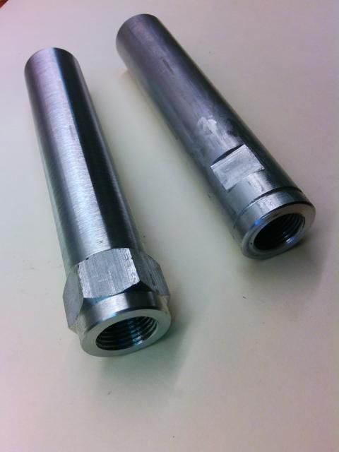

Continuing with the motor crossmember, I ended up adding a Shelby style lower control arm tie in bracket. The theory is it provides support to the front lower control arm mounting point.
I added an adjustable tie rod stud to correct bump steer which is standard for Mustangs, and mad worse when the car is lowered. The set up uses a shorter rod end in place of the stock longer outer tie rod. This requires a longer adjustable sleeve which is available, buy the cost is stupidly high. I made my own from 6061-T6, with left and right hand 11/16"-18 threads. I'm using the sleeve on the left as the first one I made, on the right, was a fail.
