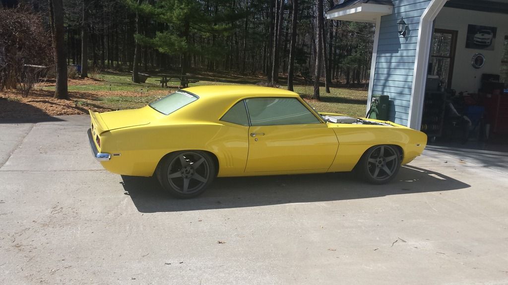

I was poking around last December looking of an "Economical" one piece wheel that would fit over a 394 mm ZR-1.
I saw Forgestars on a few cars and was checking them out. I called for info and I happen to call on the Black Friday sale. The normal price is still not bad but you get what you pay for. Finspeeds and Forgelines are works of art and these are OK for track wheels.

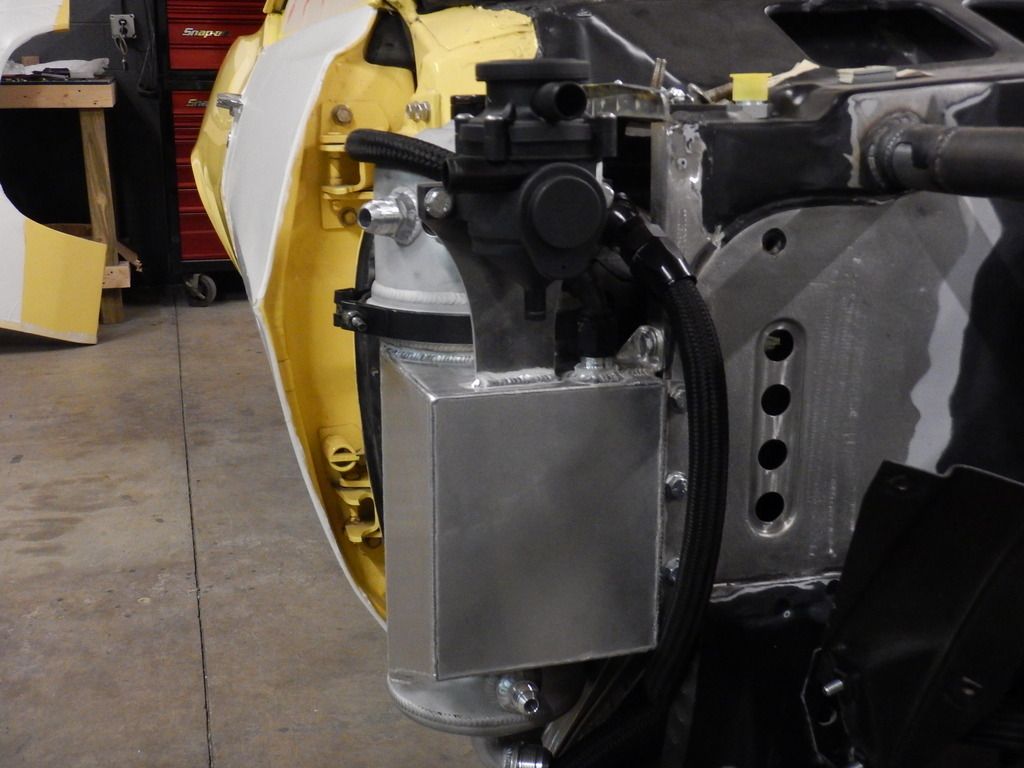

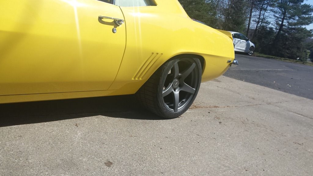

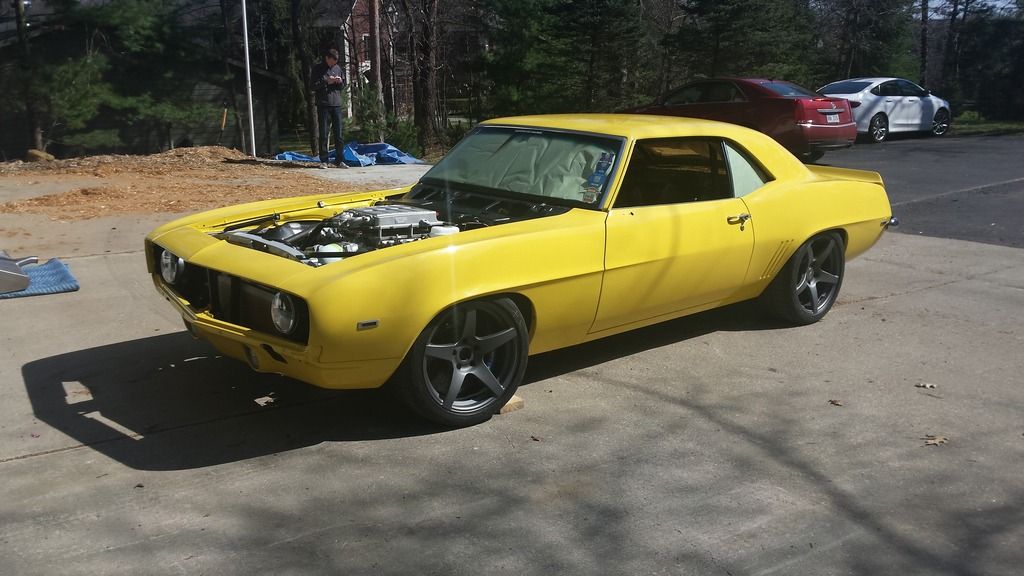

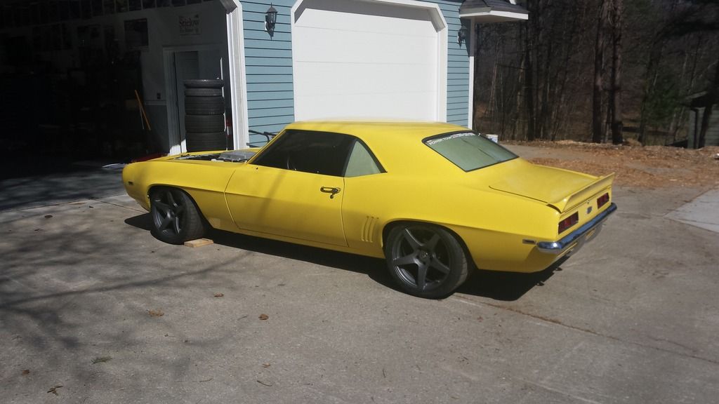

Originally Posted by Stielow View Post
I did 18 x 10 with a 20 mm offset on the front and the caliper has about 5 mm clearance toward the spoke side. It has about 4 mm clearance to the barrel. Not sure you can increase offset and still have them clear the ZR-1 calipers.
Thanks Mark I ordered a set for track wheels. With only 5mm I am glad I didn't just take others advice. Even Forgestar said standard fitment for ZR1 brakes are 18x10 +30 offset and 18x12 +50 offset which would hit the calipers.

thanks for the updates Mark. Your explanations of why you make the changes/modifications are great. It gives us insight to your way of thinking that can benefit all of us.
The wheels look great with the yellow on the car!

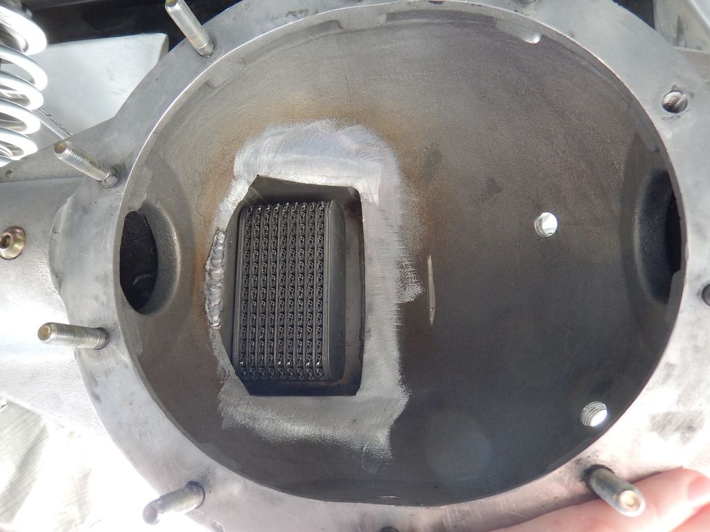

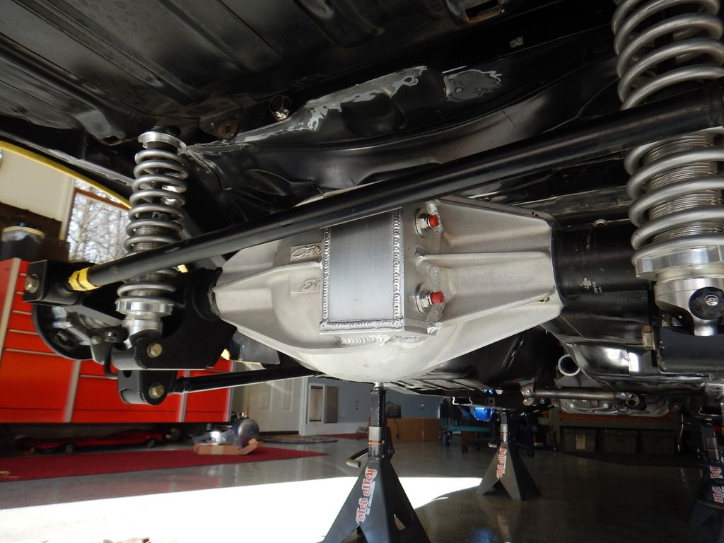

The new oil to oil diff cooler on in the center section.
The Camaro ZL-1 diff cooler
My axle ends that you can now buy from Detroit Speed
Mark

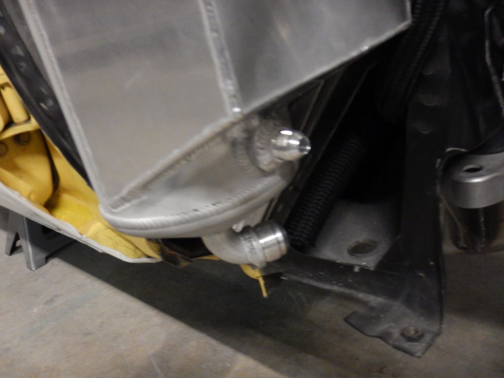

Are you planning a door like a gas door for access to the oil fill? Looking good as always, Mark.
  #750
Old 04-19-2015, 06:07 AM
Roberts68 Roberts68 is offline
Join Date: Jul 2008
Location: Middle of MN
Posts: 622
Thanked 2 Times in 1 Post
I'm not sure if this is the one and only access to it, or if you had seen it a few pages back.
Matt made the passenger inner wheel house two piece on JA to make it easy to get the dry sump tank hidden in the cowl area.
