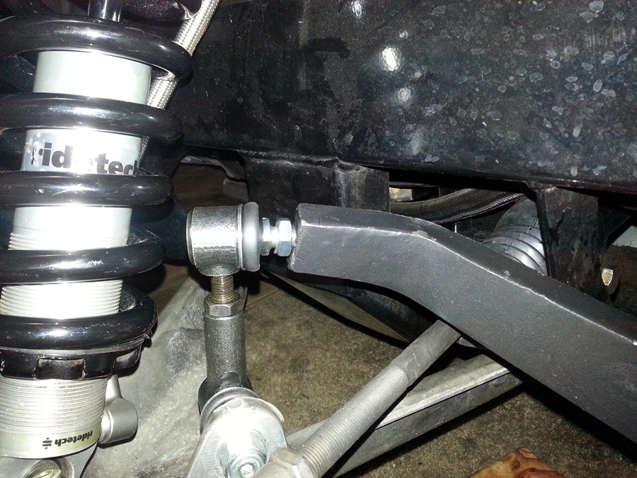

It's been a while since I updated so here it goes. After the Super Chevy Suspension Challenge I went about fixing some of the problems that were exposed namely the sway bar arm. I came off at the track causing some damage so out came the BFH and I used a Home Depot Map Gas torch to heat the arm up enopugh to bend. Not the easiest method but it was all I had. I got some threaded end links and lopped off the end of the arm, drilled it, tapped some threads, mocked it all up and it was good to go after some final adjustments.

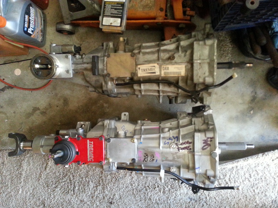

Since the car was in the air and I did not get a chance to install it before Super Chevy I took out the old T56 trans to install the Tremec Magnum T56. There are some differences in the Magnum vs the standard T56. The Magnum is just a bit bigger, heavier and most obvious is that the shifter is in a different position. so changes had to be made to the tunnel to accommodate the shifter location. After some measurements and a few cuts I made a access cover for the trans tunnel so that I could get the shifter out if needed down the road. I also relocated the stock center console a bit just to make the shifter look centered.

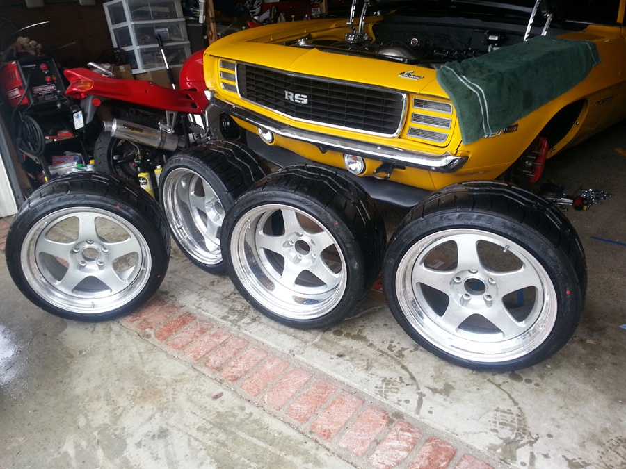

The next order was some new tires. I really like my HRE but I am running 18and 19 on those and tire selection is not good for what I am doing with the car. I was able to get some Falken 615k in 275-18 and 315-18. so I had a Fikse set of wheels fitted with these for the track use.
